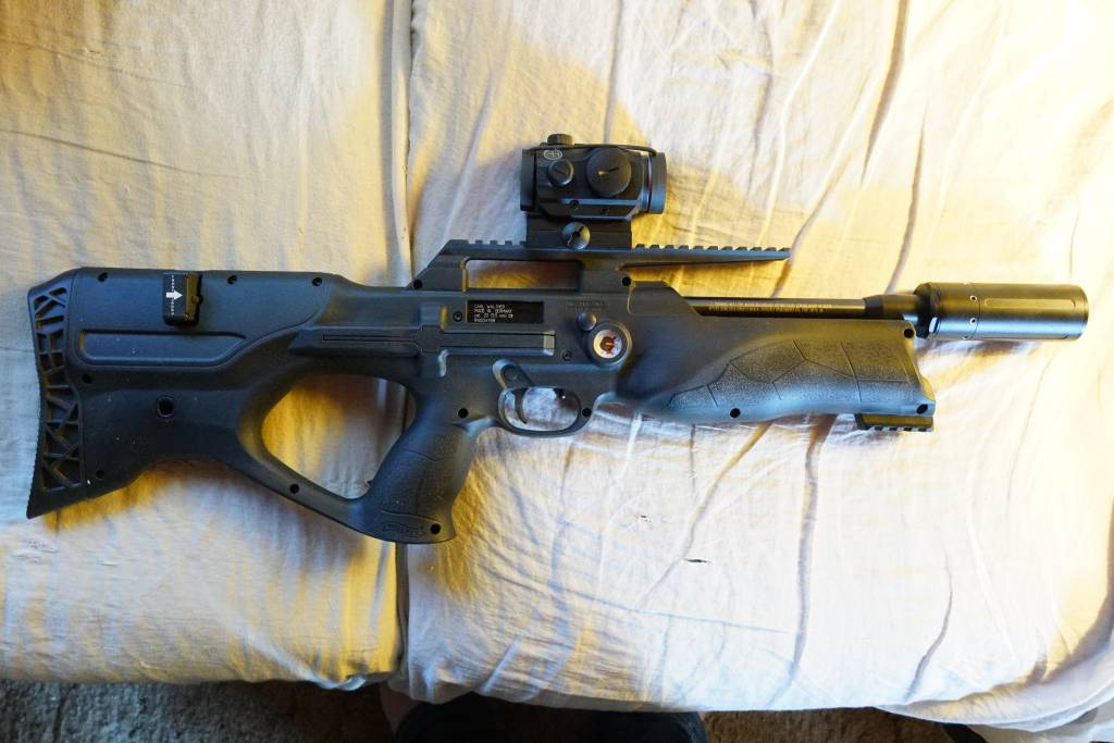

I've read where people have removed the stock suppressor without a lot of work. I tried to remove mine, carefully. After a LOT...of work, I got nowhere.
The easiest thing to do, is to hack saw off the barrel right behind the suppressor, then clean up the end to it is square to the bore, put a light chamfer in the end of the barrel, and buy a suppressor adapter, and use whatever you want. THEN...I got carried away and removed more barrel !
And yeah, for any neigh-sayers, if you are careful with a sharp file, you CAN square the end of the barrel with the bore..! I can hit bulls-eyes as good as I could with the original, before shortening gun.

So were you able to use the threads on the barrel? or did you hack them off and use something that just slips over the barrel and clamps to it?
NO...no threads on the barrel on the version that I bought (USA). This is why I bought the adapter. The barrel cutting took place after I realized that there were no threads anywhere.
Pressure and an embedded, round snap ring held the suppressor in place. The angled part at the back of the suppressor has had some sort of pressure applied to it. Either in heating of the angled part and cooling of the barrel for placement or a swaging action applied to tighten that part onto the barrel. It was very tight. No bonding, no threads.

That's a very sweet looking shorty you have. Specs state weighs 5.5 pounds is it correct?
