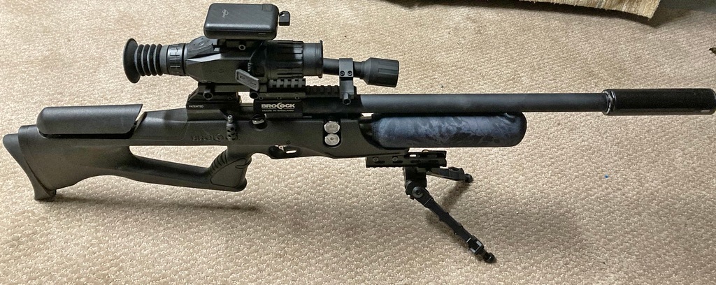

I own a Brocock Sniper .22, Akela .177 and a RWS Excalibre .22 all with moderators. ( Sumo).
I have been using my Brocock but wouldn't mind having something a little bit quieter.

Going by my cheap meter, With the brocock turned down to 20 lbs shooting JSB Jumbos, it is the quietest of the 3. The Akela shooting the .177 at full power is a couple Dbs louder. I don't mess with the power valve on the Akela as I had issues with that seal in the past.
