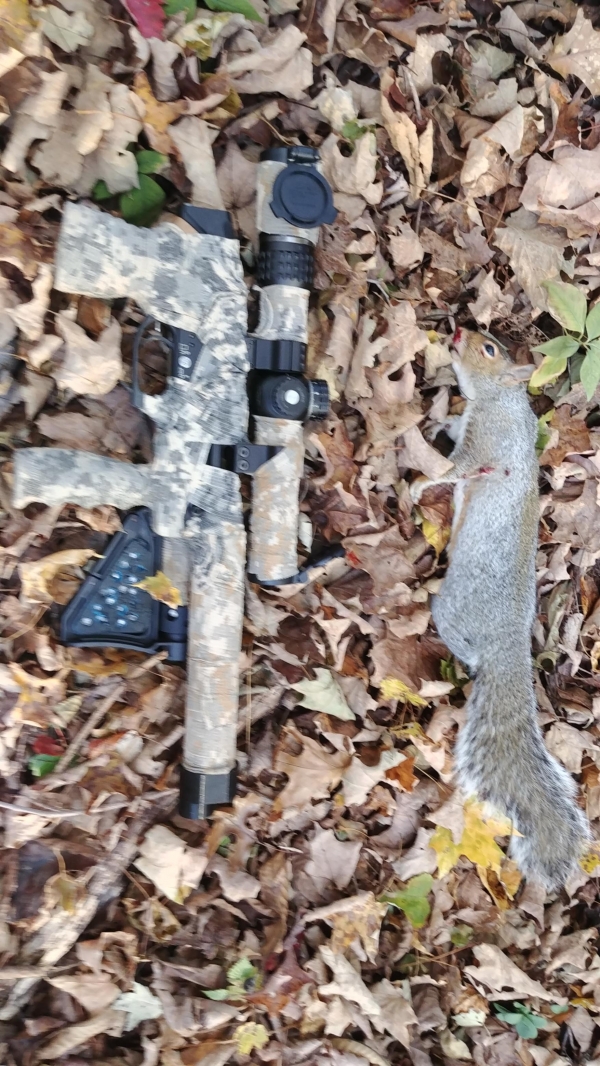

The Leshiy is a great gun to shoot and to own , I have one and it is one of my favorite , Their is a big difference to me with pcp guns and say powder burners , with concerning re zeroing , Every hunt or day of shooting I do re zero ,all of my pcp guns not just leshiy , as temp and conditions and even same ammo changes poi , this matters big time for hitting small targets far away , I own all of the ed guns and all are built like a tank .but they do cost alot of money It kills me to spend say $1500 on a pcp when can get a great powder burner for like less then 500 today , but I can also say the higher end pcp guns are like mini spiper guns now soo accurate , I am more accurate with my pcp guns then my 22 lr guns.
as far as durability I got about 20k threw mine 15k pllets an 5k slugs and not even a oring went bad . only a gage malfunction . I do not like pistols but to me the leshiy is a short rifle capeable of taking small game past 100 yards all day long and wont wear you out carrying it ,
On another note I also had a thompson contender years ago ,ha ,
There are way cheaper models for a short pcp but the leshiy is unique , they do make a model a bit longer the lelya 2.0 , I got this one too , when I saw it I said eww it looks like I would shoot my self in the hand , and say why would anyone want this , and when I got one I totally take back my remarks of critizizing it , these short guns are great when you have a phyisical problem like me , I used to lug around some heavy weapons up to 29 pounds when I was in my prime ,
after being beat up , poisoned shot and got rods in my back , and fake hip , I appreciate walking with a 4.5 pound gun I can take out a suuirrel or crow out with , and best thing it is quiet as a mouse , n one knows I use it in my yard in 22 caliber I dont know about other calibrs LOU
what state u live in ,? f u near me u can try it
