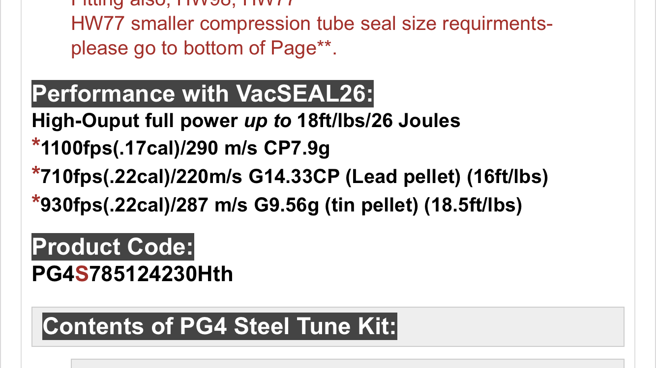

I apologize if this has already been discussed. The Vortek website says that this HW97 HO kit will put out 1100 fps with 7.9 grain pellets. Is this a misprint or is this kit better suited for the bigger calibers? Does anyone have this kit installed in .177 and if so how is the performance and firing cycle?

Will depend greatly on the pellet you use and even going up a mid-weight .177 pellet you should be well below 1100 fps. Also, the spring is an open coil design so cutting one or more coil(s) is easy to do to get to a lower velocity (if you want). If I recall my HW97 with Vortek kit and 7.9gr pellets produced about 980 fps and was very accurate to FT max distance 55 yards.

I'm re-looking at this and that has to be a typo. Theres no way you're getting over 21ftlbs out of a .177 97K (or even a .22 for that matter) which is what a 7.9gr at 1100fps would be. He actually claimed 18fpe right about that which still seems high but it would be closer to 1000fps with a 7.9gr.

I can give you some numbers in a HW77K with the PG4 HO and his vac seal
Using the 10.34 jsb averaged 813 fps @ 15.12 fpe
That was with no washers, and the kit comes with 2, so it would be a considerable jump adding washers
I can tell you it was Not pleasant to shoot, the shot cycle was a small improvement over stock and the twang was a tad less, but the recoil was substantial.
These were my personal results, of course others may vary.....

I also found the HO kit to be over-powered in my hw97k. Went to an ARH 12fpe spring and the shot cycle is a lot more pleasant with great accuracy.

My 177 97 with a PG3 HO kit was making 15 fpe. IIRC correctly i cut a coil and it shoots FTTs 8.64 at 860 for about 14 fpe. JSB 8.44s make a about 14.5 fpe. The gun will shoot dimes sized groups at 50 yards.
More recently I put an uncut HO PG4 kit in a 22 caliber Hw97 it made about 16 fpe with 14.66 FTTs.
The most power I've heard of from a Vortek kitted 97 with lead pellets was about 17.4 fpe. I suspect that gun was dieseling badly.
The 97 and 95 have the same bore and stroke (within 1mm). The kits use the same spring. 31.5 coil 0.785" I've done several of these. Usually start off a little over 15 fpe in 177 and a little over 16 fpe in 22. They settle down a tick after a few thousand shots.
My .177 HW97K was about 15 fpe with a PG4 HO kit installed originally...now it's settled in to a little over 14 fpe. JSB 10.34=785 fps and H&N FTT 8.64=860 fps...If I were to do it over again I think I would go 12-13 fpe in .177 as I feel the smaller caliber doesn't efficiently transfer spring energy into projectile energy above about 12 fpe...
