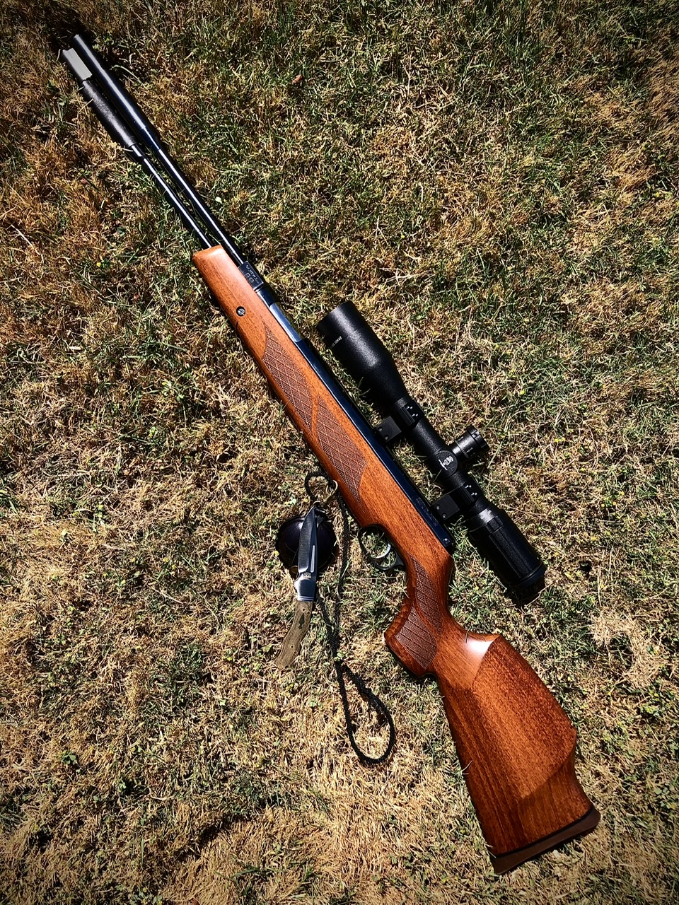

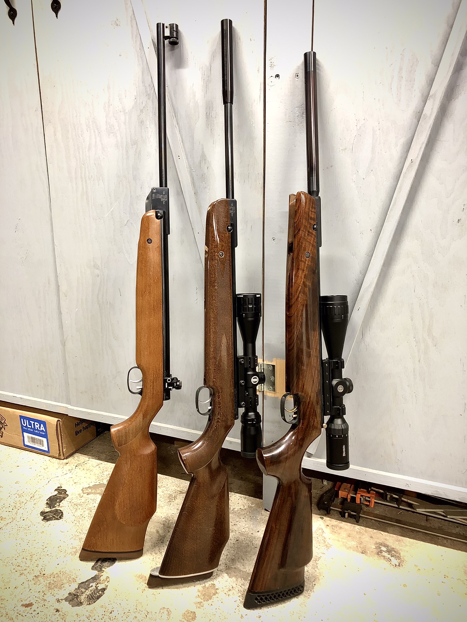

I read that you bought the 97 but I wanted to show my three 95/R9s off. I'll throw in a picture of my 97 too 😎

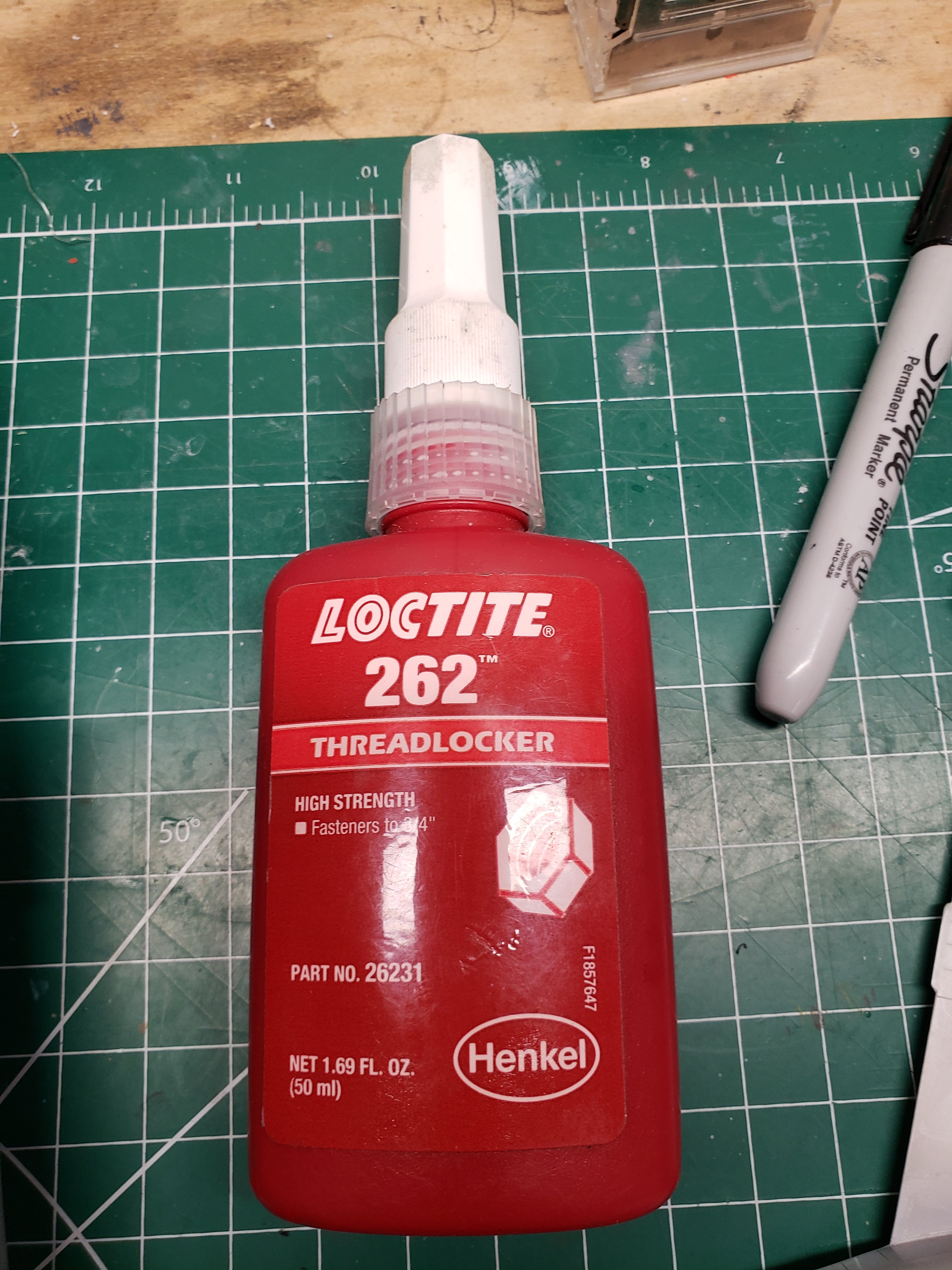

I bought a new 96 black line and an HW50s this year. The screws almost immediately came out of the 50, but so far not the 97 after a couple hundred pellet. I'm guessing it has to do with who tightened them in the factory.
It's more likely that your 97 black line is a synthetic stock. Your Hw50 is a wood stock. Wood is more compressible and changes with humidity and temperature. It's the swelling, contraction and pressure compressing that changes the pressure on the screw heads and allows them to vibrate loose. Good synthetic stocks are more dimensionally stable so the screws stay put longer. The 97 synthetic is a good stock.
A dab of 262 red locktite on the the first five threads of a cleaned and dried screw will stay put on an Weihrauch. Make sure you clean the receiving threads as well. Not much adheres to an oily surface.
Reactions: Betohunter
It's more likely that you 97 black line is a synthetic stock. Your Hw50 is a wood stock. Wood is more compressible and changes with humidity and temperature. It's the swelling, contraction and pressure compressing that changes the pressure on the screw heads and allows them to vibrate loose. Good synthetic stocks are more dimensionally stable so the screws stay put longer. The 97 synthetic is a good stock.
You're quick. I corrected that typo immediately or so I thought 🤔. Anyway he has a black line also
Maybe with loctite blue is more than enough i think, well the rifle is new still in break in period, with a lubed and a drop of loctite everything ok.
