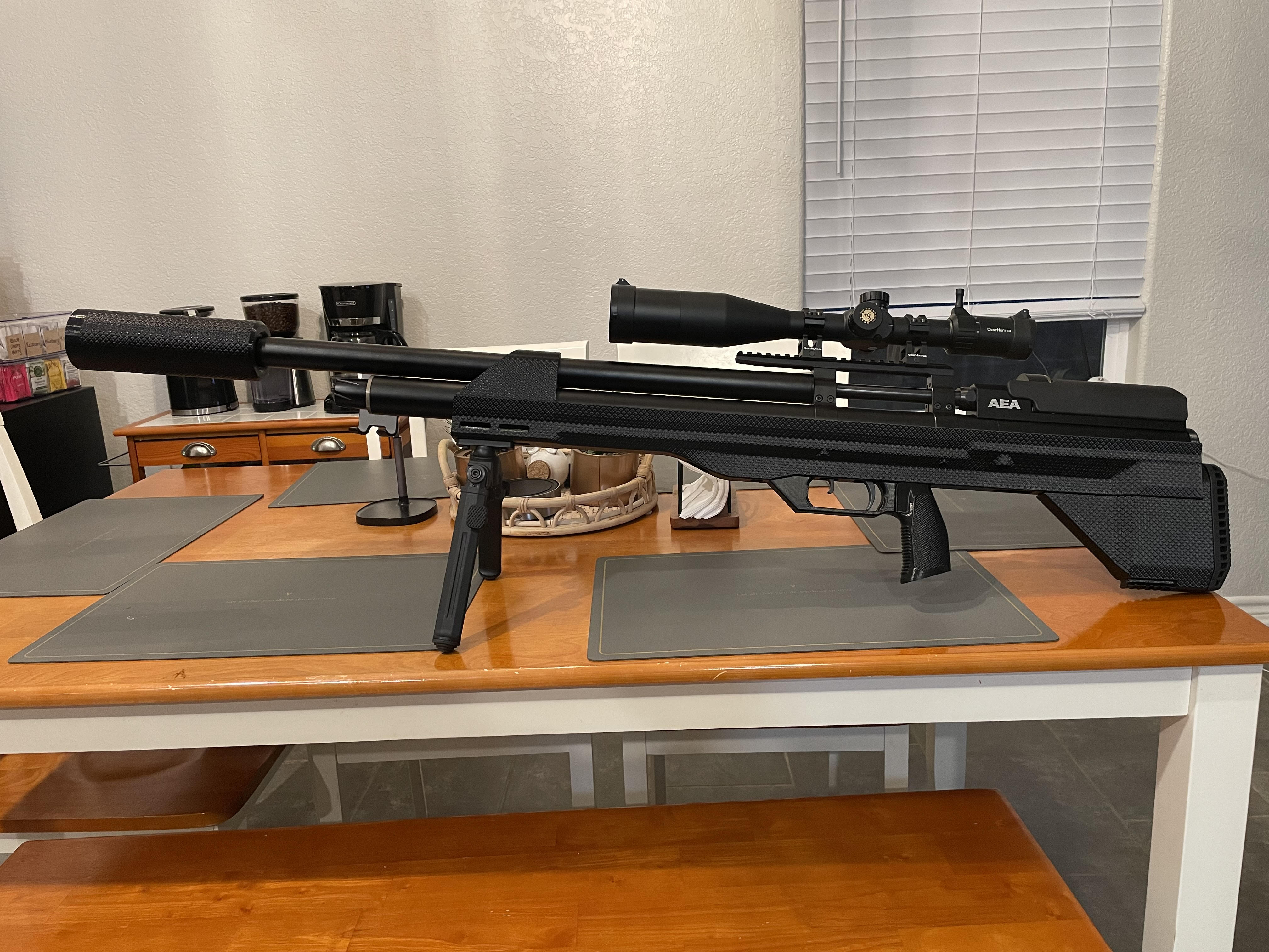

Here is mine, I make a custom stock for it and it takes over a pound off the gun! I think the biggest downside to this gun is its heavy weight. If you are going deep into the woods and going to be carrying this, its going to get tiring pretty quick and you'll want to wear it on your back.
