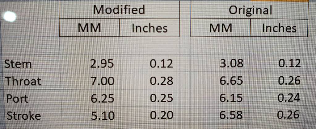

Dear Scott,
My valve specs are as under. These are for original valve and a modified valve.
Please advise if I need to change the specs for high power and good efficiency?
 The modified is still made of Delrin poppet while I want to replace it with peek poppet.
The modified delrin is still more efficient than original without compromise on power.

Honestly have no idea ...
IS HAMMER hitting back of valve ?
How heavy is the poppet spring to original ? or is it the same spring ? ( valve dwell can be tuned here as well )
Within the receiver between the Valve assembly and barrel, is the passage OVER SIZE to the port size of valve and barrel ? Placing a fitted donut shape ring in there can reduce wasted transfer area.
It goes on & on in such detail .... We simply can't be a fly on the wall or step by step assist you. Without sounding sarcastic, you need to do some trial & error testing and FIGURE IT OUT or leave it alone and just shoot it !!
Reactions: mubhaur
