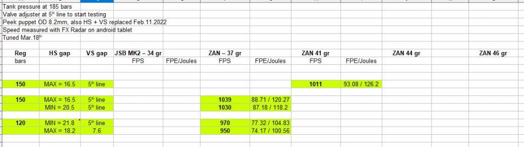

First I must say "the speed is not your friend" but that is fine, you just want to see what is a max your gun can deliver.
And to get you higher numbers that will cost you $$$ + time to play + some internal machining + $$$ to find a best liner and slug match.
Are you ready to go that way?
It toke me two winters = best way to tinker over winter with my MK2 same .25 cal, also filled my drawers with spare parts nobody else in the world may have no FI what those are for ;)
These numbers are only to get into ballpark with .25. Also I must say to you if you go this way no going back to pellets...the power and speed not compatible.
{btw, I am tethering at 185 bars so you can take it is a first reg is @ 185 and the second reg was at 150 and ended up at 120}
