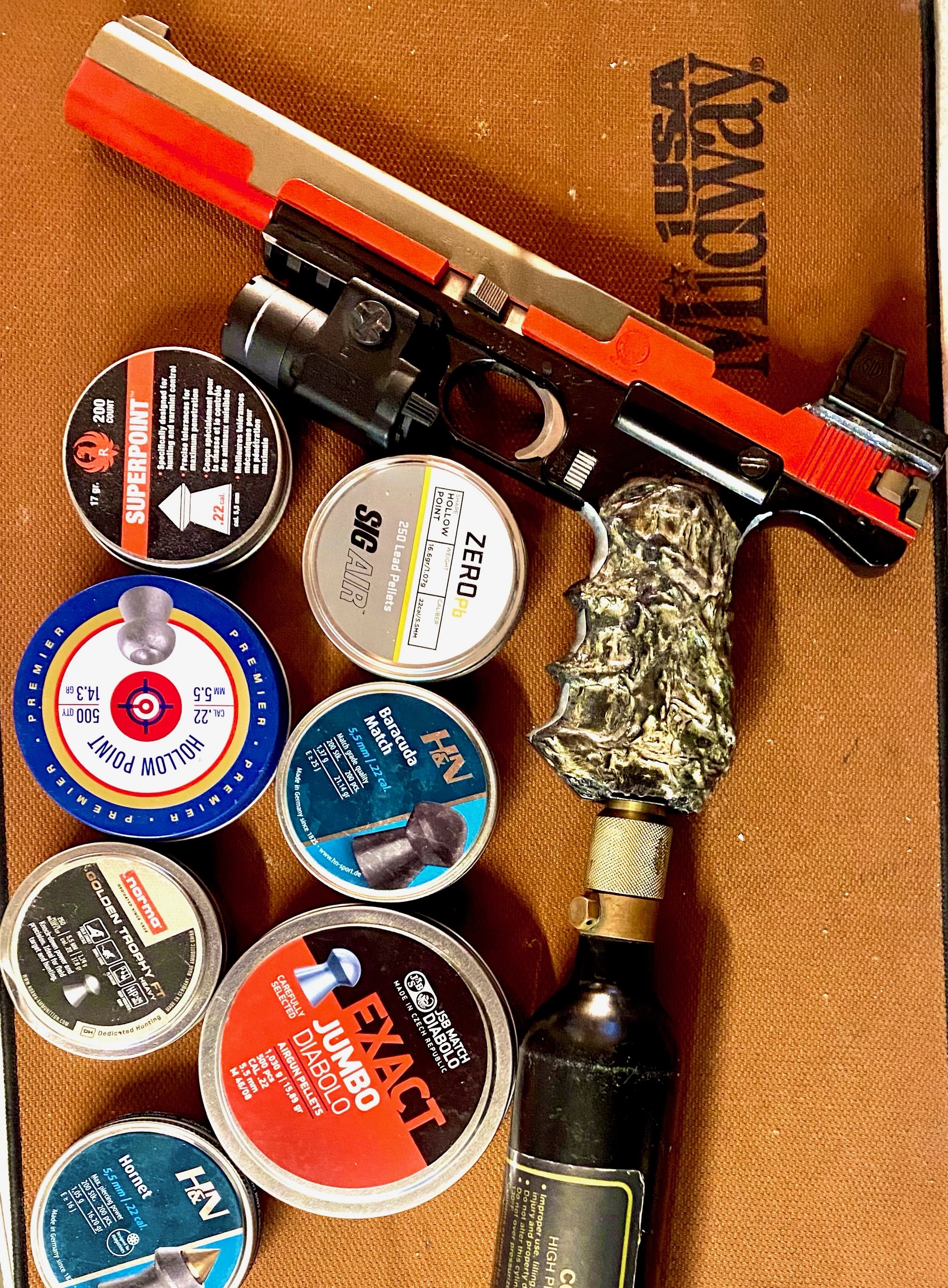

My latest build has folks divided, some say its heresy, some say I ruined me a classic pistola three weeks dungeon! While the other camp thinks she a nintendo light gun lookin exotic debutant, that mollywops steel critters in unlimited standing pistol silhouette and field target. Her name is Dizzy, from Starship Troopers if you know, you know. I sniped her off Ebay for 50ish American doll hairs. Her soft parts were plum blowed out the frame, no grips or piercing cap, she was flicted by the orange gremlins what eats metal, science says it aint that but MAMA says theys wicky voodoo.
Back when MAC1 had the interwebs store before the big bike wreck laid ol Tim down, I ordered a whole mess of valves and lil bits n bobbits. I cured her of her innard ailments and wuz smittened by her sturdy build and she got a telemetry on that trigger musta come straight oughta NASA, put me a good hone and shine on them bang switch units. Thats when my superpower flipped on, i gots the ADHD, OCD and the look at me. The Marine Corps dun shuffled my deck a lil bit more but we still got her pined full throttle missin on 3 cylinders and rich on the other five, can i get an amen?
I digress, this ain't about me. Its about my girl Dizzy. I milled out the rear sight lug and guides, pinned me a loose optics plate to the receiver for a spare zero elite. Fanged a pic rails ass off to mount a light, pinned with brass rivets I wopped up just right with tender mallet strokes while I held her hand, shes so brave. Hit the seam with e6000 and again with JB. I got choked walther barrel stock I gantry fanged it to stock specs just left 2mm more rifling in the chamber for bentz style engagement, then decided to yeet an extra 1mm into the port, got the bolt reshaped and shiny. Turned down a new transfer port to match, punched the valve port 1mm made it shine. Popped the valve out and set to rotary burr fangin material out, I reckon i got .7-.9 worth of her guts trimmed out tapering in the direction of her gassy colon as it were.
I then set to using clay polishing compounds and units i made called alien fingers to mush my shine gunk around when i port and polish automotive unitry. I got a mess of springs I tuned with yesternight had to negotiate with my terrorist chrony thinks hes wore out, but aint allowed to die right now.
I want to run c02 with the hammer spring tension back all the way off diabolo 14.3g at 500fps and tension maxed on HPA regulated at 1000psi 16g diabolo at 600+fps and im going to test hybrid slugs maybe even cut another barrel 14-16 inches.

I admire several features on this resto-mod. The low profile Colt 1903 style grips are pretty cool, I bet the surface texture is pretty grippy. The red dot mount is very nice looking as the SW78 is a pain to mount a dot sight on. The two-tone cerakote on the slide looks well executed. OP, I'd like to see pics of the transfer port if you had any.
