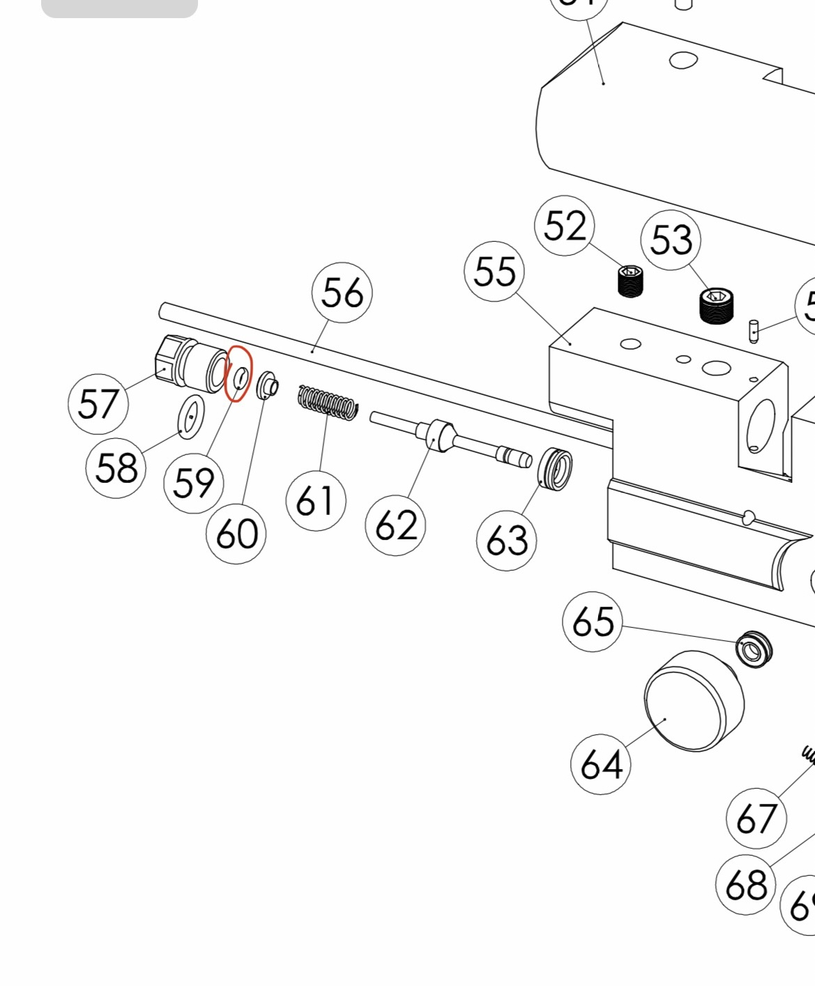

Another thread indicated the culprit may be this O-ring:
So I tore my rifle down to check, but that O-ring is in pristine condition. So that's not it.
