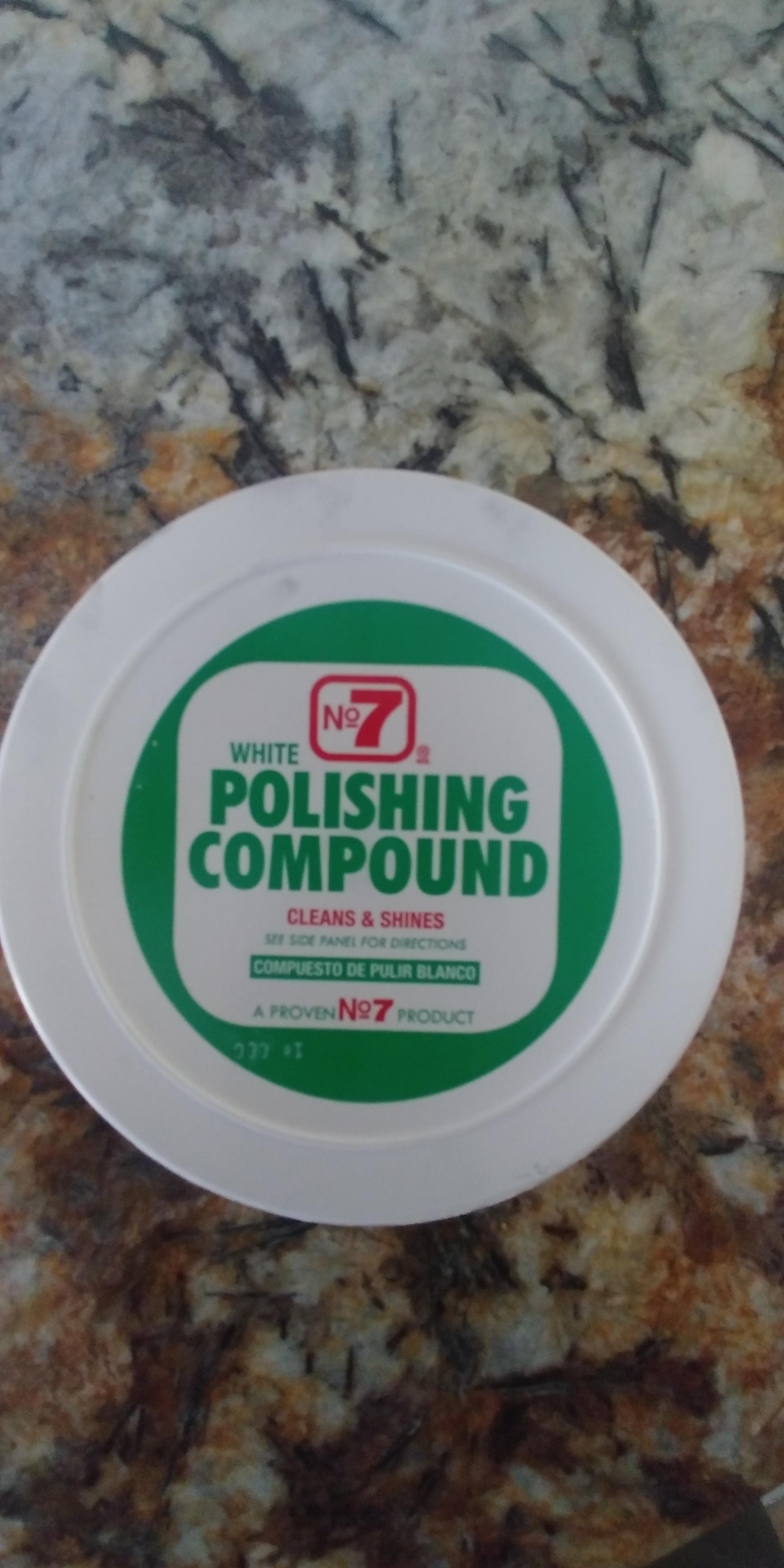

I was shooting some long shot strings with my Wildcat Mk1 .22 and Streamline .22 after polishing the bore's, I used #7 polishing compound from Ace Hardware for car paint, results appear to be excellent so far. Both guns had been shot some
