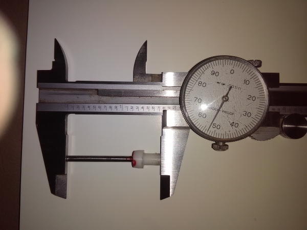

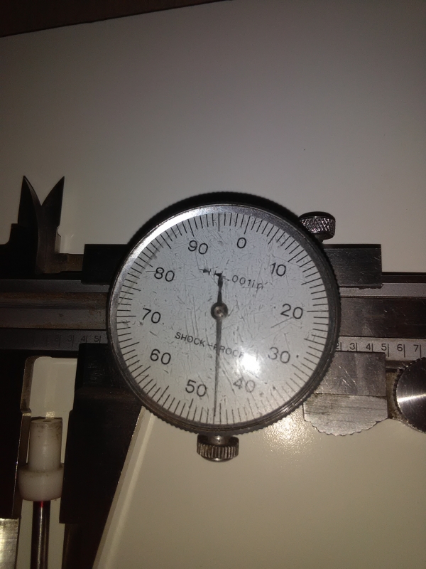

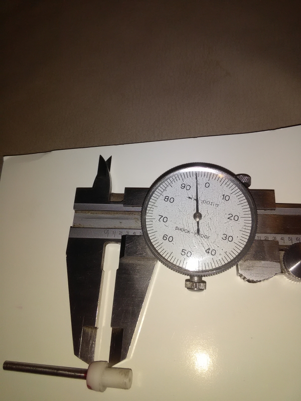

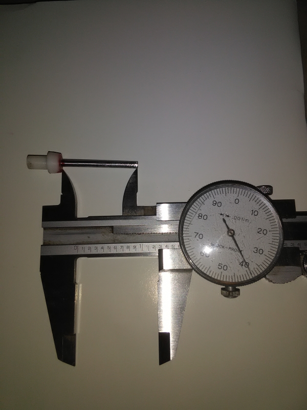

I don't have the dimensions of an Mrod poppet to compare so I took some measurements and pictures. If anyone can measure an Mrod poppet and see if it will fit or if anyone can make one (or two) I'll appreciated it. Thanks in advance.
OAL= 1.753"
Rod dia = 0.117"
Rod length = 1.239"
Head dia = 0.346"
