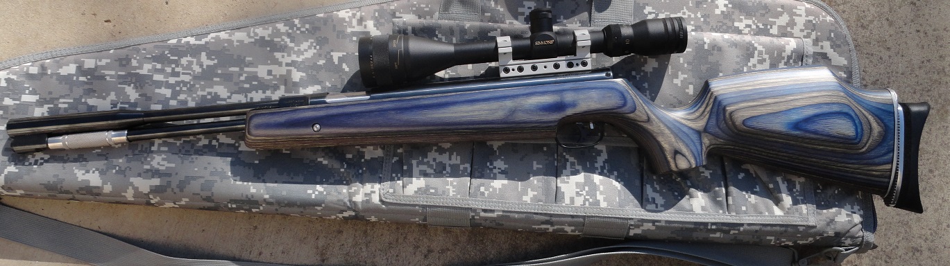

You're not going to go wrong either way. I've had the 77/97 TX200 in .177 and .22 calibers. Of all of them, I ended up keeping the 97LK in .177. It just shot better for me and I was consistently more accurate with it.

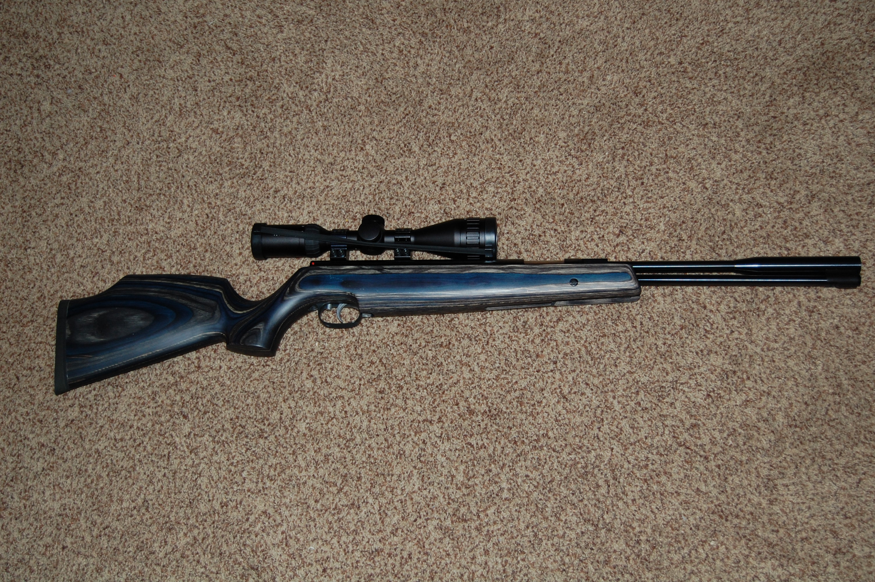

What year is that 97LK in .177 ... looks similar to mine and in the same caliber. My personal preference is the HW97 out of owning a few (never got the pro-sport), like the look and the order of operation better than the AA TXs.
Not entirely sure of the year, but got it the same year they introduced the LK so it's been a while now. This one has always been a tack driver for me.
Maybe I'm wrong, but when I picked mine up from AoA pre-owned last year, research said 2005 - 2010. That's what is rattling around in my head anyways.
