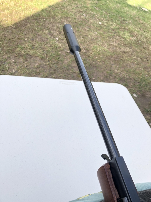

I personally have them on my LGVs and my HW30. To me the sound suppression is both noticeable and worth it. Your mileage may vary, but you’ll never know until you try it or see if someone has a gun you can try with and without. It also gives the gun a nice look and aids in cocking.

@ INTENSEATY- in that pic of your barrel with the moderator, close to the barrel and breech connection I see this black paddle lever looking thing. What is that?
Sure thing BR, that is the Lockup Release Lever, not sure if that's the proper name, but that's what it is. The LGV, being a breakbarrel has a positive lockup system that brings it very close to a fixed barrel's consistency. You can't simply "slap" the barrel and break it, you must depress the paddle and then break the barrel. It's one of the features that drew me to this platform, you load your pellet just like any breakbarrel without worrying about the "pellet window" or getting your fingers crushed or even the ratcheting noise of the anti bear trap.
Ok, then, thank you. Nice feature to have, for sure

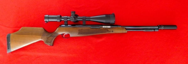

Is it worth it... Well, I tuned my AA TX200 HC with a Tinbum delrin tuning set (reduces metal-on-metal noise), polished all it's internals to a mirror shine finish, and fitted it with a Huggett silencer. And believe me, this .22 FAC rifle has become extremely quiet. I also own a HW77 that hasn't been tuned internally, and this one does produce way more noise than my TX200. So it all depends on, and how you tune your rifle IMHO. In my experience it is the sum of all work you put in it. And in the case of my TX200, it was well worth it.
