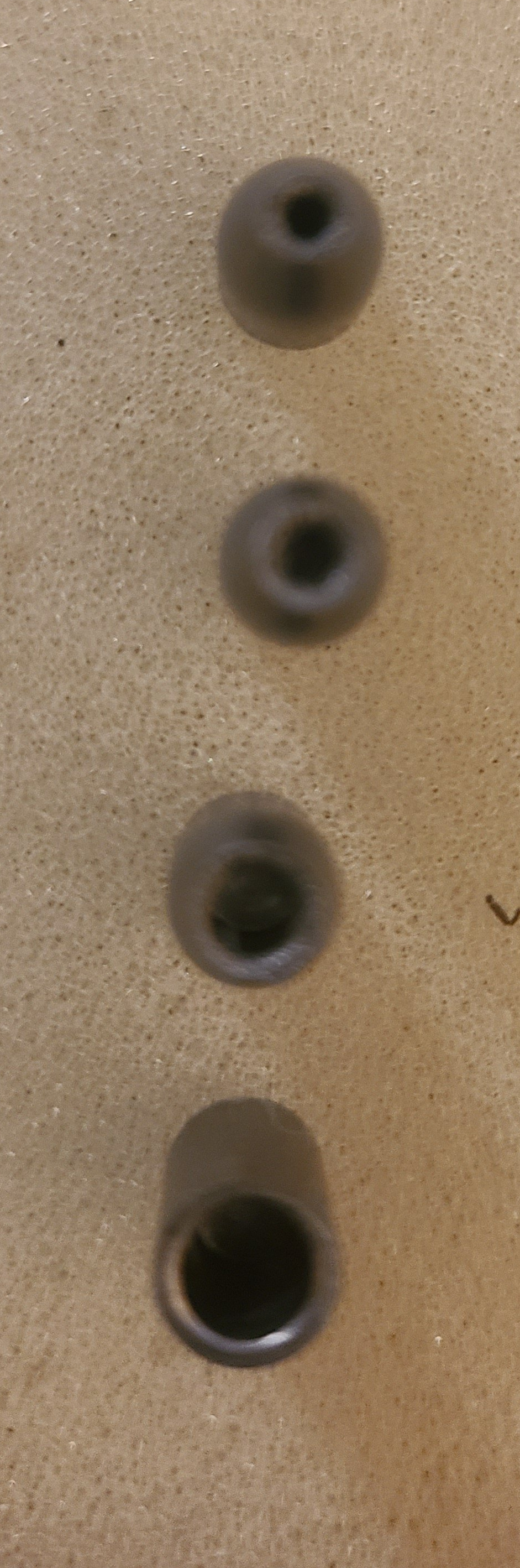

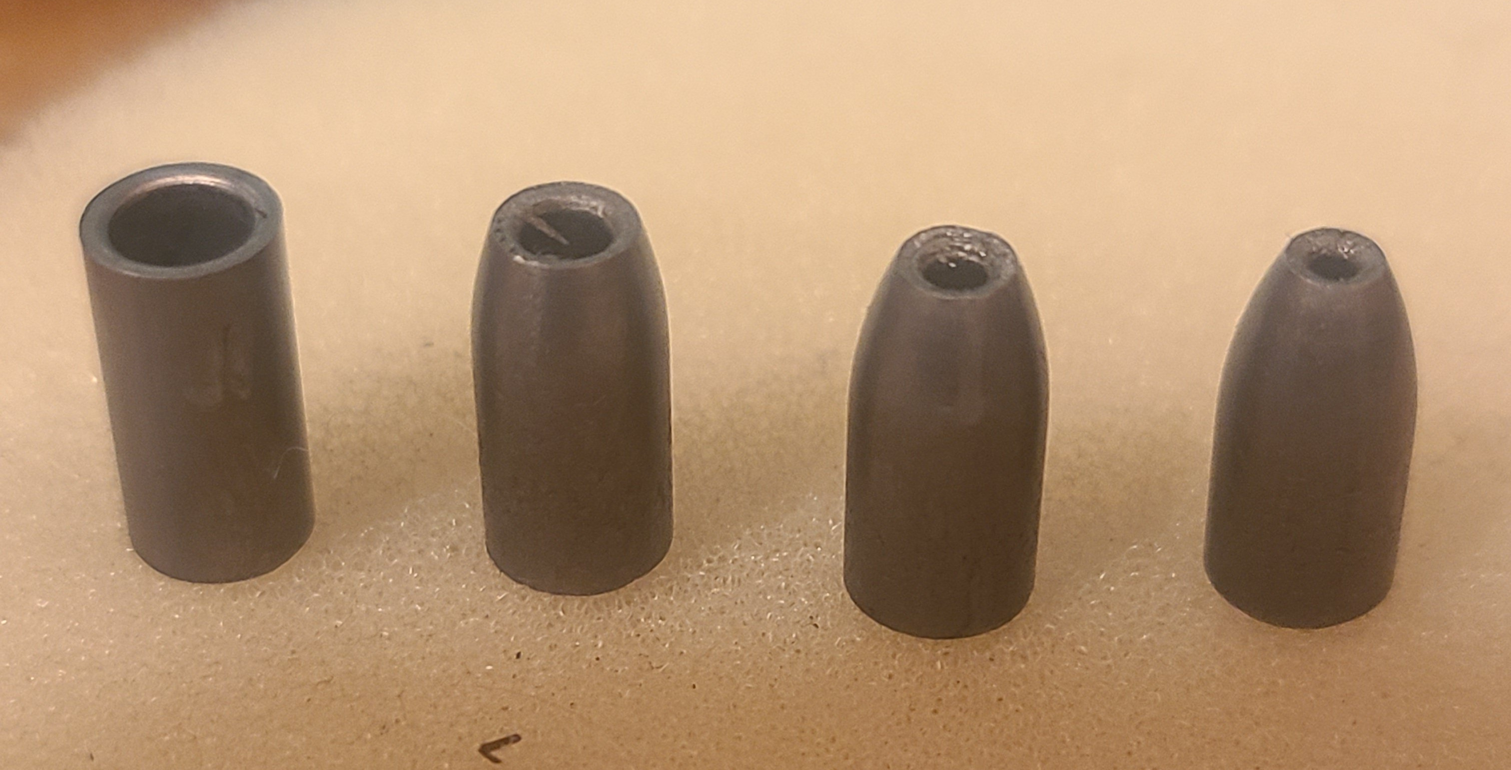

@JungleShooter I'm not familiar with the FX Halo slugs. The guy in the linked video at the end of this post appears to be making something similar to what's pictured in the photos below. I'd hope that there is a more methodical method of making them. His method looks time consuming, but one may be able to make a 100 or so within an hour once they get the procedure down pat. Maybe more. At least I'd hope that this is possible. And I don't know why he uses the word "swedging" when all of Dave Corbin's literature (that I've read) says "swage." He even writes the pronunciation and words that sound similar.
I would be interested in buying slugs that have an XXL hollow point — almost totally open, just a bit of crimping to form a slight ogive.
Once we figure out the right size, I'd buy bulk .30cal and .22cal.
Matthias
A shape between the far left slug and the next one to the right (ogive about 88%):
A shape between the bottom slug and the next one above it (ogive about 88%):
