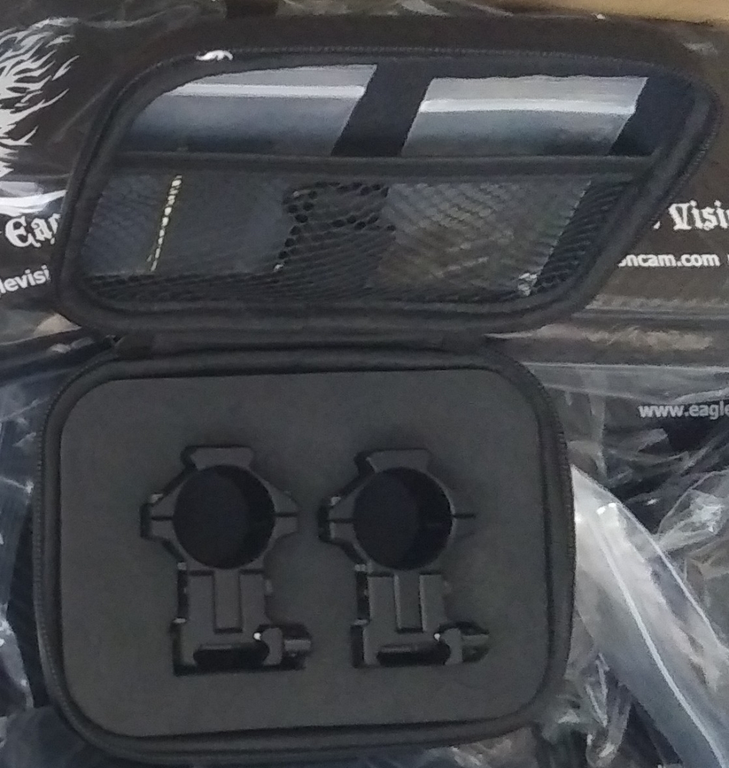

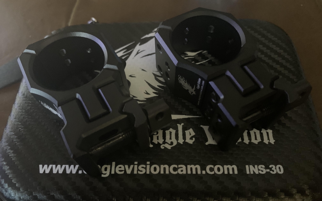

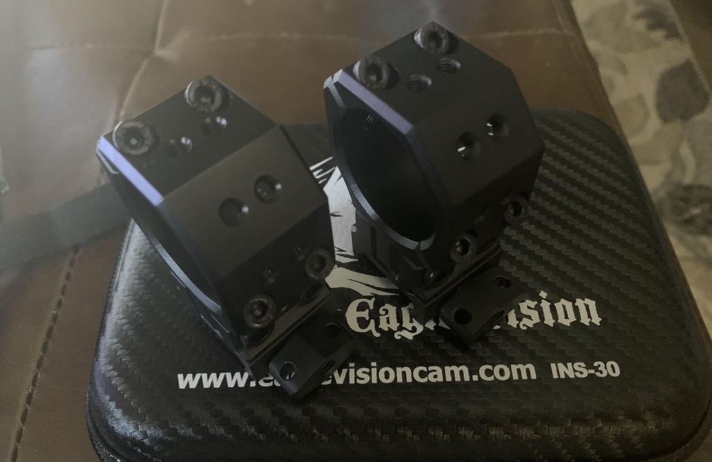

So for me, the adjustables like Sportsmatch and Eagle Vision are a minimum quality and similar for fixed.
