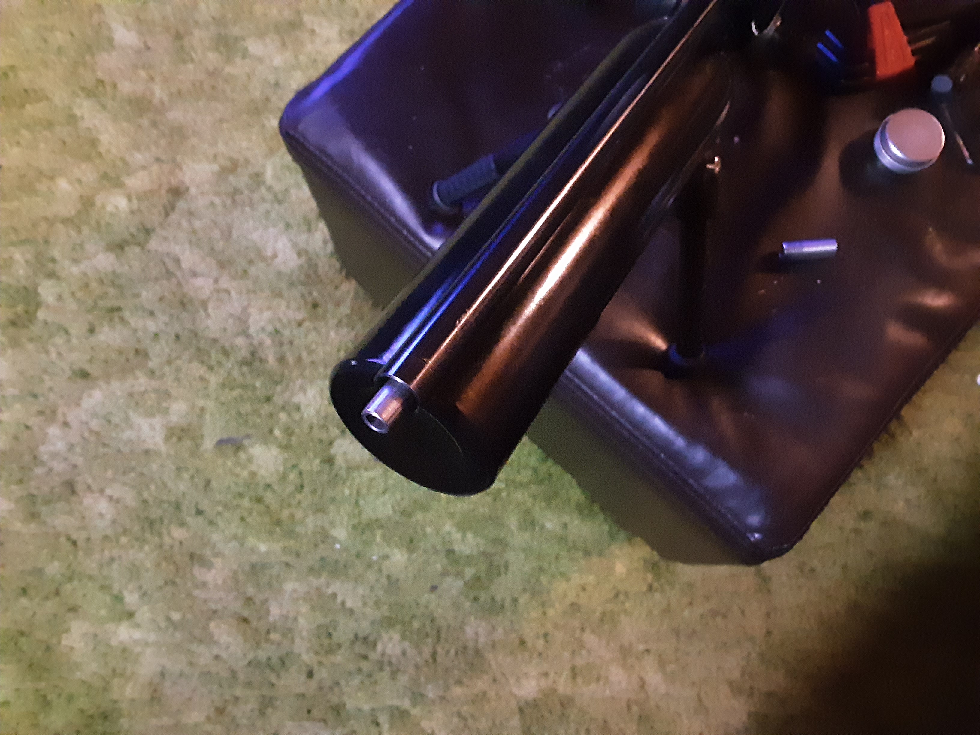

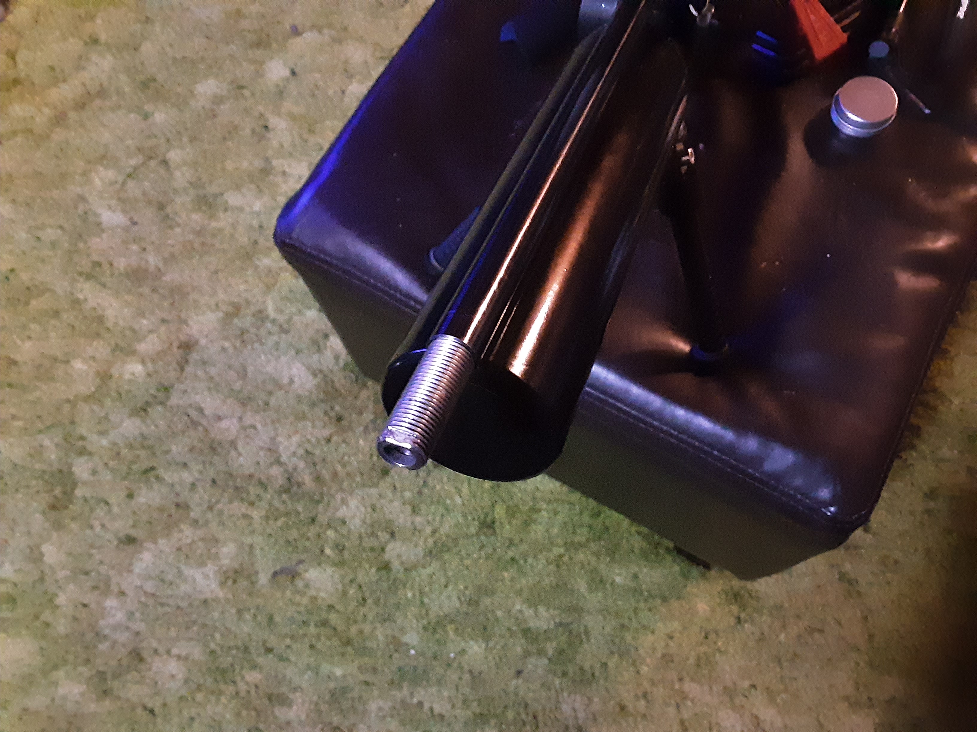

I index at the muzzle. The barrel moves freely from the liner. You remove the shroud and the end adapter and boom there's your barrel . Put the 2 things back on and shoot. Then turn your barrel 90 degrees after shooting until you find top dead center .

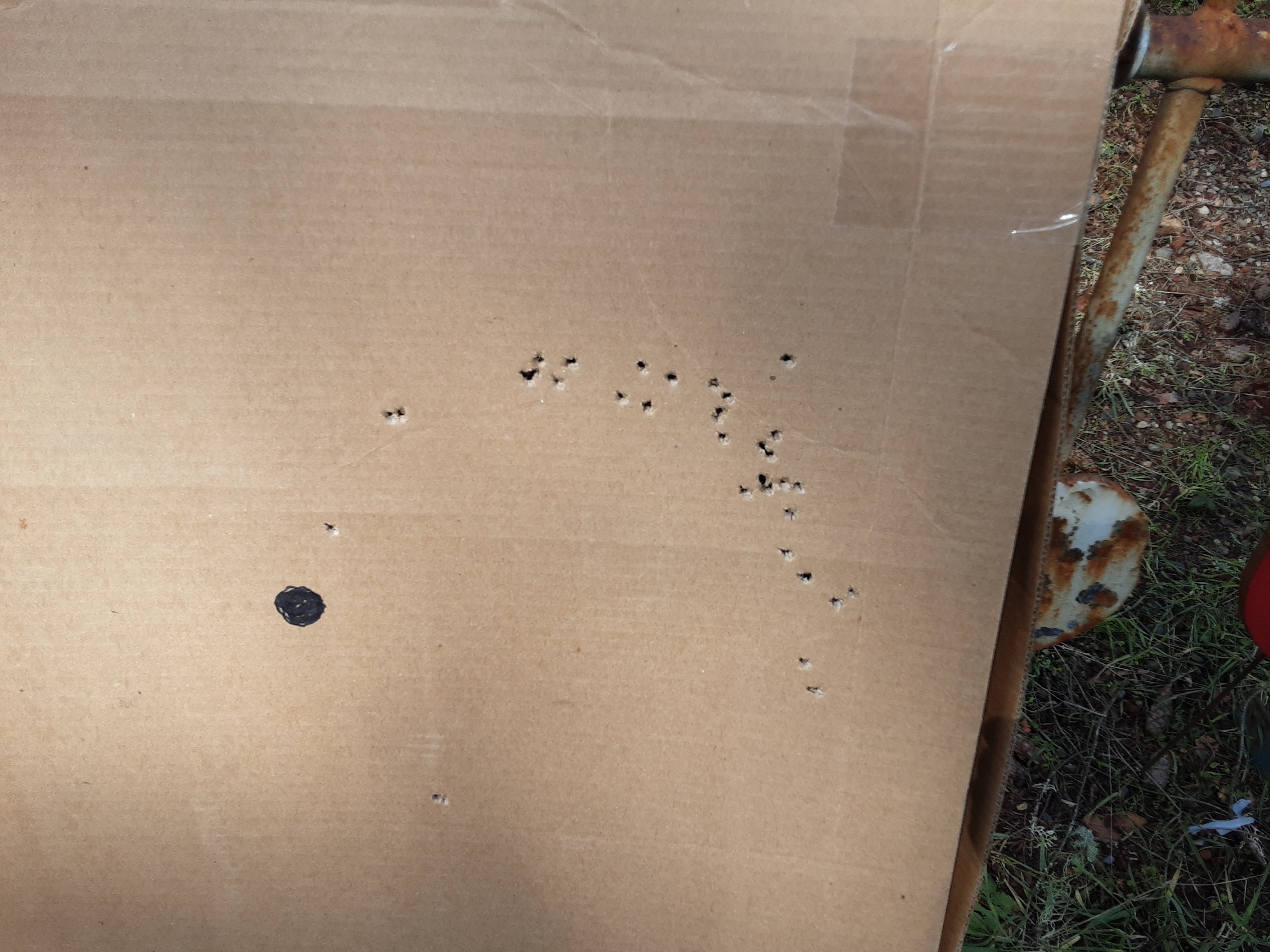

You are correct about the liner rotating a bit while tightening the lock nut. I found that out while I was doing the tests 4 years ago. It would turn to the right slightly. I didn't use any stopper or glue or whatever to prevent the liner to turn. Once I determined the position of the liner where I though it gave me the highest POI, I simply turned it 1/8" to the left before screwing back the lock nut. Assuming it would turn 1/8" to the right. It was just a guess.
View attachment 443683View attachment 443682
Well thank you for restating what we already knew, but you answered none of the questions.
