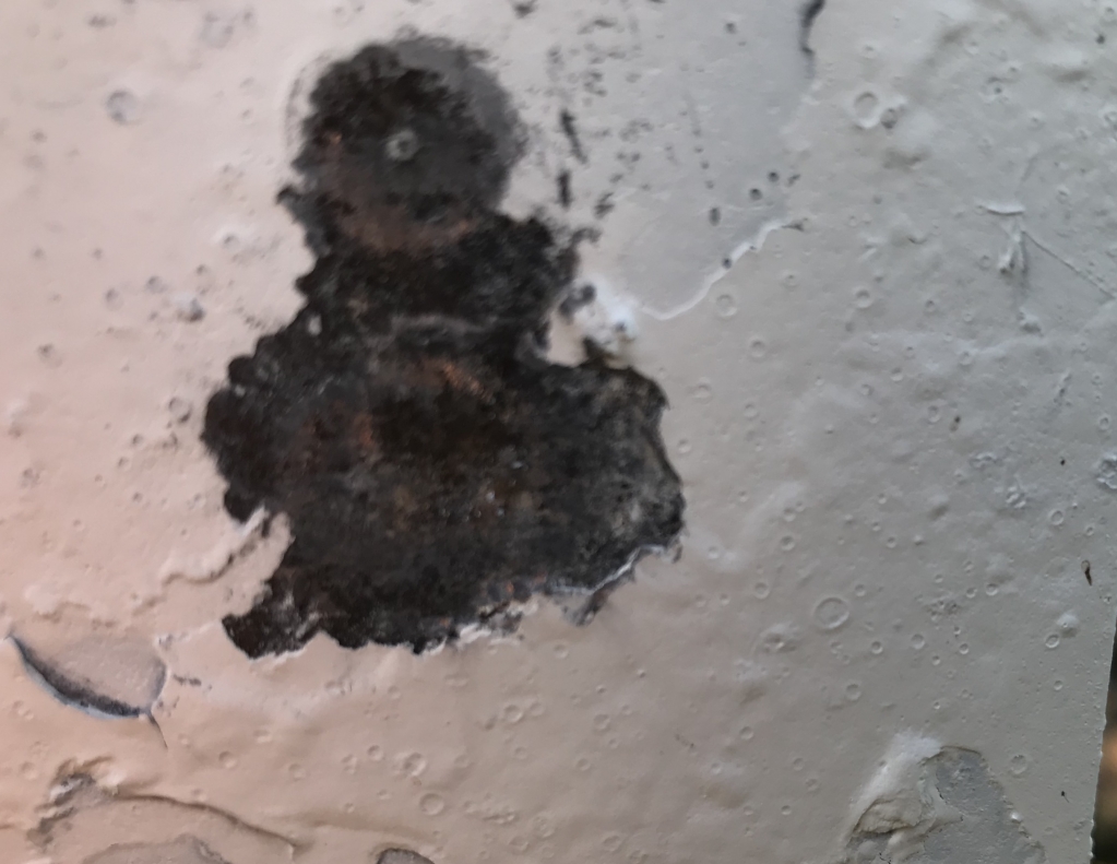

I noticed something that might be relevant here when shooting the monsters. I was shooting them in my RedWolf with Heliboard. It has 12 power settings and normally I shoot them at 10 which is averaging 925fps. So yesterday I’m shooting and getting reasonable groups at 100y. Around an inch or a bit over. Normal stuff.
Then just experimenting I bumped up to level 11 and shot them at 970fps and shot this 5 shot group. Oh and conditions where near perfect.
5 shots.
So Im wondering if there could be more going on than here and the shoots are getting higher precision at these higher speeds “but” it’s fragile and easily set into instability by the wind. Like driving a car fast with a trailer on. You can fly along but if the thing gets unsettling look out!
What drew many very experienced shoots to shoot at those high speeds?
And another question. Could you shoot with you RedWolf with to programs. One for very good conditions and one slower for wind. Just make the decision on the day?
