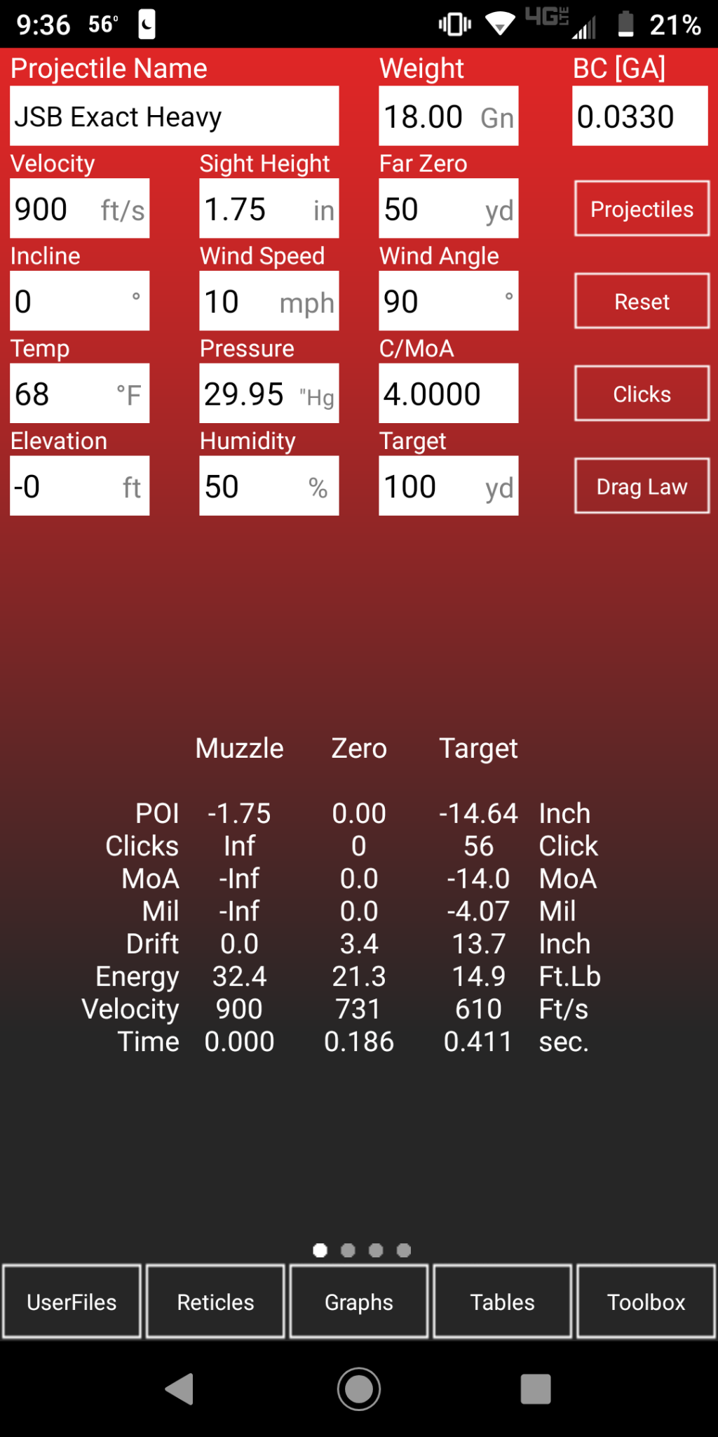

Not going to argue. You’re reading it wrong, and making assumptions based on perceived logic, and not Physics. Sorry. Do me a favor. Go into Strelok or Chairgun. Choose 50 yard zero and 100 yard range. Then input a pellet, say .25 Kings with BC of .042. Now choose 10 mph wind drift at 90 degrees. Pellet speed 900 FPS. It will show wind drift at 100 yards in inches, Mil or MOA. Now change nothing else and make the 900 into 1050 or even 1000 FPS. Now look at what happened to total wind drift. It got LARGER. Funny how the math backs up the facts. Actually, I truly hope it’s windier than normal at EBR, and the Daystate Team are all shooting their .25 Safaris at 1070 FPS. Gives all of us shooting at 900 to 950 an advantage...

Yep, all about the delta vacuum. Better bc wins every time. Don’t believe us? go ahead and punch the numbers in a good ballistics calc.

Pretty plain and simple here's some calculations straight from Chairgun
