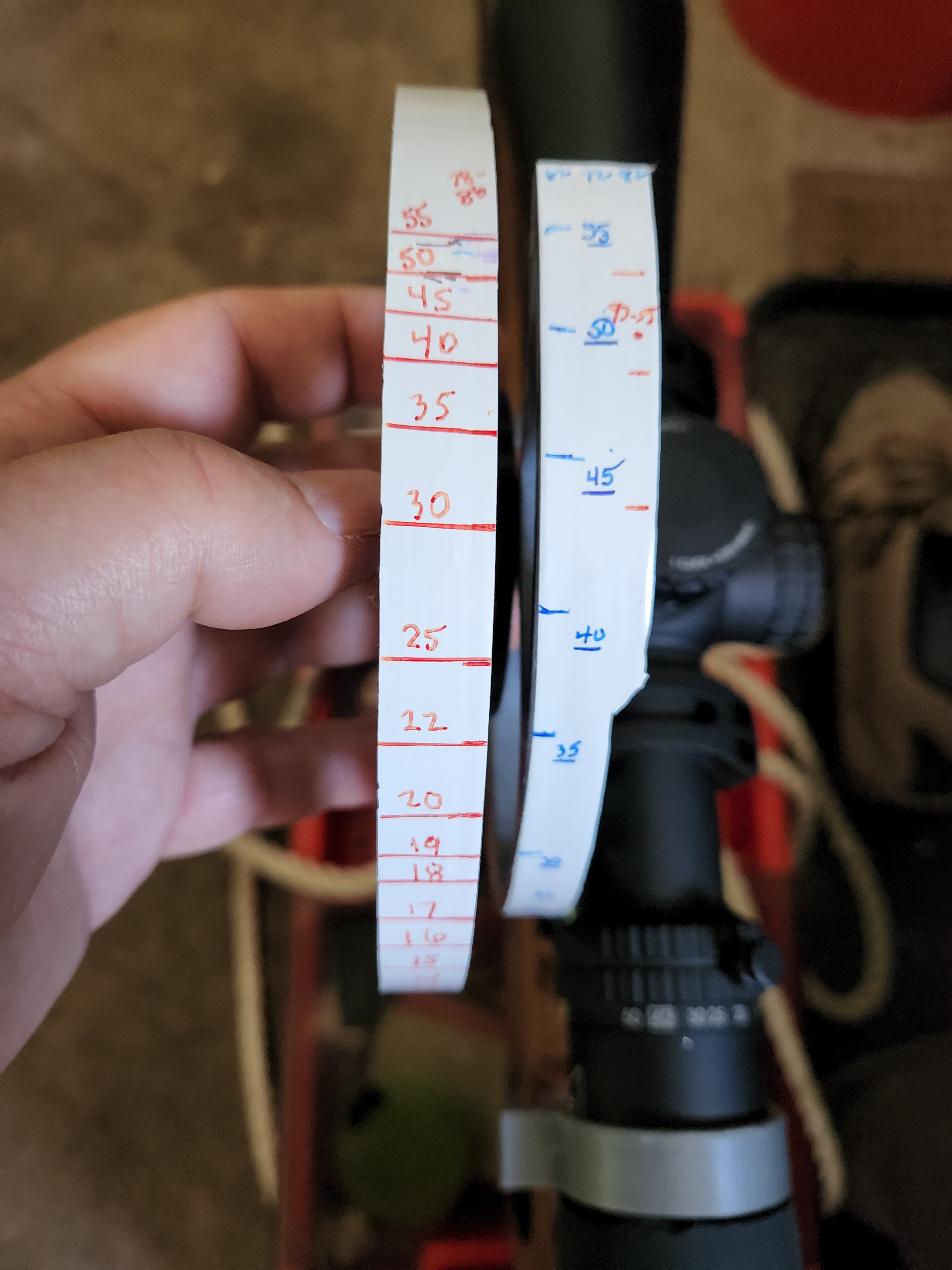

Here's a comparison of the two side wheels (Delta on left and Trijicon on right). The Trijicon wheel is a bit larger. Fortunately, in the US, the Trijicon is only a tiny bit more expensive than the Delta. BTW, the glass is great on both, maybe a bit better on the Delta (but probably the same glass, just a better example).
