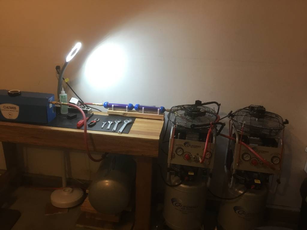

I keep preaching, “heat is the enemy of compressors”. I always run two 12 inch fans directly on the heads of my two cat comprers. , Before that, the 3 or 4 generations of SchoeBox compressors were always open and a 12 inch fan run on the cylinders.
When the first virus lockdown started, not knowing where it would lead as far as infrastructure and having lived a survival lifestyle, I purchased two 35 gallon garbage cans and filled them with water. They set less than 5 feet away from my two first stage California Air Tool compressors that power and produce air for my Altaros Booster system. While monitoring the compressors for heat using my laser temp gauge, my mind wanders to two seperate seneriios.

now the often shown picture if my baby.
