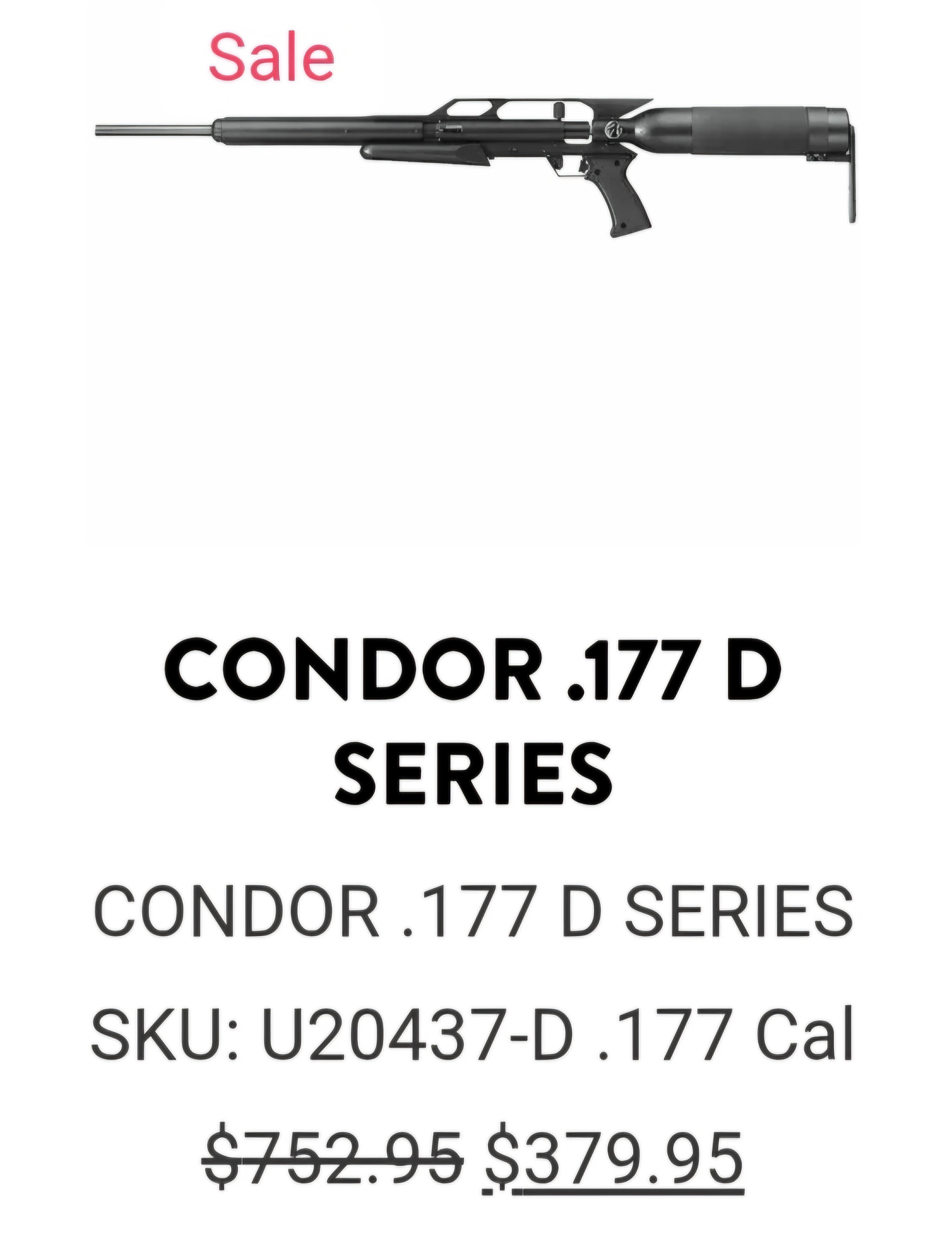

If only my hands had the dexterity to handle .177 anymore. I probably droped more than I loaded before I just gave up and got rid of my .177 guns.
There was a blue .25 model d for 359 the other day. I was obviously just a little too slow and it was gone when I tried to buy it.
I wasn't letting that one go so I sold one of my extra Doug valve.. and got one , have to pick it up on Monday.. I really didn't needed . that valve .. the TalonP valve is more than enough for what I needed.
