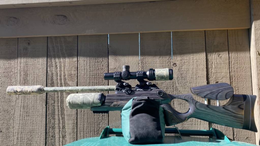

Feeling more enlightened I swapped my Dream-Tac compact and crown to LPVO scopes, at 20 yards 4 is about as high as I can do because of the fixed parallax. Today I was shooting my crown with Alpha6 1-6x LPVO at 4x with a 2 MOA center dot, it's a HUGE dot because at 20 yards and 4x that dot is 0.6 inches! I'm trying to land 0.177 pellets on top of each other. Employing what @flintsack method of framing or put that big round dot around where I want to shoot and then employ Keith from Wiskey68 method of timing my movement as the obtrusive black round dot/frame move over the target then press the trigger as the POA is mentally centered. I was able to land 3-4 shots in 1 jagged hole, to say I was shocked at the result is an understatement! This is complete opposite of what I used to do! Only 4x magnification with huge 2 MOA center dot vs 12x and fine line or small center dot reticle! And I was able to repeat the feat far more consistent and easier than my old "aim small" method! Only time I can really stack pellets on top of each other is either I had a really good day or completely rested with bipod and rear bag!

Here is a picture of my crown and said scope because everyone likes pictures! =P
