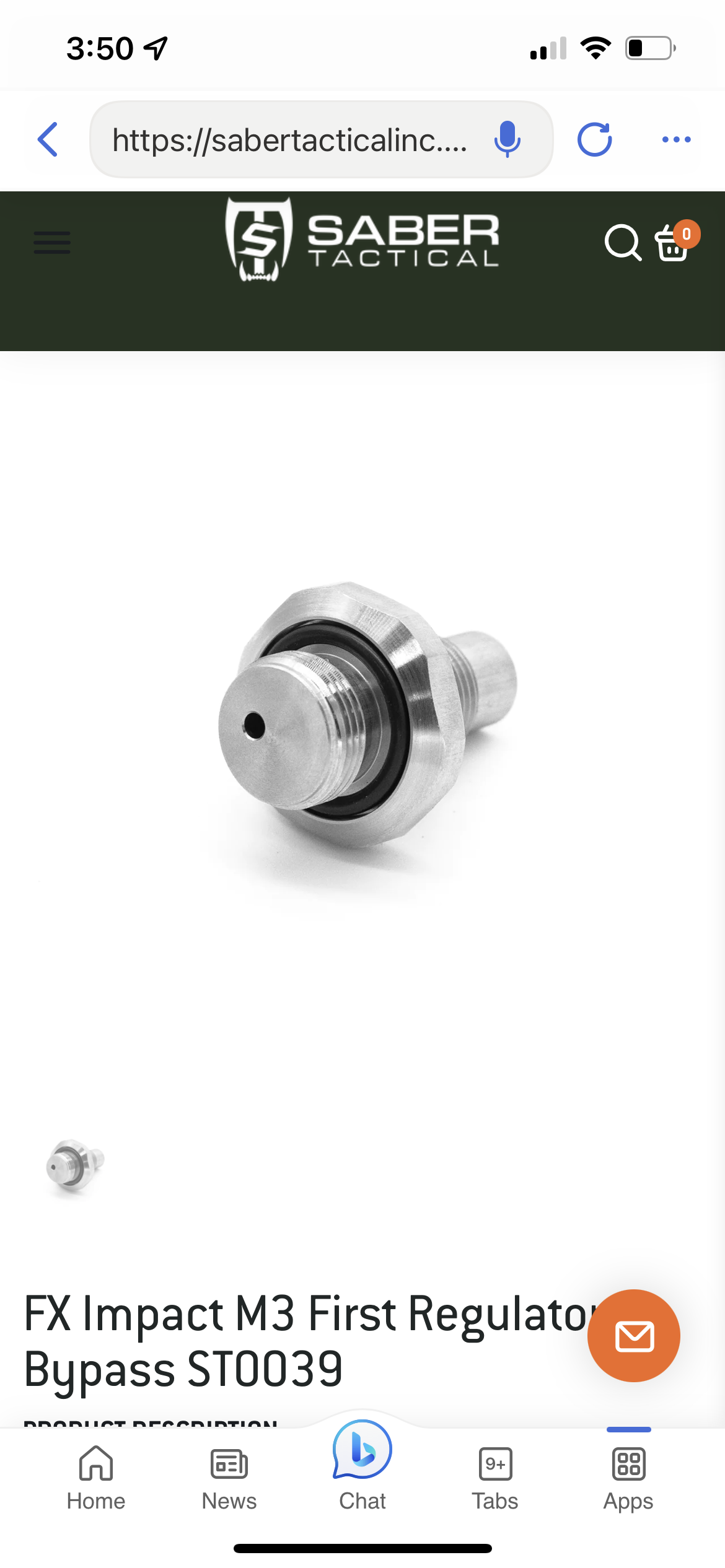

Just back it out to flush, or like one member said cup all of the Bellevilles, boom one reg.
Do you have a link? Cant find it on their website
This is where are you send it into an Airgunsmith to custom machine a bypass for the gun
