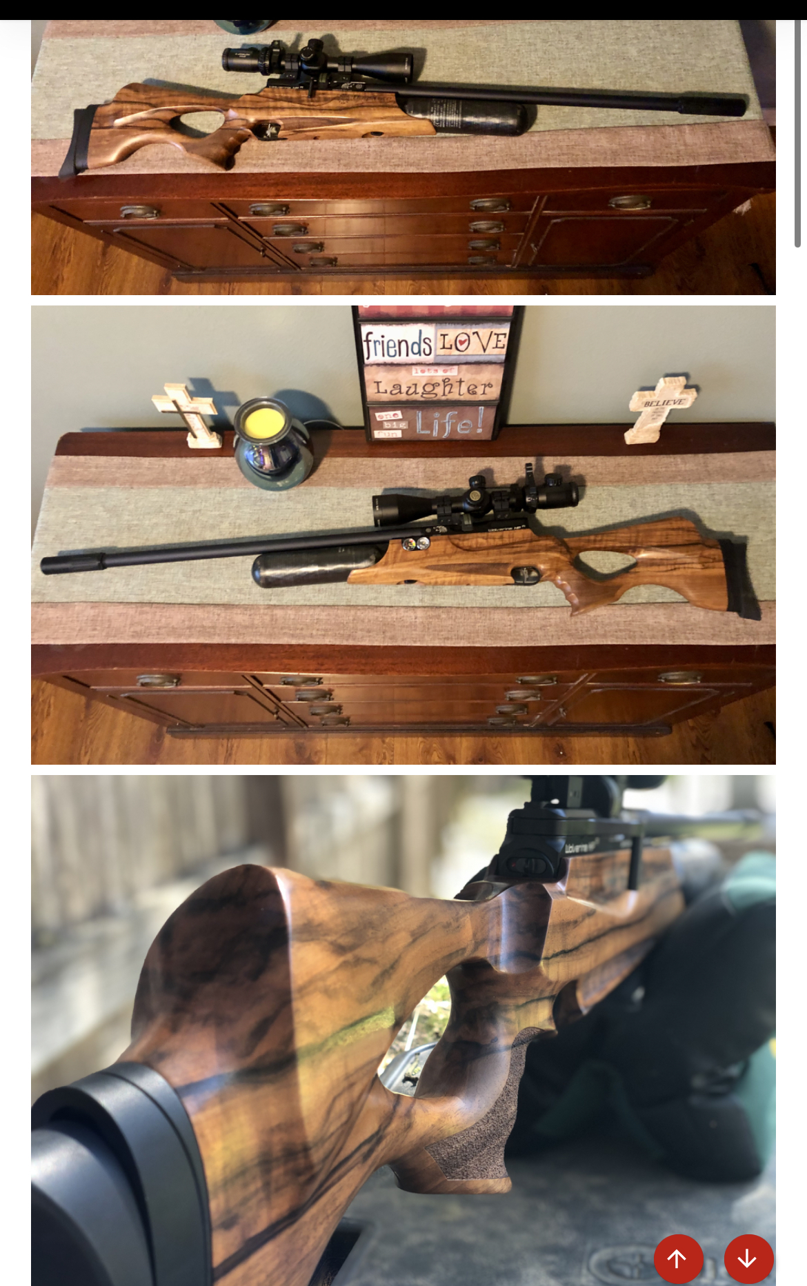

My .177 Wolverine HP begs to differ. Shoots 13.43gr JSB Knock Outs very good at 975 fps for 28 FP. Of course the beauty of using slugs (even at only a .067 BC) at 100 yard it is still going 800 fps for a touch over 19 FP.
Airgun pic!! Love it!
Beautiful wood on that stock! My Wolverine R has nice wood on it but yours is exceptional!

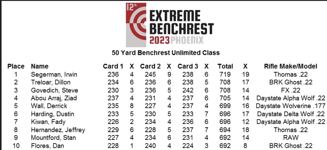

Spot on. I could rant about my Panthera 177 20 grain slug addiction but I’ll drop the mic to the master of 177 mayhem:

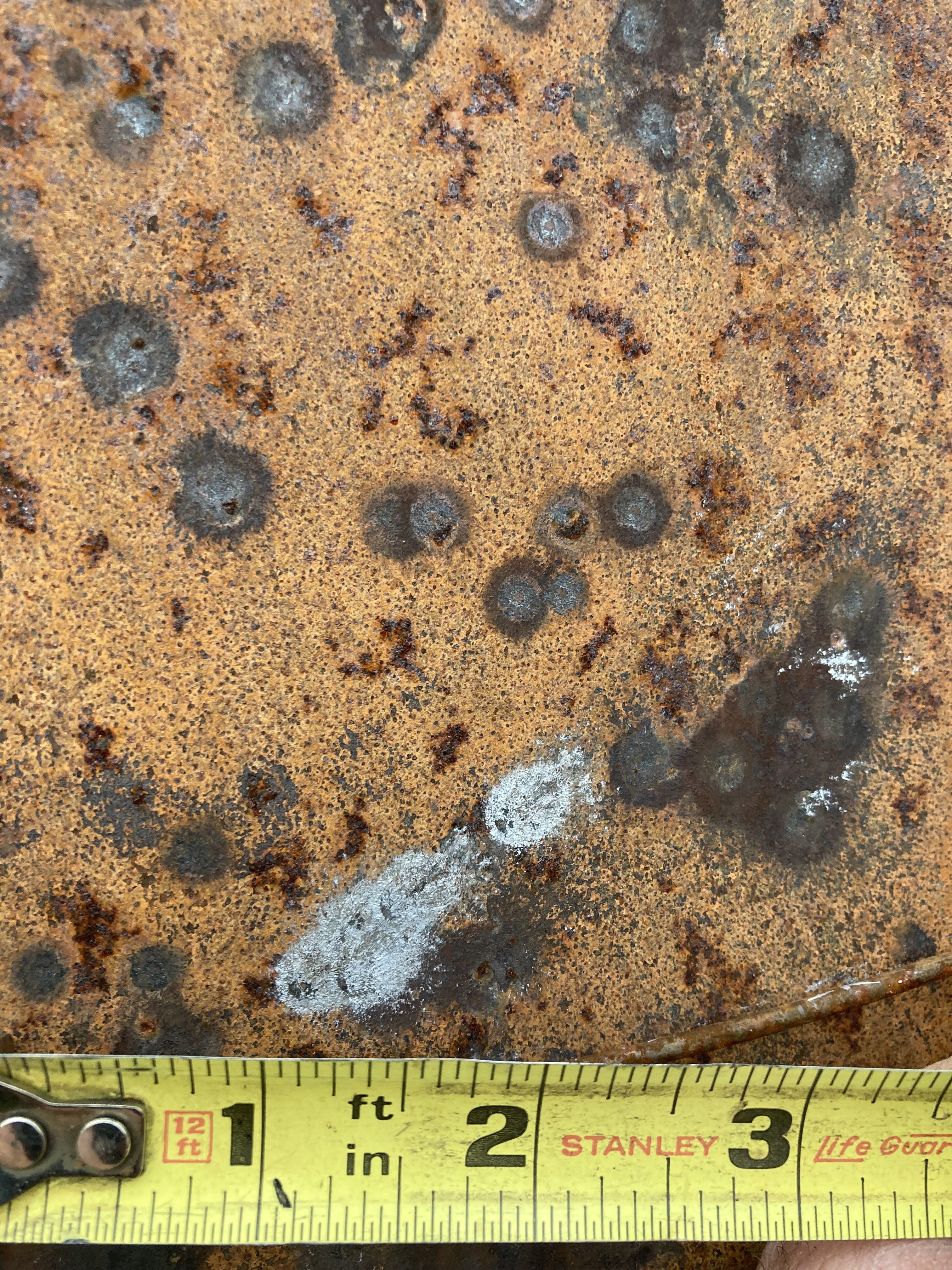

I’m a big fan of the .177 caliber, especially in high power.
My RedWolf .177 HP is an absolute pleasure to shoot.
It loves the 13.43 knockout slugs and is extremely accurate out to 130 yards.
This group is my best so far at 130 yards.
That slug is going about 1020 fps and there is no recoil with the shot.
So you can shoot, and watch the slug impact the target, and the crosshairs barely move at all.
They stay on the bull the whole time you are shooting.
And the slugs slice through the wind incredibly well too, not like a .30 caliber, but still very impressive.
Plus that tiny little slug moving that quickly is just devastating to pests.
I’ve posted pictures of the results on chipmunks in the hunting part of the forum and it’s pretty incredible.
Add to that you get twice as many pellets or slugs as you get in .22 and that’s a whole bunch of shooting sessions!
Edit: This is a five shot group and the impacts are glancing off the steel sheet to the right because the target is crooked lol!
I don't know how that Wolf shoots, but it sure is purdy! That just might be the purdiest stock I've seen!
