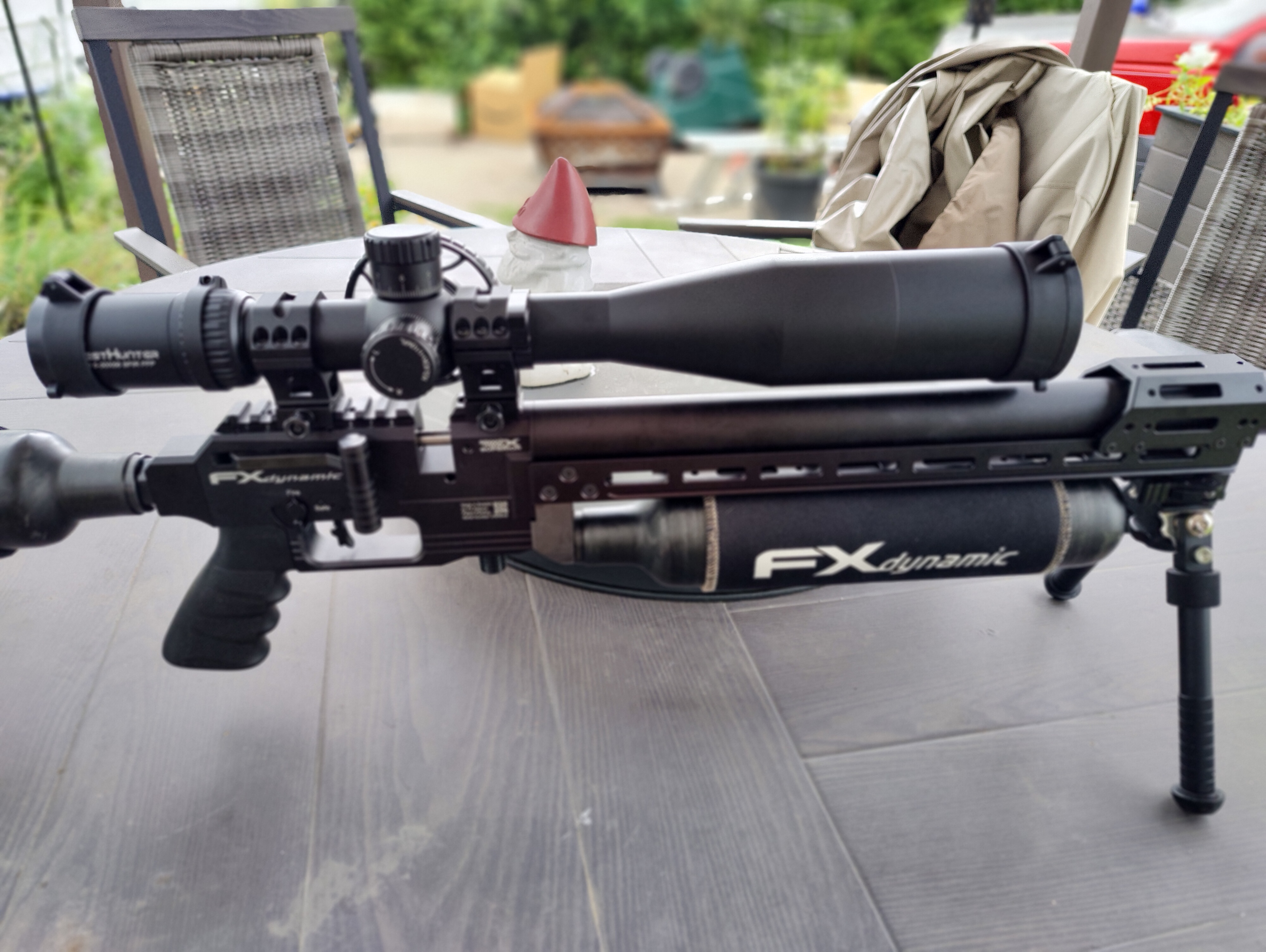

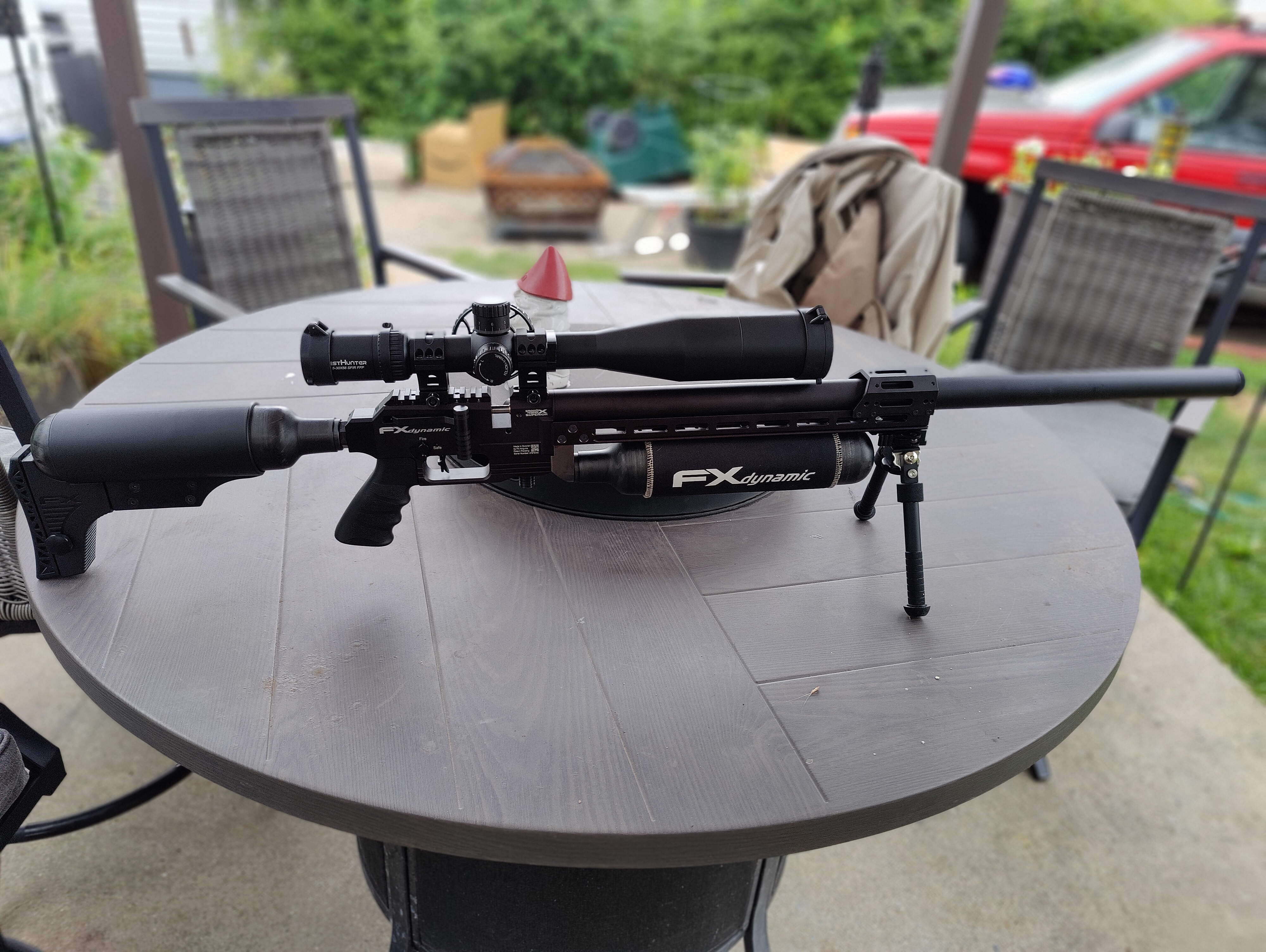

Got the Fx Dynamic 700, 22 cal…installed my Fx Impact large bottle on the back and got 120 shots with 30 grain slugs at 940 fps…no need for front bottle…kept the arca rail…same power of Panthera with lots of shots and best overall accuracy since bottle is directly behind the action…hope it do not leak air as my previous 2 Pantheras…so far…much better than the Panthera…

What length barrel did you get? I have the 30 with a 700mm barrel. That 700cc with will be fine even on the front of the 600, it's a long gun. The 580 is only 1.6 inches (40mm) longer than the 480, so as long as you don't have short arms and need a short lop then I think it will be fine.

Yes, it is. I need both bottles for a decent shot count. Hoping to get 60-80 per fill. I ordered the 700mm. For targets I'd just stick with pellets unless your way out over 100 yards.
