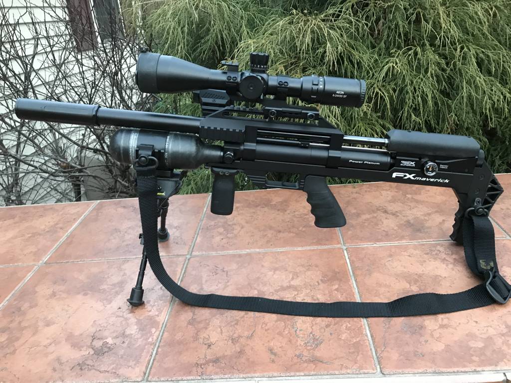

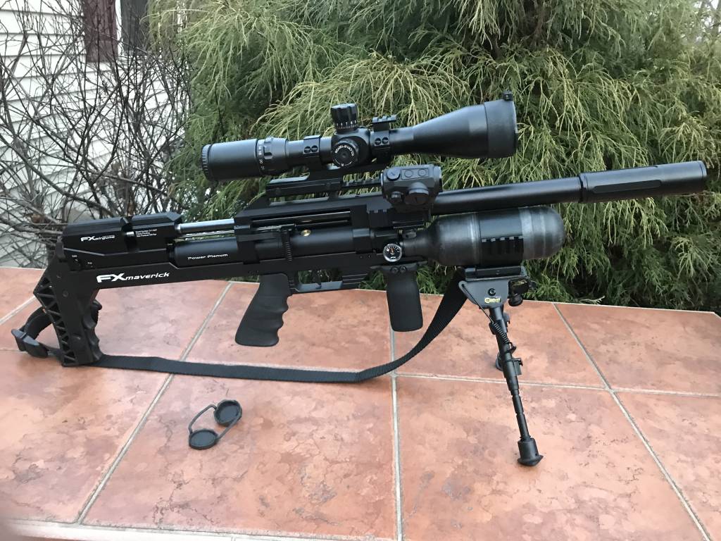

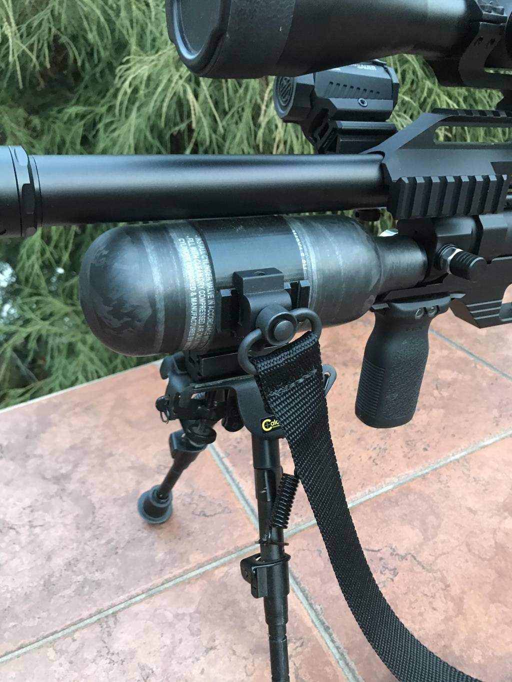

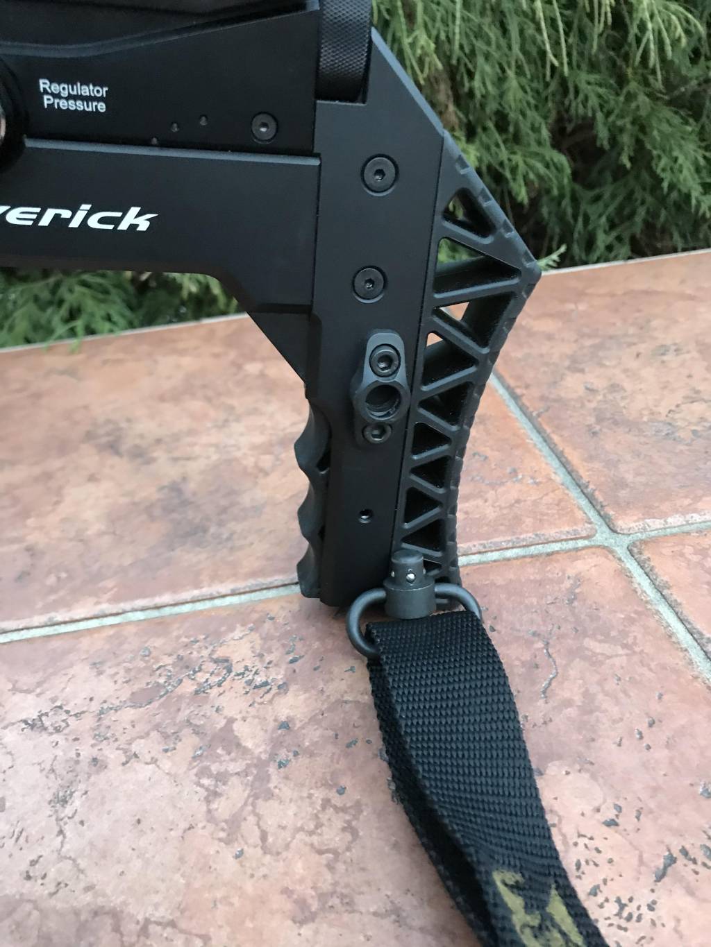

Got my compact .30 and started dressing her up for next summer of groundhog hunting. I must sling my guns as I use binoculars and trigger sticks when I hunt so I just added a quick disconnect swivel mount on the rear side butt panel. I used one for a M Loc application so I had to grind the backside flat, then drilled and tapped the two holes. The panel comes off with two screws so it was an easy off the gun procedure. I have a quick disconnect picatinny mount on the bottle band I ran on my crown. There is a problem mounting the sling swivel on the side with the fill probe. The fill probe sticks out too far and pokes you in the back when slung barrel up. But there is no problem with it slung barrel down. It would be better mounted on the right side as nothing sticks out there but I also mounted a 45 degree mount on the front side rail to run a red dot scope. I like this setup and did the same thing on my Leshiy 2 for those times when an opportunity pops up say within 30 yards and you have the scope on 12 power and the focus out at 100 yards. This one is the Sig Sauer but I prefer the Hallosun with the sleep mode and solar power. Got to get the bag rider and the power kit and I’ll be ready. Haven’t shot it yet so nothing to report there yet.

Quick question do scratches digging into the carbon fiber bottles near the bottle shoulder areas due to owners simply unscrewing them normally compromise structural integrity resulting in shorter bottle life expectancy and not pass mandatory periodic visual inspection and potential user's safety?
It depends. I've scratched up two bottles already, but it was fairly superficial. The epoxy material is on there pretty thick, so I'm not real concerned. I put an even nastier scar on a 480cc bottle last year, dug real deep into the bottle (much deeper than what the Maverick shaved off). So like a soldier, I aired that thing up to about 280bar and let it sit in a drawer for almost a year lol, it seemed fine.
Mine has done the same thing. Really pisses me off this could have easily been avoided and corrected during design. I have tried to be extremely careful when removing and installing but it still happens. Structurally it's not hurting anything but you would think for the price of these guns this would not be an issue. Tapering or even shorting the pic rail a 1/4 inch would fix it. An easy fix just don't feel like cutting on a 2k gun

Keep in mind what I said about the fill port when deciding the side you put the rear swivel. If you don’t attach anything on the forward side picatinny rail I recommend attaching the swivel to the right side so the cocking lever is to your back when slug over your shoulder.
