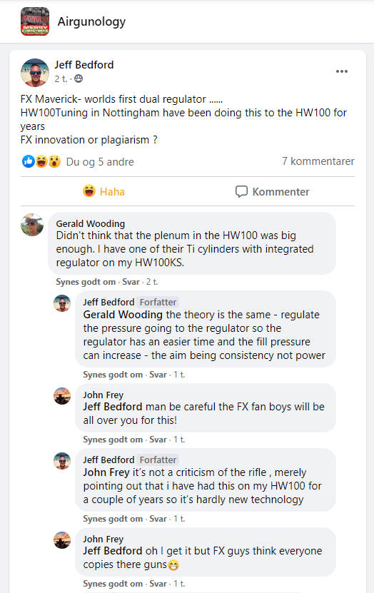

Just saw this posted on FB group Airgunology :
I guess this is not the latest FX innovation, dual regulators. Been used in HW100 for years.
It's a tuning specialist that uses 2 regulators, not the manufacturer.
Yes, but if it is already used by others for years, you can hardly call it innovation ?! 👍 Innovation is something new and better 😃
If it wasn’t mentioned already, two regulators have long been a thing in paintball.
https://www.paintball-tips-and-tricks.com/paintball-gun-regulators.html
So it’s hard to make the claim of innovative since it isn’t even a novel use in a new application. Both are airguns.
If it works great, that’s what matters. I just think people generally have a low tolerance for claims of creativity or originality when those claims are easily discovered to be false.

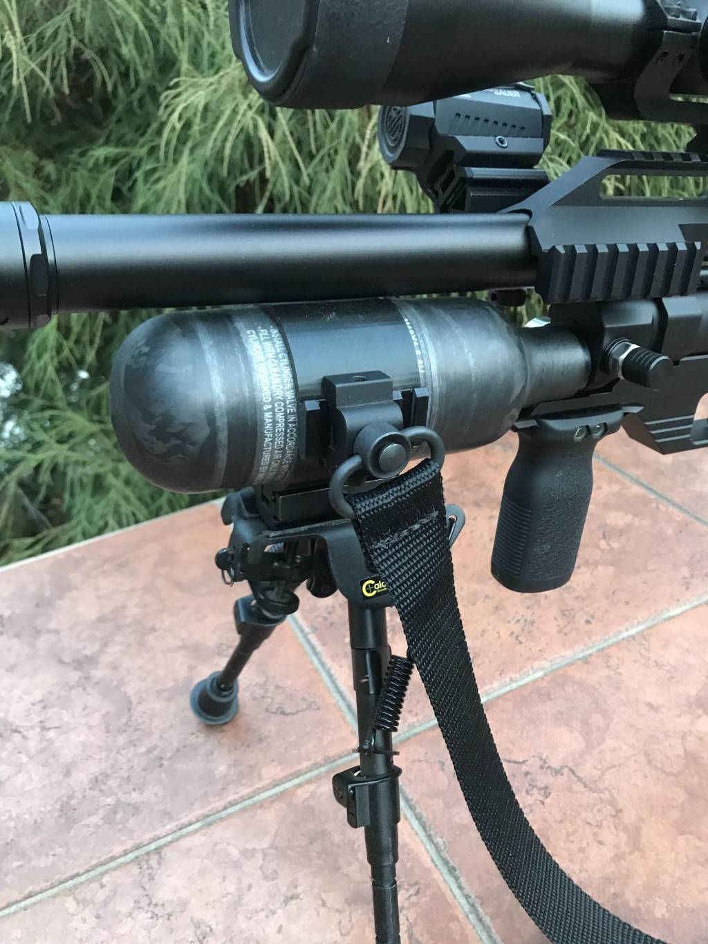

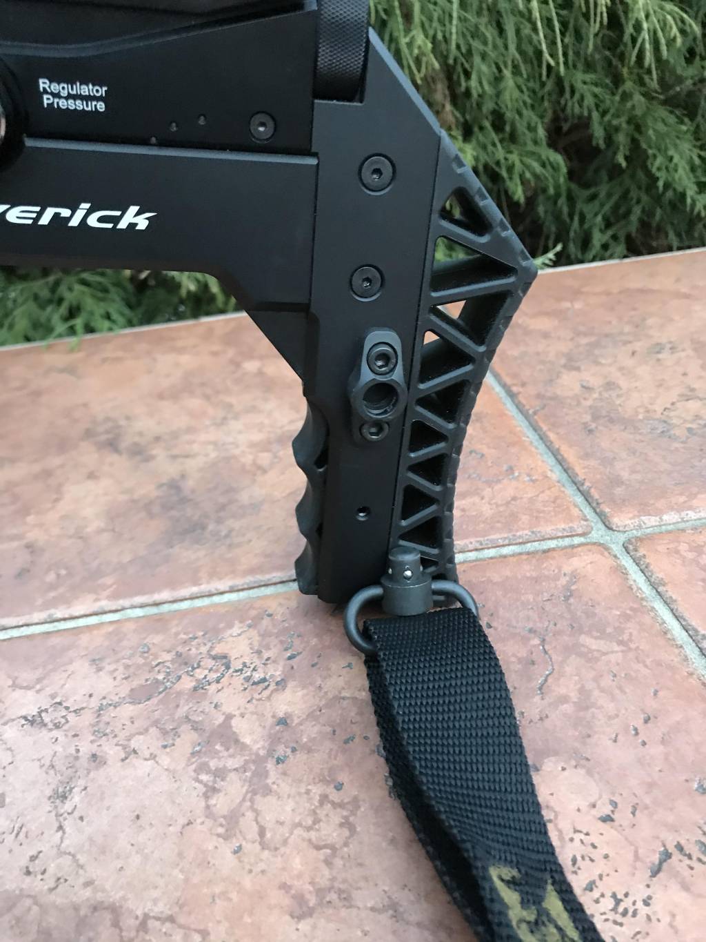

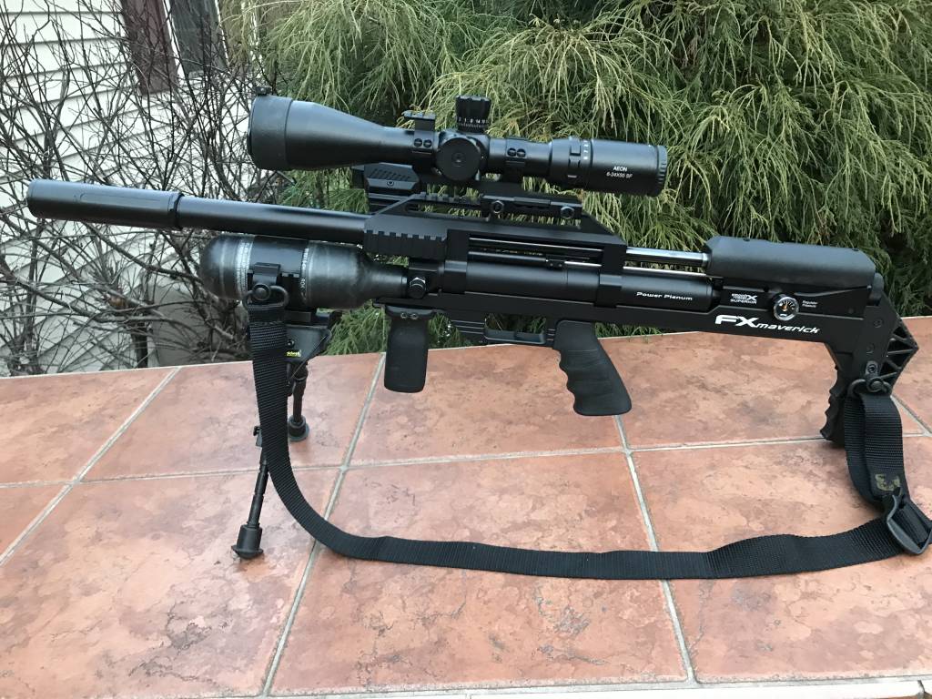

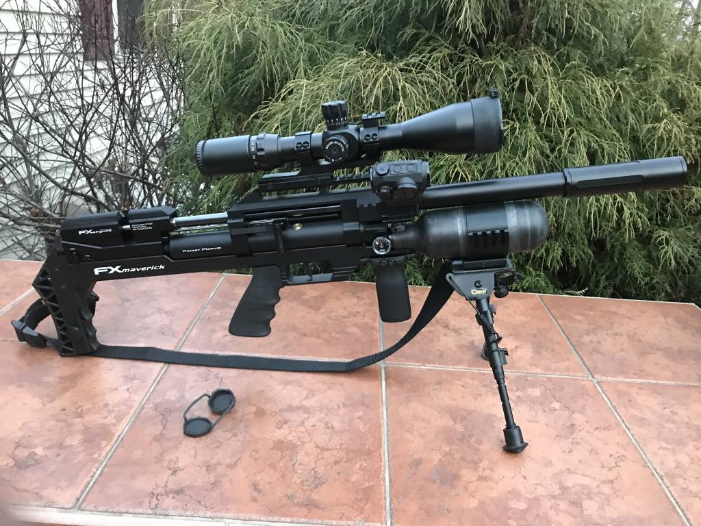

Got my compact .30 and started dressing her up for next summer of groundhog hunting. I must sling my guns as I use binoculars and trigger sticks when I hunt so I just added a quick disconnect swivel mount on the rear side butt panel. I used one for a M Loc application so I had to grind the backside flat, then drilled and tapped the two holes. The panel comes off with two screws so it was an easy off the gun procedure. I have a quick disconnect picatinny mount on the bottle band I ran on my crown. There is a problem mounting the sling swivel on the side with the fill probe. The fill probe sticks out too far and pokes you in the back when slung barrel up. But there is no problem with it slung barrel down. It would be better mounted on the right side as nothing sticks out there but I also mounted a 45 degree mount on the front side rail to run a red dot scope. I like this setup and did the same thing on my Leshiy 2 for those times when an opportunity pops up say within 30 yards and you have the scope on 12 power and the focus out at 100 yards. This one is the Sig Sauer but I prefer the Hallosun with the sleep mode and solar power. Got to get the bag rider and the power kit and I’ll be ready. Haven’t shot it yet so nothing to report there yet.
