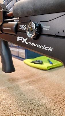

How is the accuracy of the pressure gauges on the Maverick? Previous FX models have had poor gauge accuracy. And a lot of buyers, we have had to swap the gauges with either huma, wika etc. Have FX finally attended to this issue with this new PCP?
Both the new gauges came reading "around" 125bar. I have a Benjamin Traveler compressor that is set to 250bar. As you would expect when the compressor didn't shut off after passing 250bar on the Maverick FX gauge I get a little nervous, but I am confident in my compressor setting because in fact I changed out the black face FX gauges on the Impact(for the same inaccuracy issues)for Wika gauges and it shuts off @250bar +-5 reading. I continued to monitor the Maverick and it finally shut off at a gauge reading of 275bar, So no, the gauge accuracy has not been addressed. After taking a mag worth of test shots the second FX reg. gauge settled in @ 110bar. Not sure if that is a real or close reading, but it is a reference point. I'm going to let things settle in with a day of shooting and then measure, test and adjust for projectiles. I think I'll take the Wika's off the Impact and put them on the Maverick to see the difference in readings with the "factory settings" I will also compare readings against my Joe Brancato SCBA 2.5" gauge setup.

Patrick will the wika gauges fit where the Maverick gauges are located. Does wika or huma make gauge that size?
