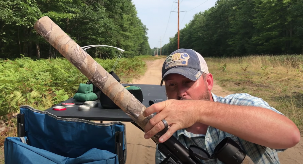

If you have been following me the last few years you may recall seeing those rubber Limbsaver donuts on my barrel and this hideous shroud thing I had on my gun from the very beginning of my YouTube Chanel. That is actually where this idea started as I made that shroud out of ABS plastic tubing. The secret sauce is what was in side of that barrel shroud I had made. There were two rubber pull plugs on each end for dampening and then a collar weight on the barrel itself I would move up and down the barrel. What I found was barrel harmonic tuning was NOT a macro effort of sliding something up and down the barrel - it had to be very small adjustments. I could literally nudge the collar weight almost an imperceivable amount and it would change the shot groups. I think people who say those rubber donuts work have found that dampening does help, but to find WHERE it needs to go on the barrel is a total lucky guess.
The research we put into this FX approach takes all of this R&D into one complete package to make all of this fully controllable and repeatable.
