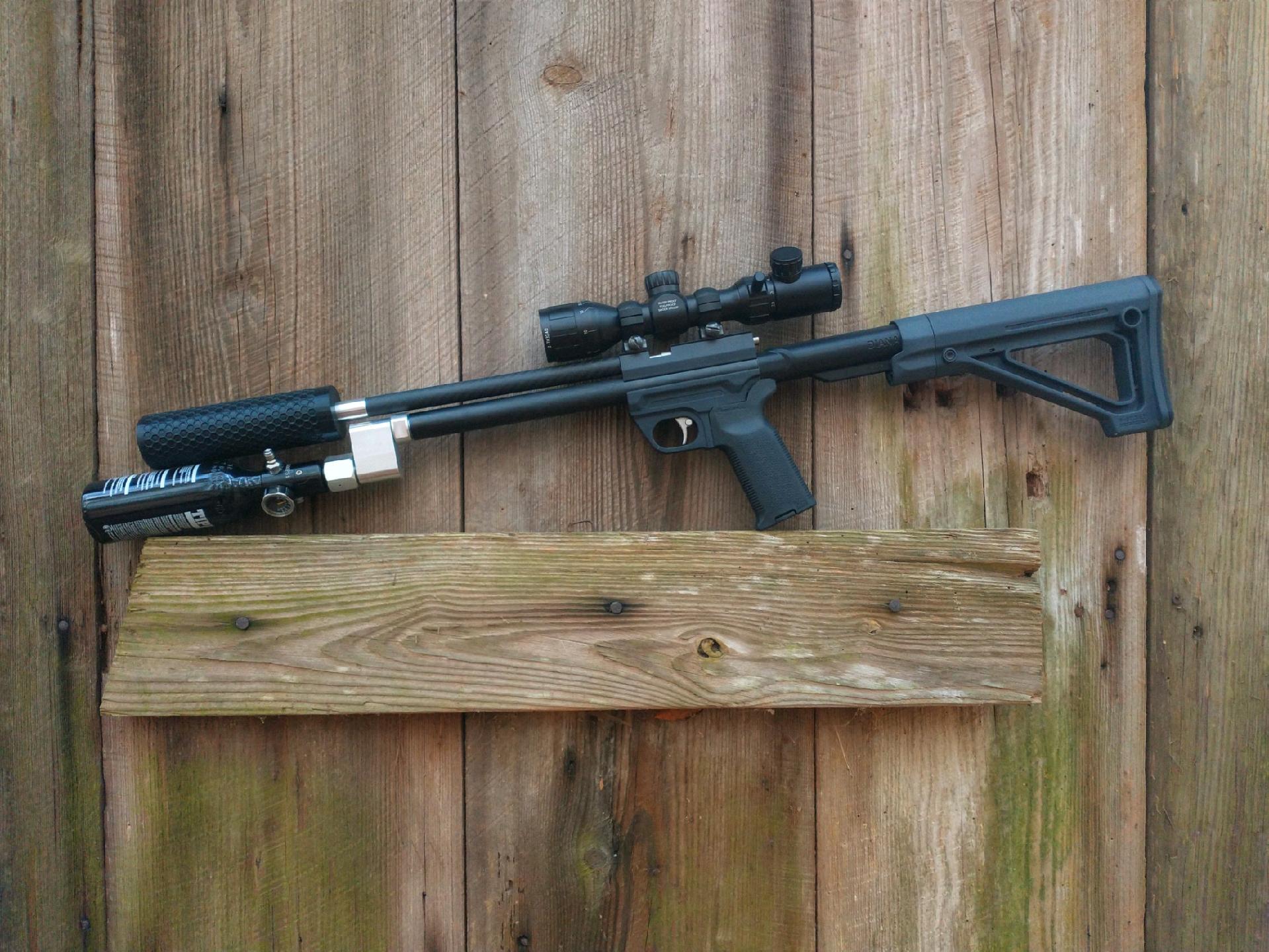

Here's my work in progress .25 Bottle Bandit. It's wearing a 9ci hpa tank and running an 1800 psi regulator attached to a Froggy's airguns drop block.

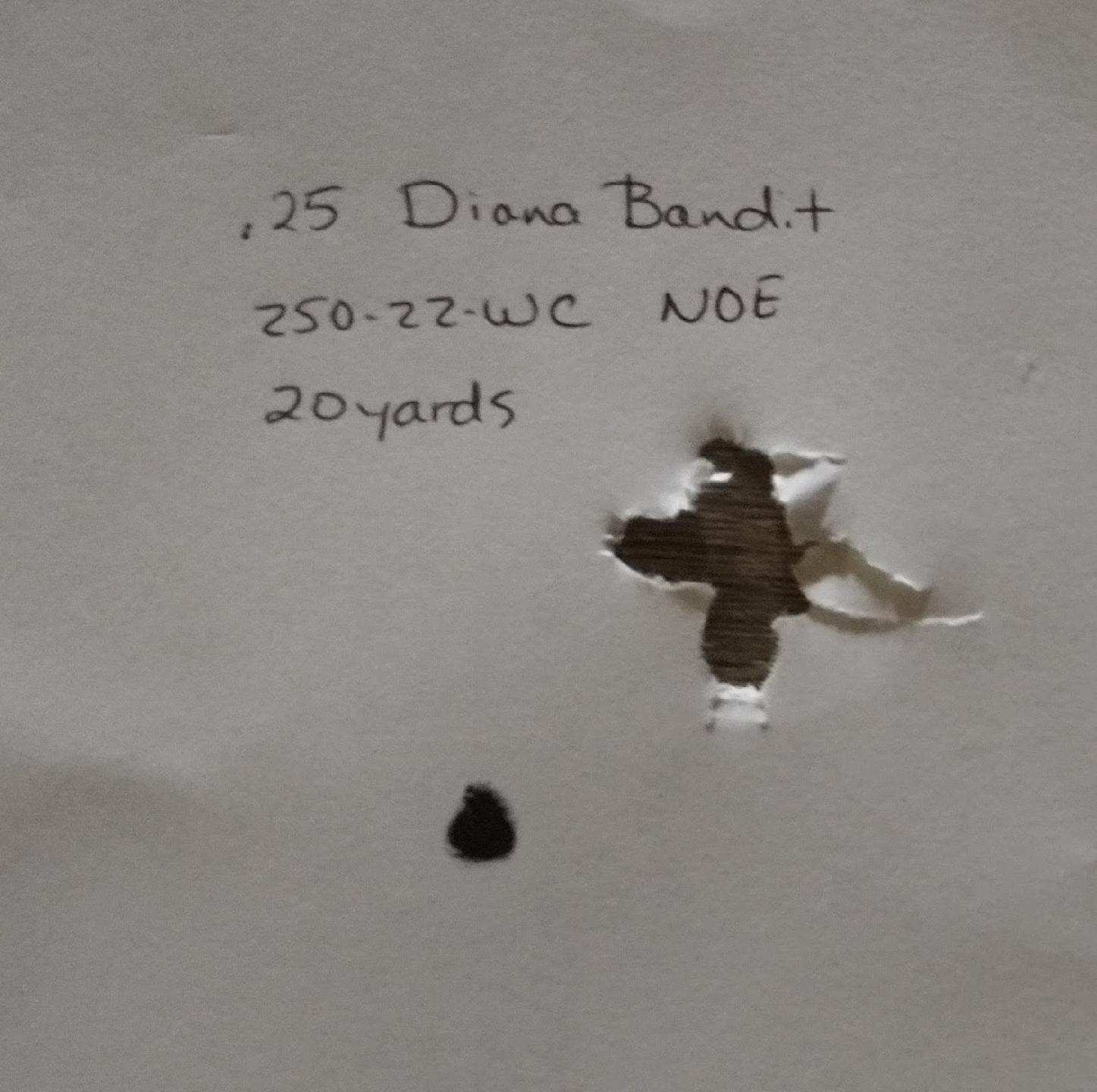

Initial testing puts it just over 19 fpe with my 27 grain cast hunters and around 18.5 fpe with my 22 grain cast wadcutters. Accuracy at 25 yards is looking good. More to come...

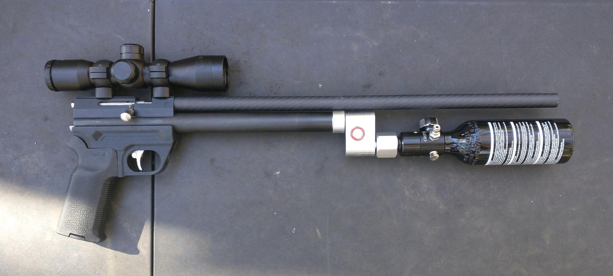

I have a 25cal pp800 I got from him. I believe he sells 19" barrels that fit. I have a 9 and 15". Does 48 and 65fpe respectively but only gets 2 shots per fill 🤣 maybe could use a bottle as well, but I don't want the extra weight or mass. Idk about yours, but both barrels I have are outstandingly accurate.
I have a 25cal pp800 I got from him. I believe he sells 19" barrels that fit. I have a 9 and 15". Does 48 and 65fpe respectively but only gets 2 shots per fill 🤣 maybe could use a bottle as well, but I don't want the extra weight or mass. Idk about yours, but both barrels I have are outstandingly accurate. View attachment 319663View attachment 319664

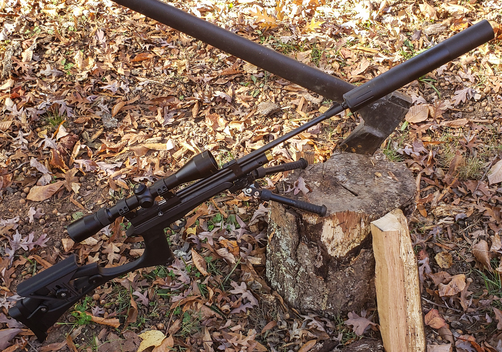

He does have the longer barrels, but I really only want enough length to even up the suppressor with the tank. I might have to order one and cut it down. I've got to say that it balances really well even with the tank. It just feels solid.
I bought it hoping it would shoot my cast wadcutters, and it does that well. It's a little thumper up close and does great defending the feeders.
