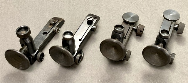

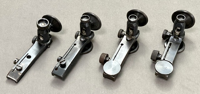

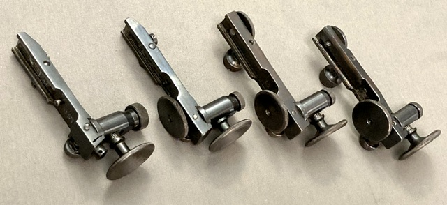

Circling back to the OP, here are four variations of the first-generation Weihrauch "turret" style diopter sights. All date from the 1950's, and are milled from solid steel. Again they seem to have been made in small batches, as there are many variations.
A signature detail of all HW diopters is the screw at the front which mates up with one of the holes on top of the rifle's receiver to securely locate the sight's fore-aft position. Another Interesting feature is separate locks for the windage and elevation adjustments (they seem a little paranoid about that in Bavaria!). On all these, the elevation is locked by tightening the flange of the big eye disk against the flat back face of the turret, with the windage lock varies.
They are in order of age from left to right.
+ First one looks identical to specie's example. The windage lock is the odd screw at the back, which requires a rod type tool to tighten. The slotted screw on the top front of the sight's base is the position locator, and the side clamping screw is similar.
+ Second one is much the same, but the windage lock has morphed into a massive thumbwheel underneath the back...that's its only function.
+ Third one replaces the front locator screw with another big thumbwheel - a "trademark" of all later HW diopters. The wheel sits on top of the sight's base. The clamp screw is a bigger knurled finger knob.
+ Fourth one is similar but the front thumbwheel is recessed to fit flush with the base, and the turret is dropped slightly (I've noticed it can be hard to adjust these old sights low enough for 10 meters, and progressive changes in their design reflect that - the back sights got lower, the fronts got taller, and the stocks got that little dished-out area behind the receiver!)
"Form follows function," as the old architect said!

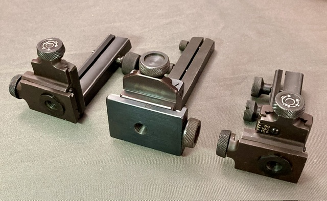

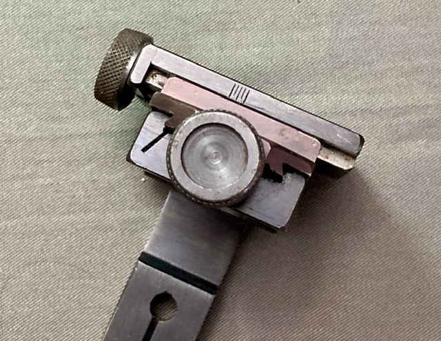

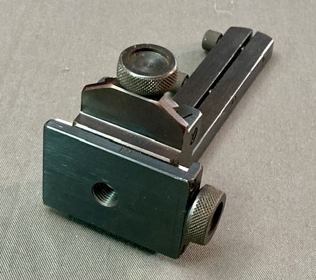

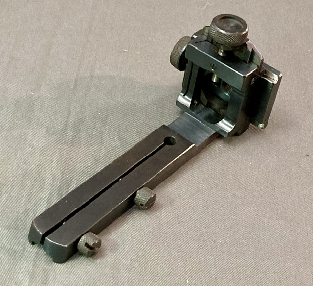

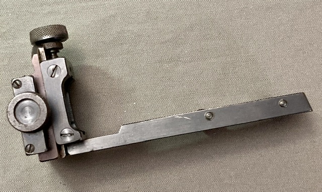

This one gets the prize for my weirdest diopter - an auction site impulse buy from a Bulgarian seller. I have no idea when, where, or by whom it was made:

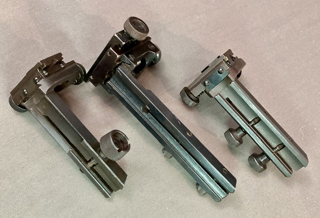

The thing is huge - here it is below two other infamously chunky sights, an Anschutz 6700 and a BSF S54 diopter:
Every piece of it is milled, polished, blued steel - by far the heaviest diopter I've ever seen. It fits perfectly on any Anschutz, Weihrauch, etc. having standard 11mm dovetails, and takes any German eyepiece (the thread for which passes straight through its mount, thus accommodating the anti-glare tube seen attached above). The attachment rails have a certain Anschutz vibe, but the movable parts are more Walther-esque.
It has no markings save minuscule reference scales and a number underneath - not even "which way do I turn the knob" arrows.
If anyone knows what it is...please chime in!
Reactions: Bandito

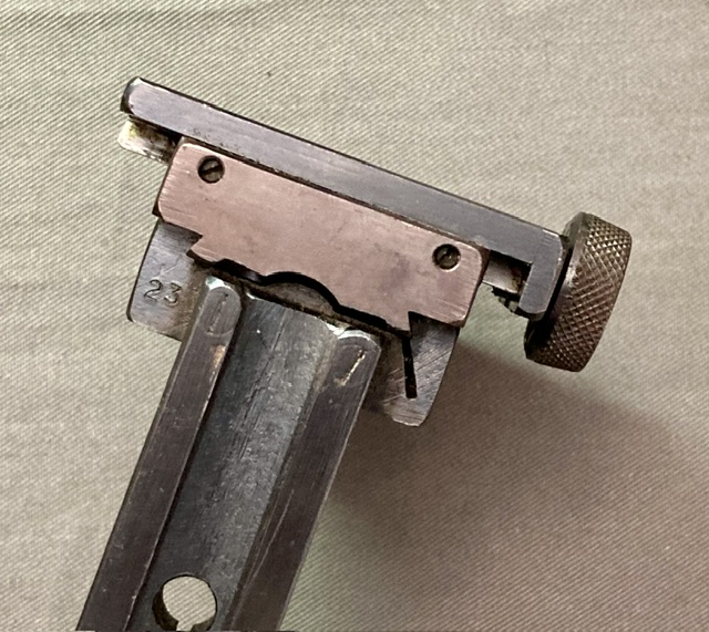

Yes, the Bulgarian sight looks influenced by the Walther steel airgun sight, maybe the "robust" coming from the Russian designs of that era?
Note the assembly numbers "23", hand machined and fit?

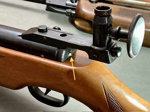

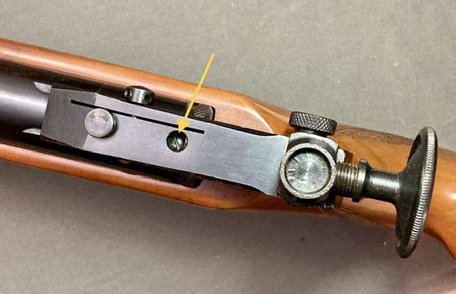

What is the purpose of the non threaded hole drilled in the base of the very early Weihrauch sight base?
Reactions: Bandito
The very first HW 55's had the same simple trigger as the HW 50 sporter rifle of the day. The gun has a sear-engagement adjuster screw on the rear of the receiver...
...and a locking screw for it on top of the receiver. You access that through the hole in the sight:
Unlike later guns, obviously the sight can go in only one position, so there's only one locator hole on top of the receiver. And thanks for asking...I'd never noticed this until just now! 😲
That is a nice unit, whoever made it.
I thought that it was Walther, but apparently it is not Walther or Anschutz?
Reactions: Bandito

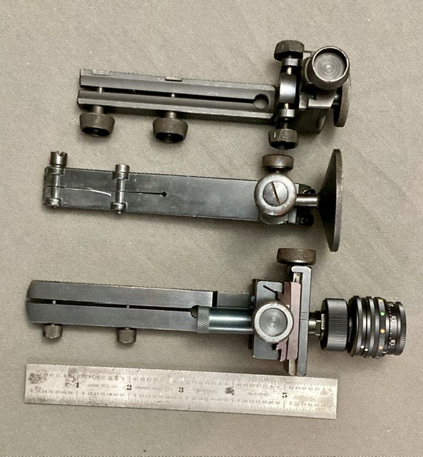

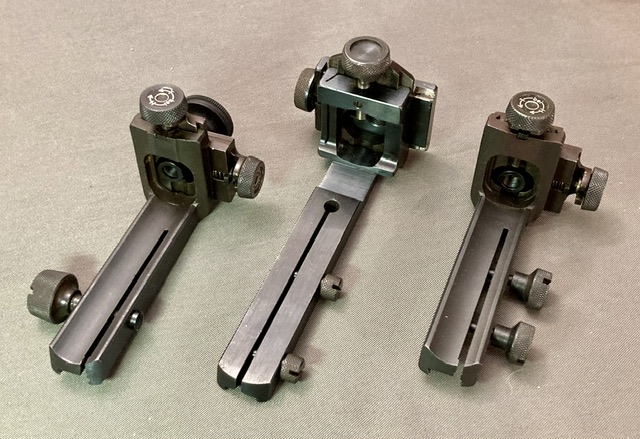

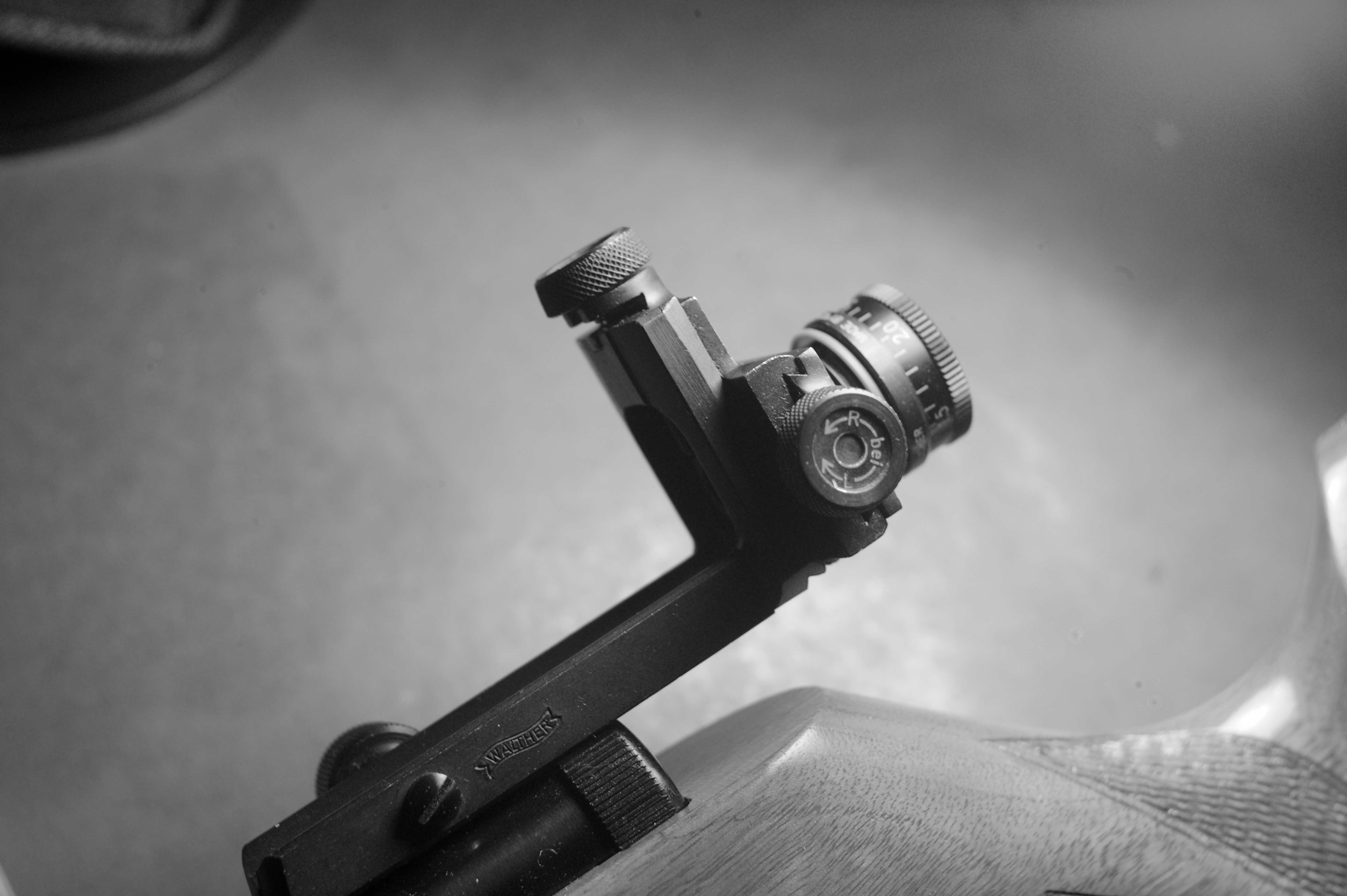

Here it is, flanked by steel Walther airgun (left) and firearm (right) sights. The elevation and windage sliders look like Walther ones on steroids (!) and with the windage knob on the opposite side. But the attachment details are quite different. The "mystery sight's" long dovetails are slightly narrower, and their closed ends make it impossible to mount on my Walther LGV (whose sight mounts from the front of the rail, to clear the receiver end cap).
Note also the short dovetails on the Walther airgun sight, allowing the rear of the sight to overhang the cap, and its sleeved clamping bolt which mates with transverse grooves in the gun's rail.
