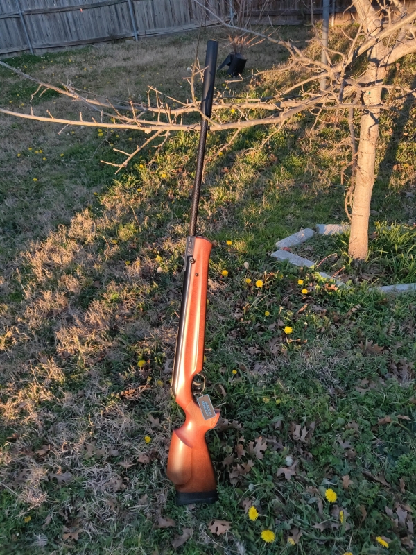

Intenseaty22’S Walther LGV Master Pro .177

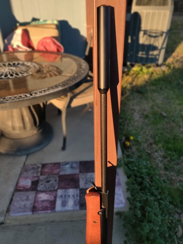

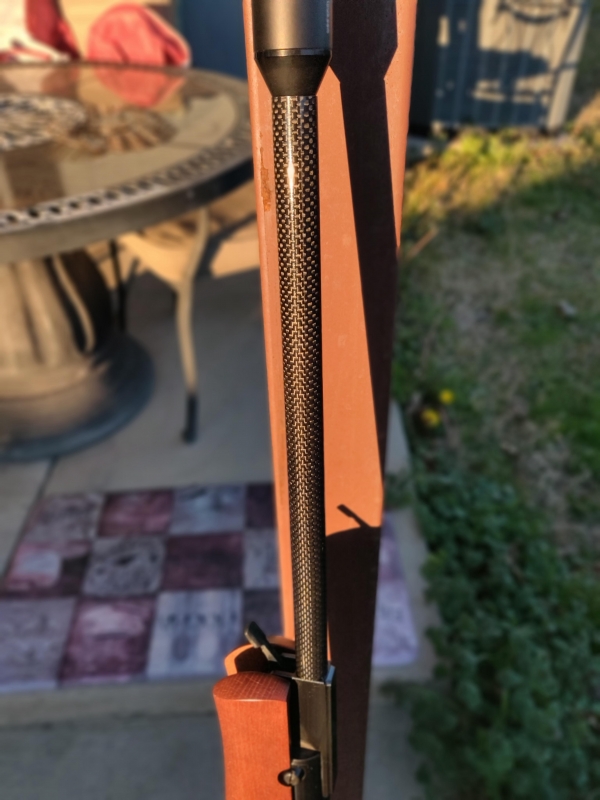

I like the look of that! What size of CF tube did you use? I really like the cone endcap on that Tanto too, so smoothly it transitions. As imitation is this sincerest form of flattery, I might just have to flatter that gun with my own.
Thank you, but I too I’m paying homage to someone else. This is a compliment to Centercut. He did this number on his Cricket, and I took it and ran. Here is the CF tubing you will need.
https://www.amazon.com/gp/aw/d/B00RX7TVVW?psc=1&ref=ppx_pop_mob_b_pd_title
The end cap can be ordered separately from DonnyFL.

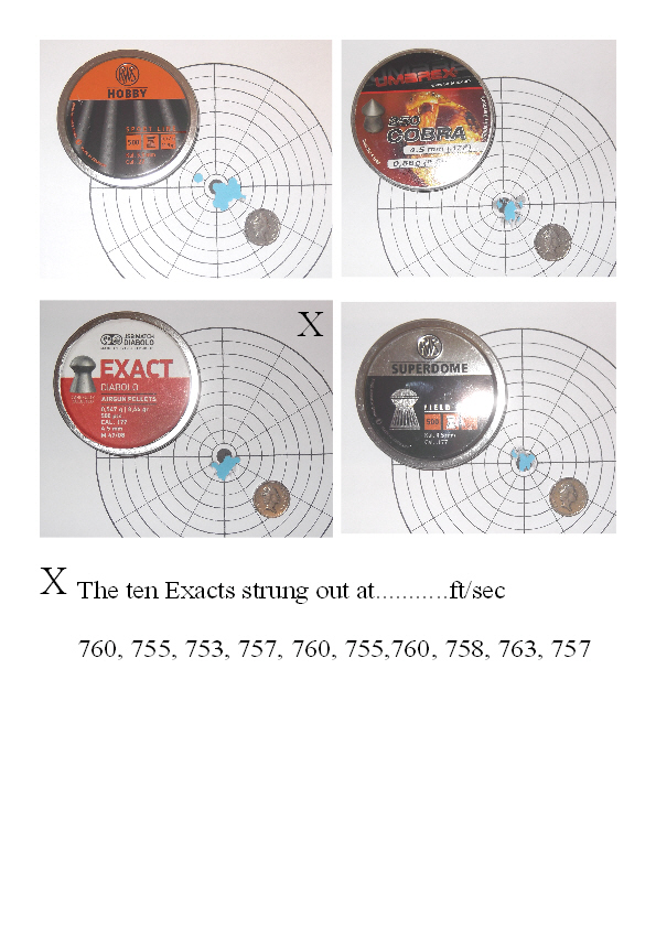

The German craftsmanship has certainly continued to impress me and the out of the box performance of the LGV has out shot my other three rifles by far but oh my what a weight! I was surprised by the long, soft, first stage of the trigger; which is plastic with only one adjustment screw. I have been given one of those replacement triggers that has two adjustment screws but will be waiting for the warranty periods to expire before building up enough courage do the swap my self.
Most of my shooting is done over a range of twenty yards in our back garden and I tend shoot ten pellets groups, as recommended by Tom Gaylord of Pyramydair. Just at present the gun appears to prefer RWS Superdomes but isn't too pellet fussy. I cleaned the barrel before even putting a single pellet through it but it was quite clean to start with.
Lest I have mislead you

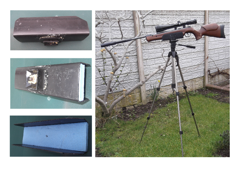

Once I had settled to bench shooting the LGV off a bag I gave shooting sticks a try but with the gun resting on the sticks at it's point of balance I found that the muzzle tended to wobble about and my shooting was quite poor and in fact no better than shooting the darned thing free hand; and that was bad. I eventually discovered that resting the stock with the sticks much further forward of the point of balance steadied my aim far more but I still need a lot of practice with the sticks.
Disappointed with my lack of real progress with the shooting sticks I decided to knocking up a rest from one of my old photographic tripods and a short piece of square plastic drain pipe. Early days yet and I still have a bit of a wobble on the fast release plate of the tripod but I think I can adjust that out.
