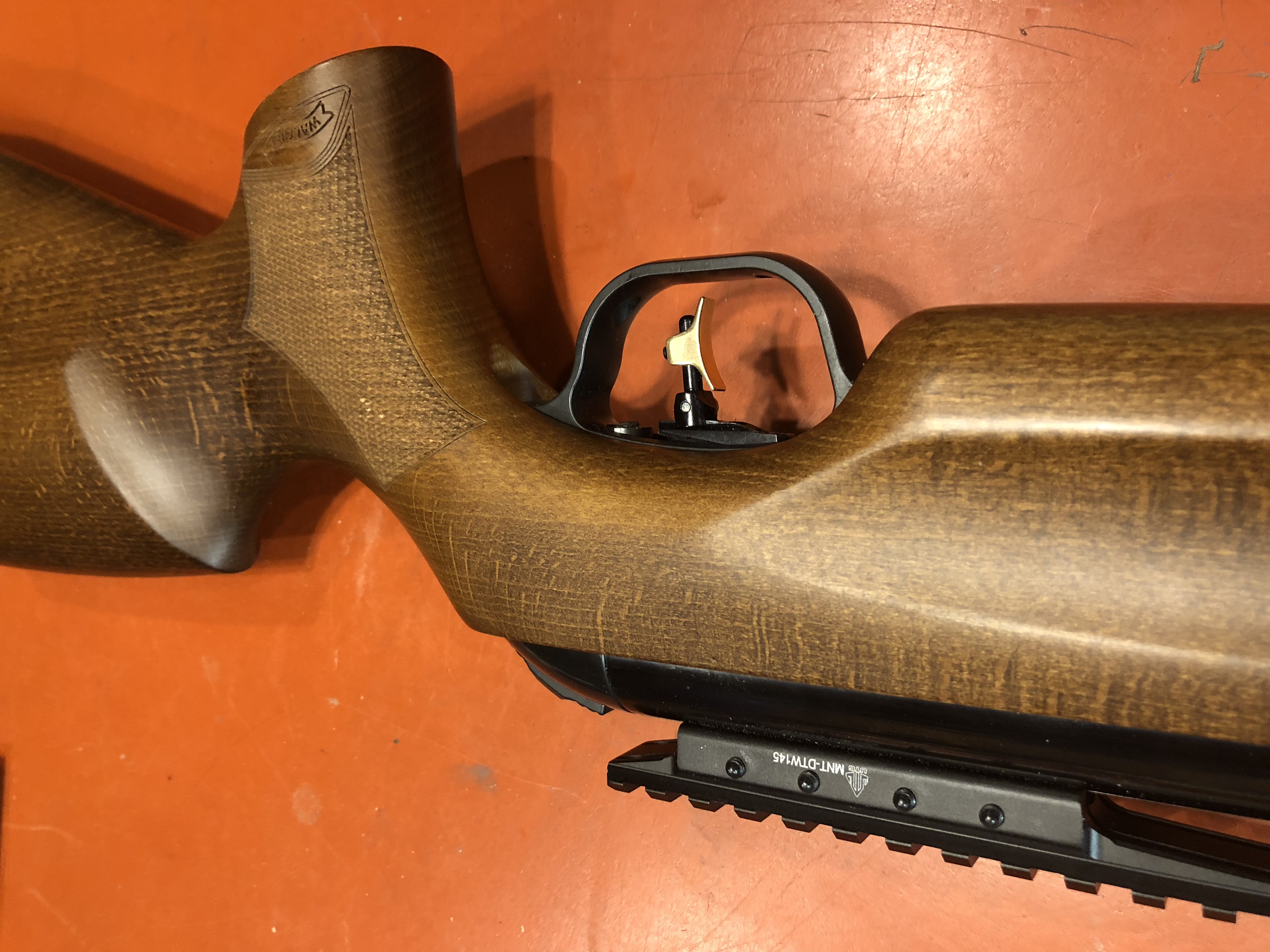

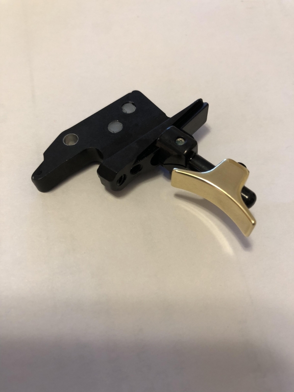

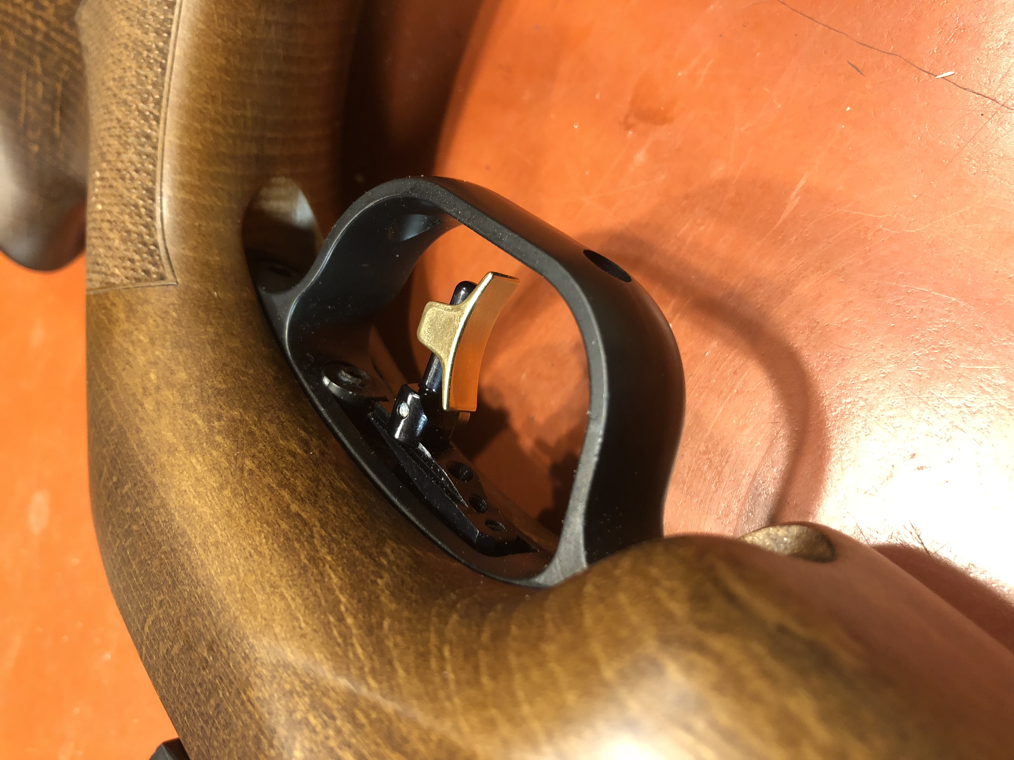

About the trigger. Yeah, looks sharp indeed. One thing I was not really expecting, most of it is plastic! I thought that if I was plucking that much cash for the darn thing, it was going to be maybe aluminum or something. Nope! Synthetic. I'm sure it's a good type of plastic, but.....plastic. except for the brass blade.

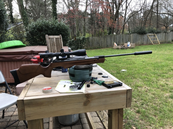

Yesterday was a beautiful afternoon with no wind. After work I was able to get some range time in with my LGV .177 12fpe. I’m really excited with her accuracy. I think I’ve found her pellet.
The only thing that I’ve done to her was clean the barrel, add a DonnyFL Tatsu and a ‘Yankee’ trigger tune. I had gotten fair results with JSB 8.44gr earlier. But this week I got some JSB 10.44gr in. Below are my two best 5 shot groups at 30yds rested.
Also, I need to eat some Crow here. The trigger is Aluminium not synthetic. Seems the paint/finish was so nice, it looked plastic. But, I’m pretty sure it’s metal now.
