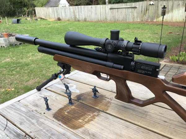

intenseaty22's G.A. Cricket Mini Carbine .
"douger"hey bud are those chrony numbers with the 14.3
Yeah 14.3, I'm trying to do one pellet at a time now. What I really need to do is to look for the optimal power setting / speed for each pellet while getting the best accuracy. But I have very limited time, 3 kids, and a wife, not to mention job, meetings, house, etc... But I will do what I can and keep posting as I go.

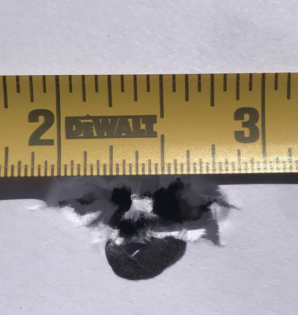

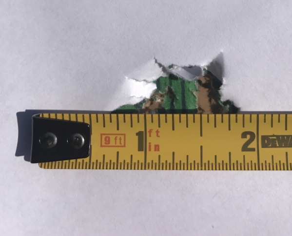

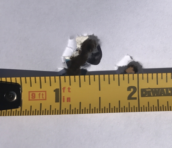

08/17/17 JSB Jumbo Diabolo 15.89gr at 30 Yards. Wind at 9mph, off bipod and bag.
30 Yard, 10 shot group, just under 3/4 inch.
30 Yard, 10 shot group, 1/2 inch.
Shot 2 strings of 10. Find data below.
1) 878 875
2) 878 875
3) 876 876
4) 876 877
5) 876 876
6) 878 874
7) 878 873
8) 876 873
9) 874 876
10) 876 876
Min: 873, Max 878, Average: 876, ES: 5, SD 1.5
I'm very impressed with these numbers I got today. Please keep in mind, this stuff is fairly new to me and I'm still learning. I shot other pellets today, but took full data on the JSB 16s only. At 30 yards, these are pretty much hole on hole. Will continue to post on different pellets as I go. Thanks.

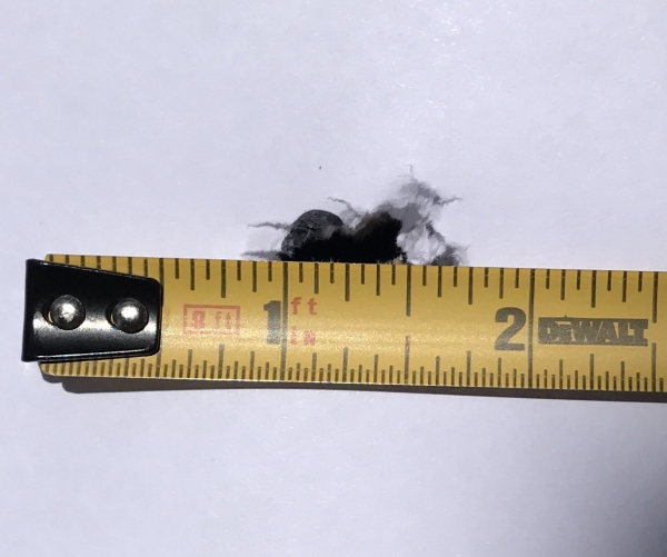

08/18/17 JSB Jumbo Diabolo 18.13gr at 30 Yards. Wind 10mph variable, off bipod and bag.
30 Yard, 10 shot group, just at 3/4 inch.
1) 856 855
2) 864 844
3) 841 849
4) 856 850
5) 849 849
6) 849 854
7) 847 855
8) 850 854
9) 853 853
10) 855 855
Min: 841, Max: 864, Average: 876, ES: 23, SD: 4.91.

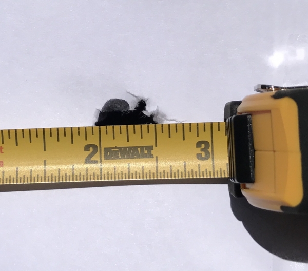

08/21/17 Eclipse Day. H&N Field Target Trophy 14.66gr at 30 Yards. Wind 6mph, off bipod and bag.
30 Yard, 10 shot group, just a hair under 1 inch.
30 Yard, 10 shot group, 3/4 inch.
1) 877 880
2) 879 880
3) 883 877
4) 882 878
5) 881 888
6) 874 884
7) 889 886
8) 880 878
9) 877 876
10) 881 876
Min: 874, Max: 889, Average 880, ES: 15, SD: 6

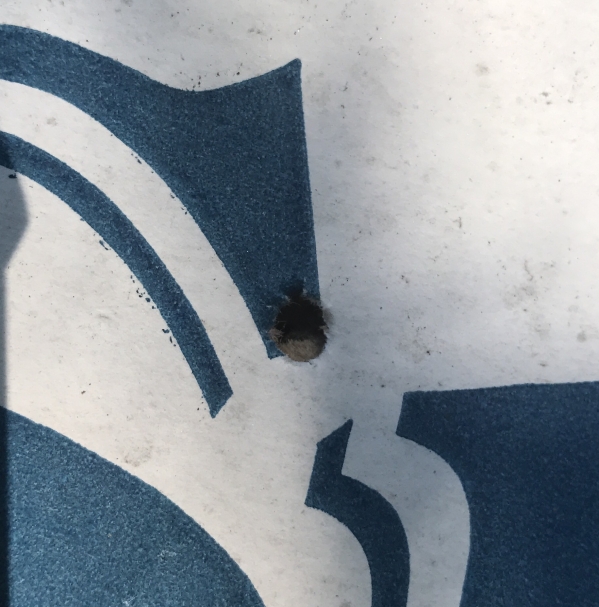

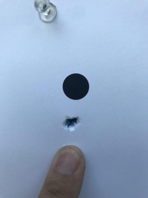

About those JSB 15.89s
I put my crosshairs right at the tip of this S. This is a single shot into that tip.

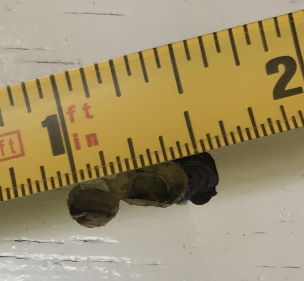

These are 3 shots into a piece of 2x6 I use as a backstop. I aimed at the black dot to the right. All three shots fell into a 5/16 group.
Needless to say the JSB 16gr are by far the best shooting pellets I have put through the Mini so far. The chrony numbers are also the best I have seen since I have been Testing pellets. These will probably be my go to pellets when absolute precision is required, followed by the CPHPs for general pesting and plinking. If penetration is needed I think the H&N hornets will do a fine job as well as the Polymags. Will try and do chrony strings on those when I can and continue to post here. If you own a Mini, and have a favorite pellet, let me know to see if mine likes it as well. Cheers!
