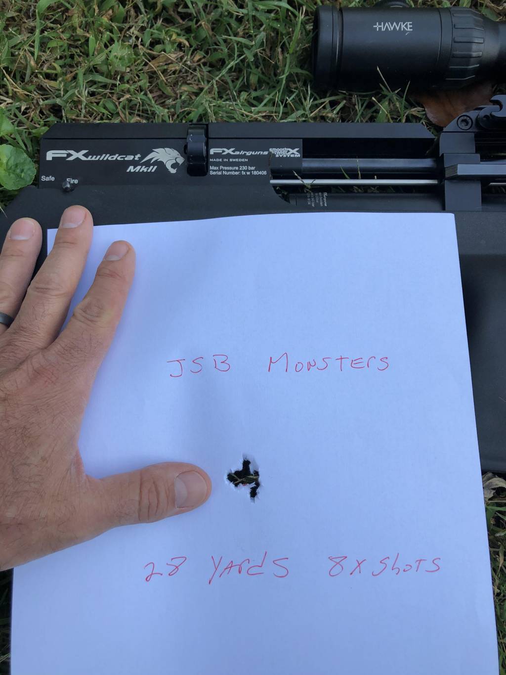

And then there’s this. Shot a whole magazine (8 shots) on a whim, Crosman Premier 10.5gr brown box.
Well that looks a heck of a lot better. Is it repeatable?
Yes it does. Repeatable remains to be seen. I have noted decent repeatability today, specially with the Monsters. I’m looking out for chipmunks as we speak.
What I don’t care for is the apparent over pressure of the reg. Looks like the spring cant keep up. I’m thinking about backing it down again. Maybe to 105.
What was the one more thing that you tried, Christian?
Well, not sure if maybe the glue on the Carbon Fiber liner cured? That was one of the last things I did. I also put the reg down to 110, but nothing else really. I will say though, the gun showed promise with the Barracudas I had, but those were 4.5s, I had a feeling about it, so I bought 4.52s and they do really good. But that does not explain the shift in POI or lack thereof. Will try and test more tomorrow.
