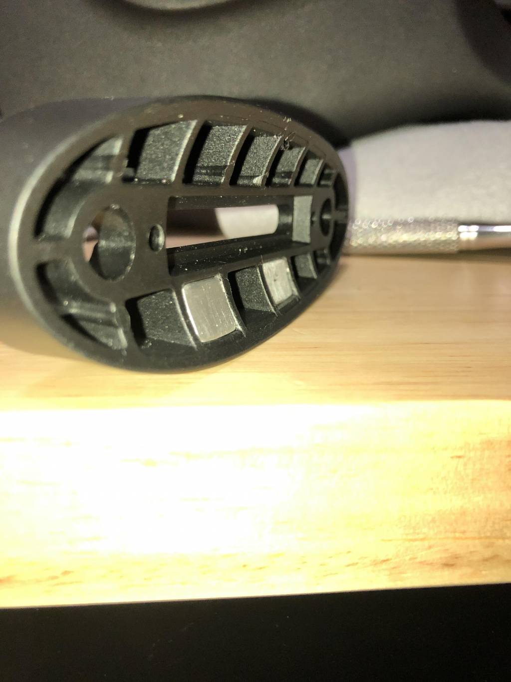

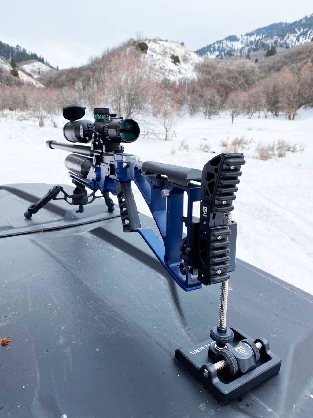

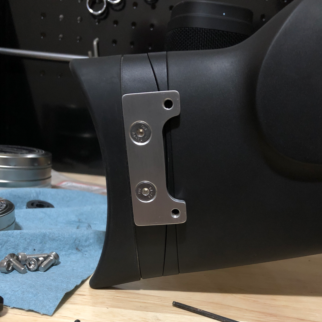

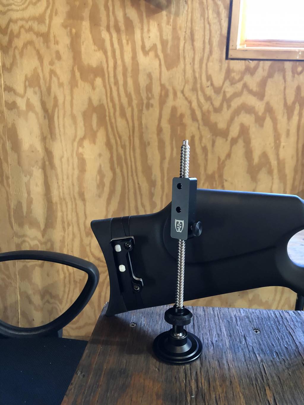

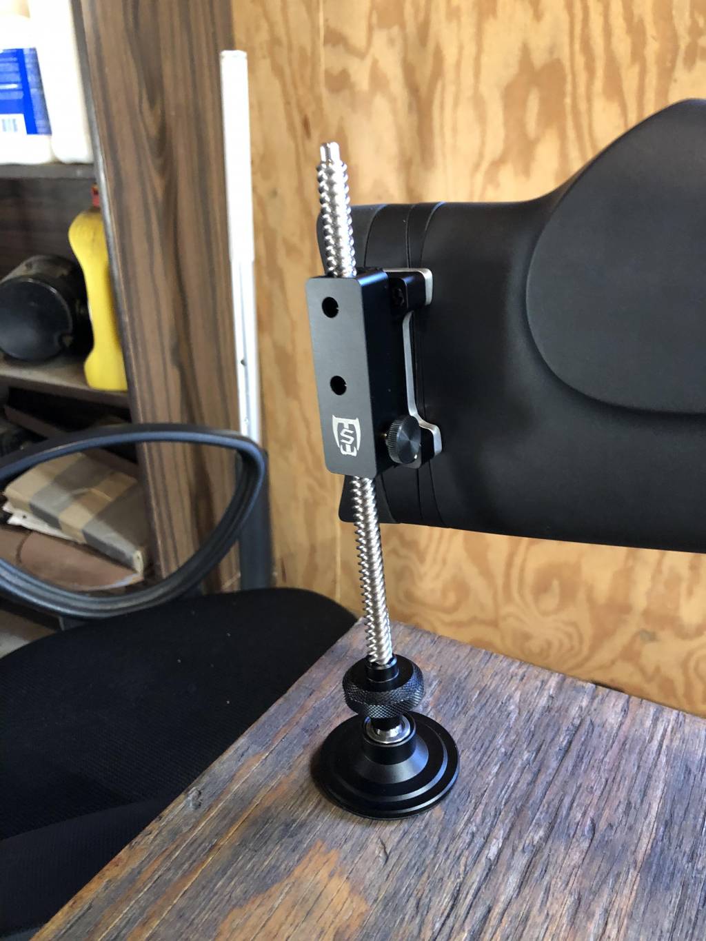

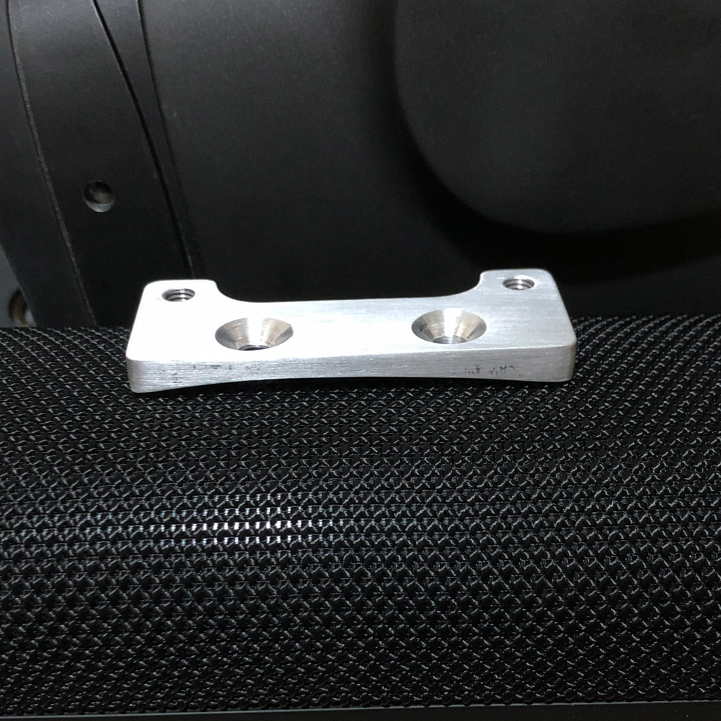

I’ve been using the Saber Tactical Bench Monopod on my M3 Impact and I really like it. I’m seeking a creative and elegant solution to attach the monopod to the butt of my Daystate Redwolf. Saber tactical sells extra mounts (meant for a 2nd FX impact) that allows marriage of the monopod to a 2nd air rifle.

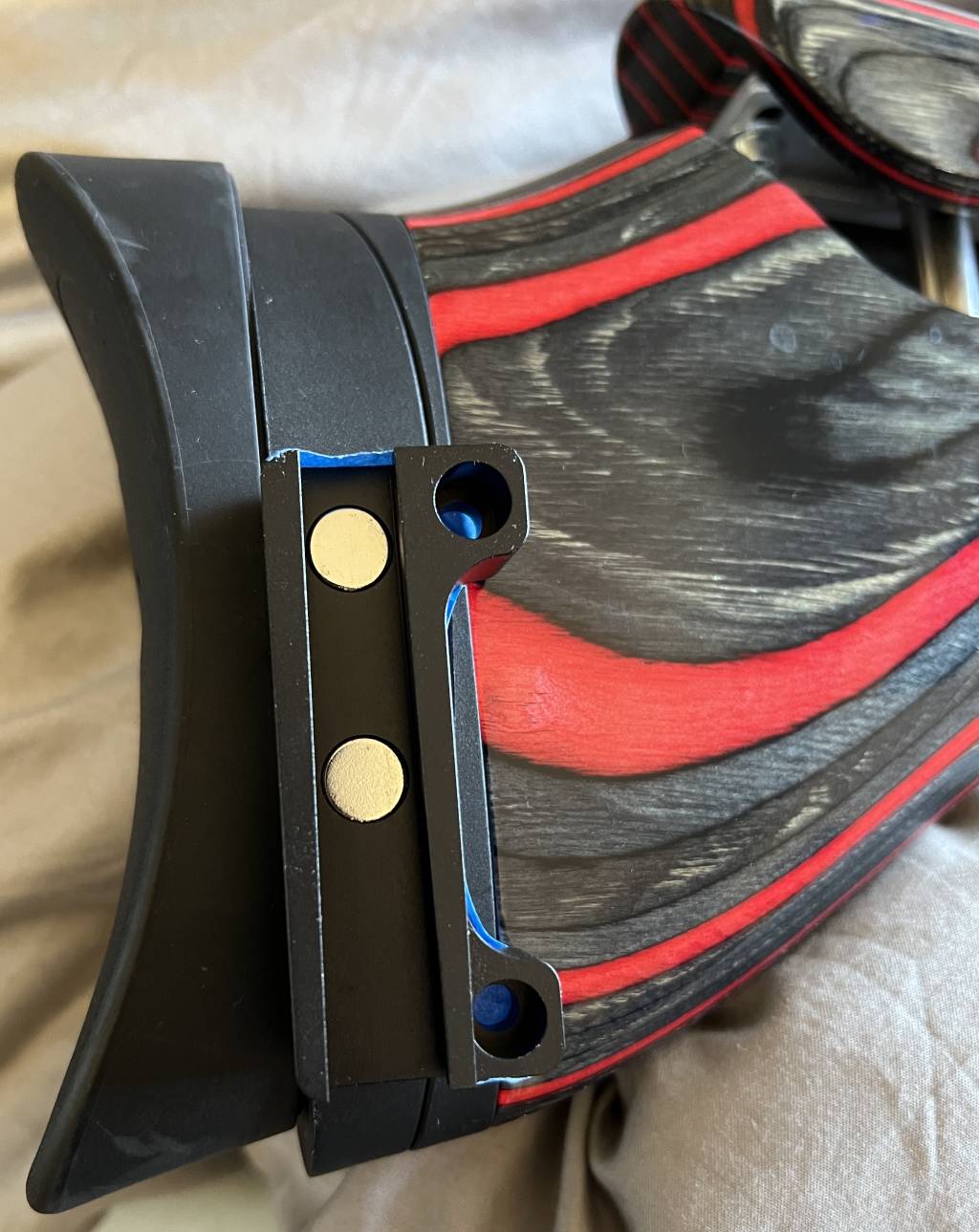

I’m not mechanically inclined so am asking this forum for some ideas/help/suggestions. How can this be done?

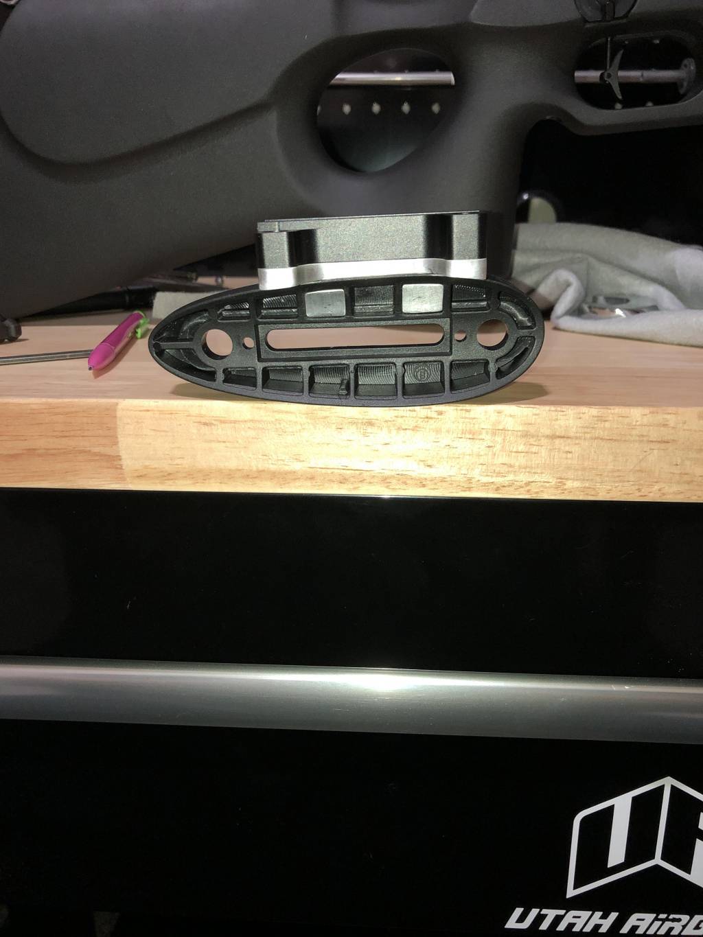

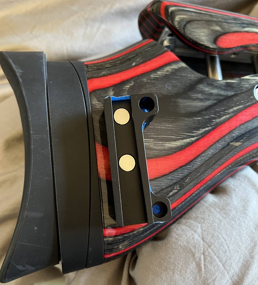

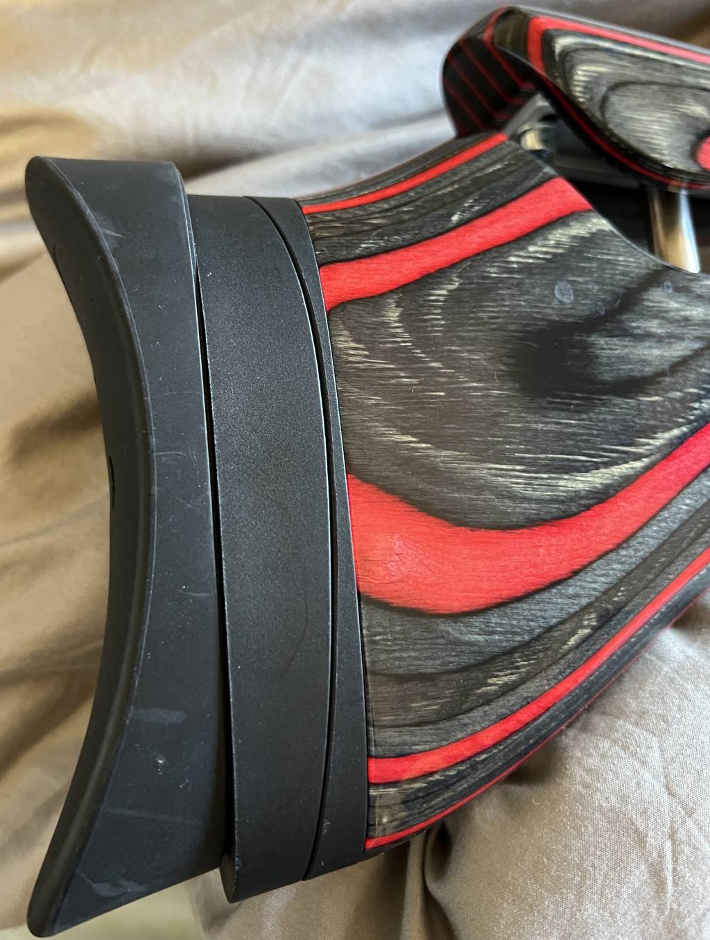

Some thoughts:
- Drill into the Red Wolf wood stock (Not too high on doing this!)
- Drill into the plastic/composite adjustable butt portion. Thoughts on stability. No idea what is inside the adjustable plastic butt stock
- Install some sort of bracket in between the wooden butt and the composite adjustable butt stock that the Saber Tactical bracket could be attached to.
