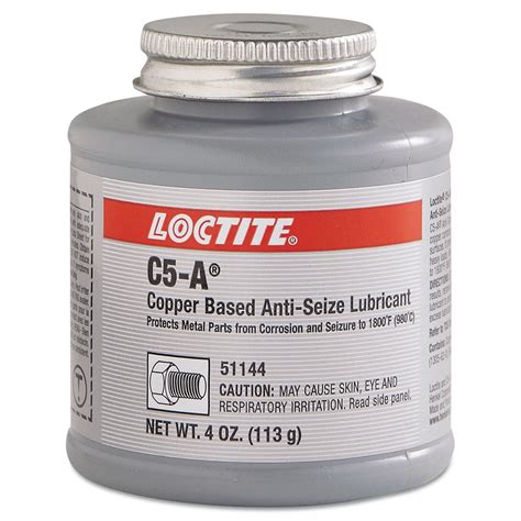

This is the grease I bought it looks like it will be just fine. I paid $13.24 with tax and it should last me forever LOL.
