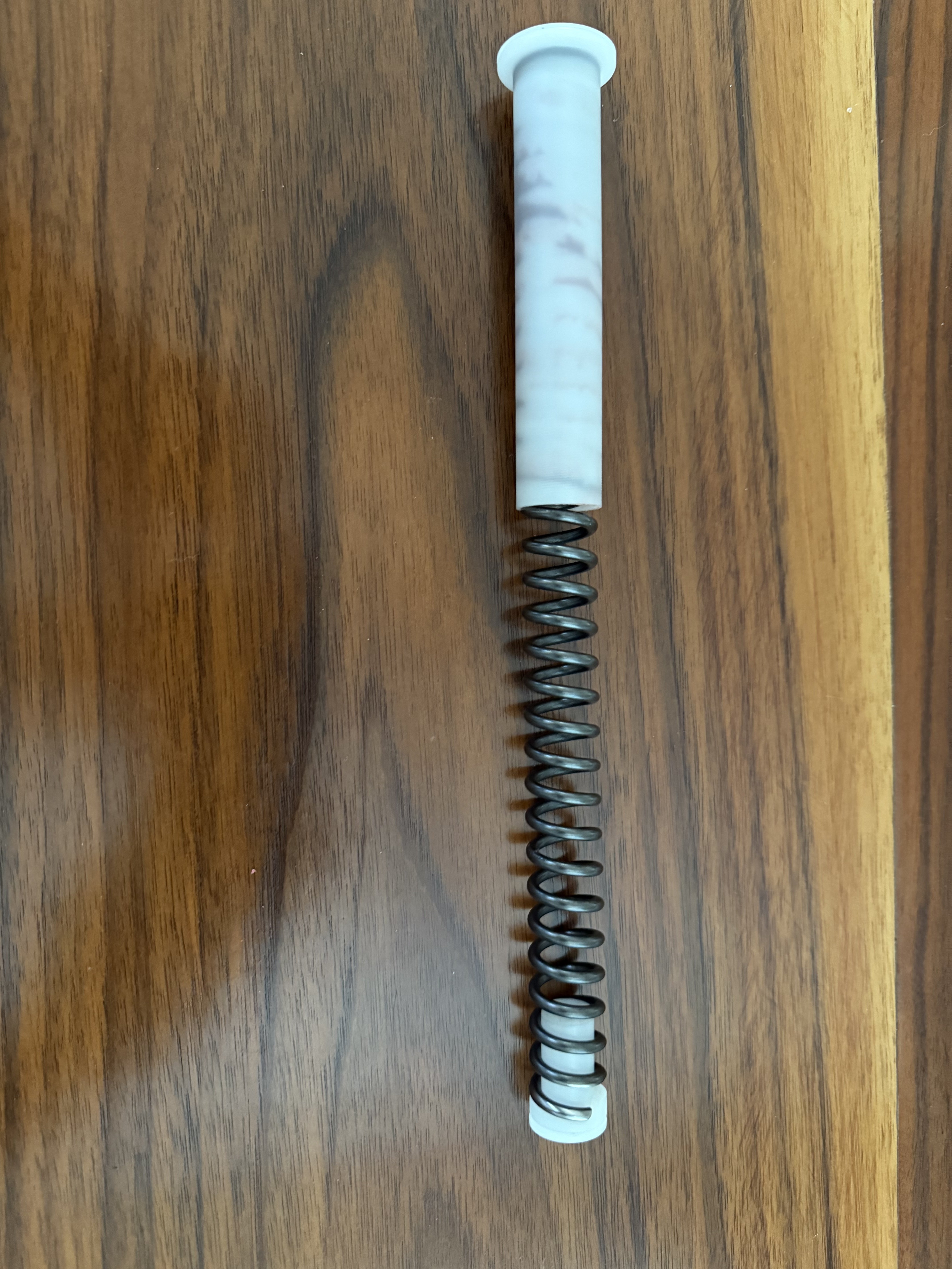

Air Arms Installed Vortek PG4 Delrin kit in TX
I had previously installed a TbT delrin guide kit in my TX200 .177, with stock spring and Vortek piston seal. It shot at 13 fpe but I felt the shot cycle could be better, it was still hold sensitive also. The Vortek seal will remove 40 fps off the bat.
I got the PG4 delrin full power kit, I had to push down on the rifle, while my wife put the bolt in the trigger block. With the stock spring, I can do this myself.
I put 50 pellets through it(JSB 10.3) and it averaged 728 fps, 12 fpe. I hope it doesn’t drop anymore? I have read the full power is closer to 12 fpe and the low power closer to 10 fpe? I have not accuracy tested yet.

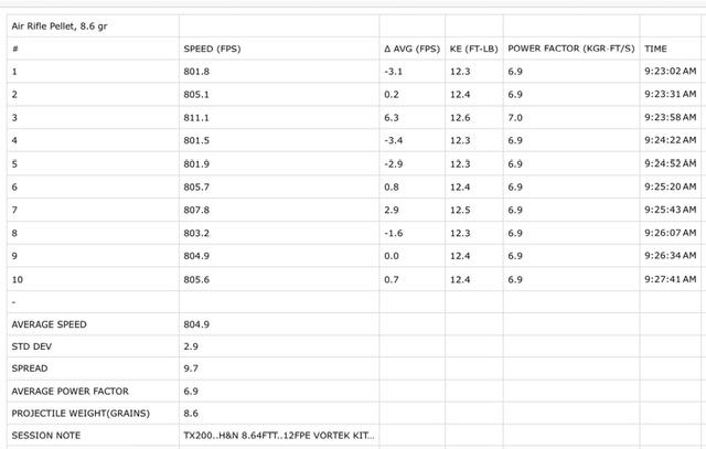

Motörhead gave me a used 12fpe VORTEK kit for the TX200. I put it in TX200 #3 (walnut), (the one my friend in Kansas gave to me when he was not able to replace the cocking shoe). I plan on shooting short range low powered air rifle/air pistol silly wet at the Diablo range.
It is very consistent:
Very nice

I have the PG4 kit in both my RSW Diana 48 and HW97k. The std kits, not full power kits; but installed both enclosed washers in both rifles. Super easy to cock, smooth and easy shooting. Powerfull! Highly recommend! My great grandchildren will enjoy shooting these springers!
Mine did not come with spacers, even though the directions mentioned them.
I did chrono the FTT 8.64 and it shot at 810 fps, not bad 12.6 fpe.
