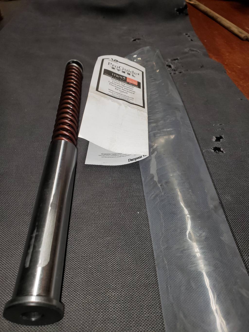

Installed the new steel PG4 Vortek HO tune kit in my TX200.

rwsmike, It was quite simple to put in. As I have read and seen the TX200 is perhaps the easiest springer gun to work on. The kit comes with a few simple instructions so just read them and follow them. Be sure and tap out the stock steel top piece that sits on top of the stock spring in the piston as the gun will not cock if you leave it in. Some will just drop right out but mine required I tap the piston stem in my hand and jar it out. It was stuck in the piston by the lubricant.
