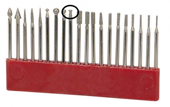

I would recommend that when you take it apart again to replace the rings, you use a small file, if you have one. Or if you are steady handed, use a dremel with a small grinder wheel on it and go inside the gauge block hole and file away the burr left behind from the stamping of the hole. You will find that isn't the only hole with burrs so you might decide to work on those as well.
But your problem can be handled with a little bit of gentle work with a fine file. (or dremel). If you stick your finger in the hole and feel for the burr, you will find it. If it is nicking your rings, it is probably pretty sharp and easy to find. For myself, I just dressed the entire circle. But be careful. You don't want to take too much off. Just dress away the sharp part.
Also, when reinstalling, lubing the rings gently is good. As the first ring comes to that gauge hole, smash your thumb on there as if to hold the rings down as they pass. Especially as they go past the back of the hole, which is probably where the burr is.

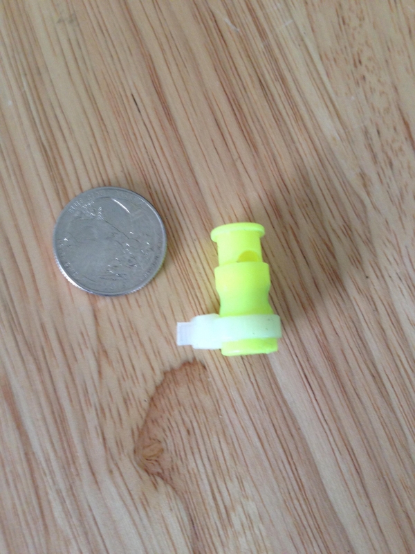

I just cover the gauge hole with this, it's a plastic stop off the end of a sweat shirt that fits into the hole, the zip tie keeps it set at the correct depth. I also use pvc cut to the length as a stop so that the valve cannot go past onto the cut outs for sear & bolt.
Nice idea. Something like that would work. I do have to say though, that once I cleared the holes of burrs, mine slid right into place. Not a single nick and no leaks at all. In fact I put 2500 psi in it after the repair, which was about first week in January. Checked it a couple of days ago and it is still on 2500. Not bad for a Gen 1.. :) btw, still for sale.

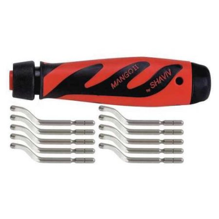

Yeah right, that is definitely scorching. I did the same with my .22 MROD, before installing the Hill high performance kit and deburred the port hole with a deburring ball included in his kit, and also plugged the hole with my thumb anyways as Crusher mentioned with zero leaks after airing up to about 1000 psi. I also use a deburring
tool made by Shaviv for similar jobs.
