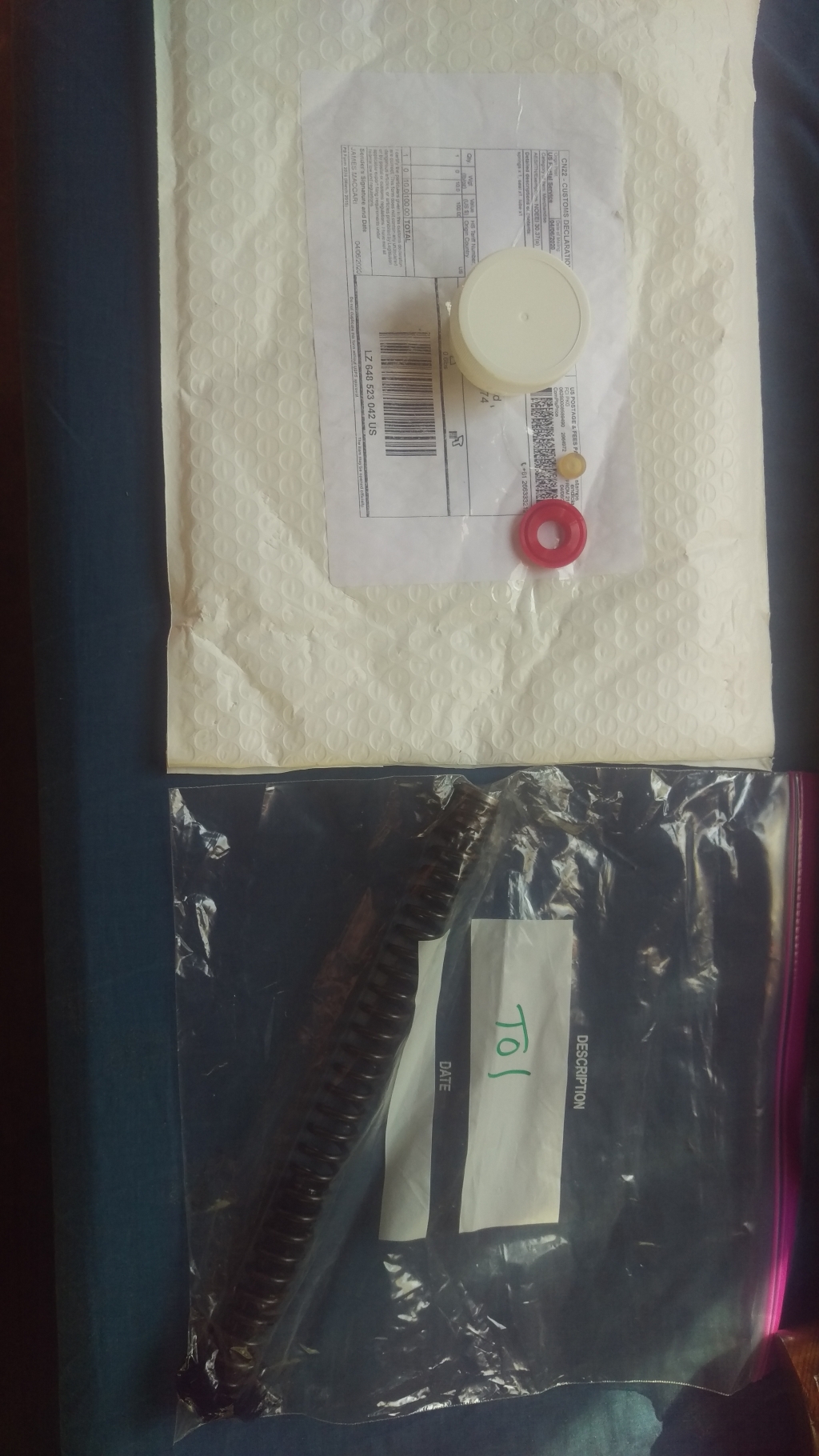

This is an install of a James Maccari ZRT tune kit in my Diana 52 .177.
I received the kit on 23/4/20 from the US, despite the pandemic.
https://youtu.be/46ZJrvAFgYg

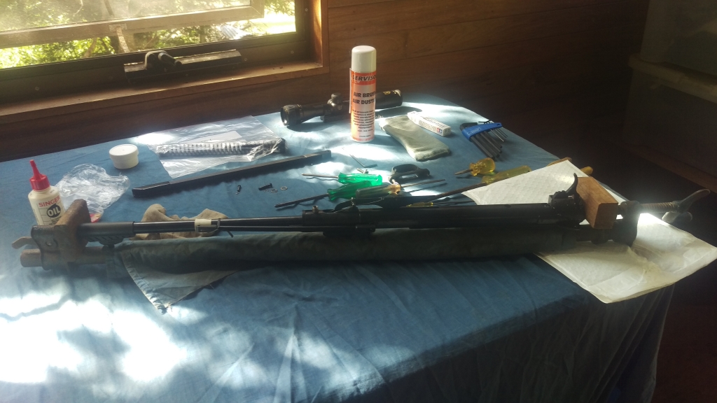

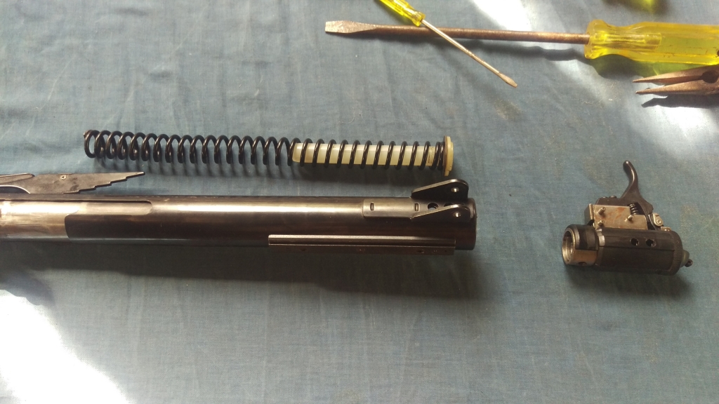

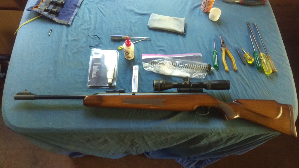

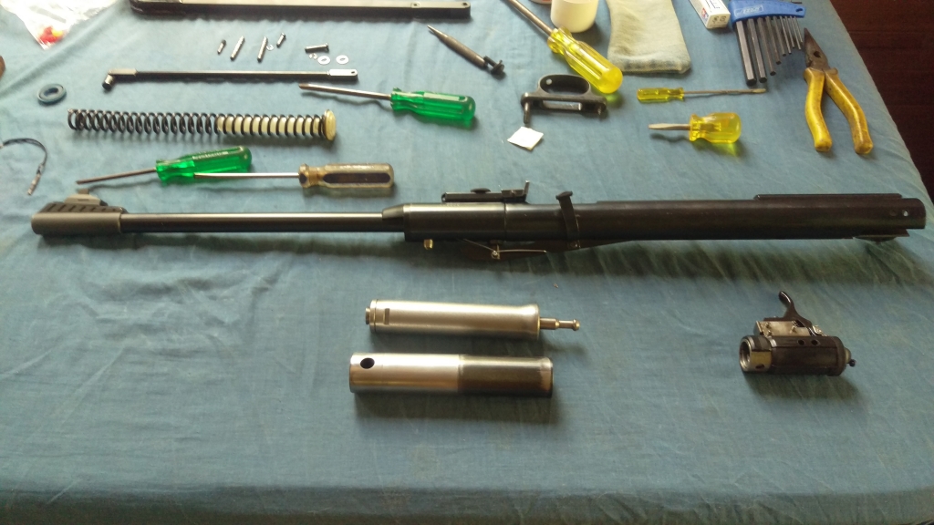

First off you see my rifle.
Then the kit as received plus piston seal and breach seal which are in addition to the kit.

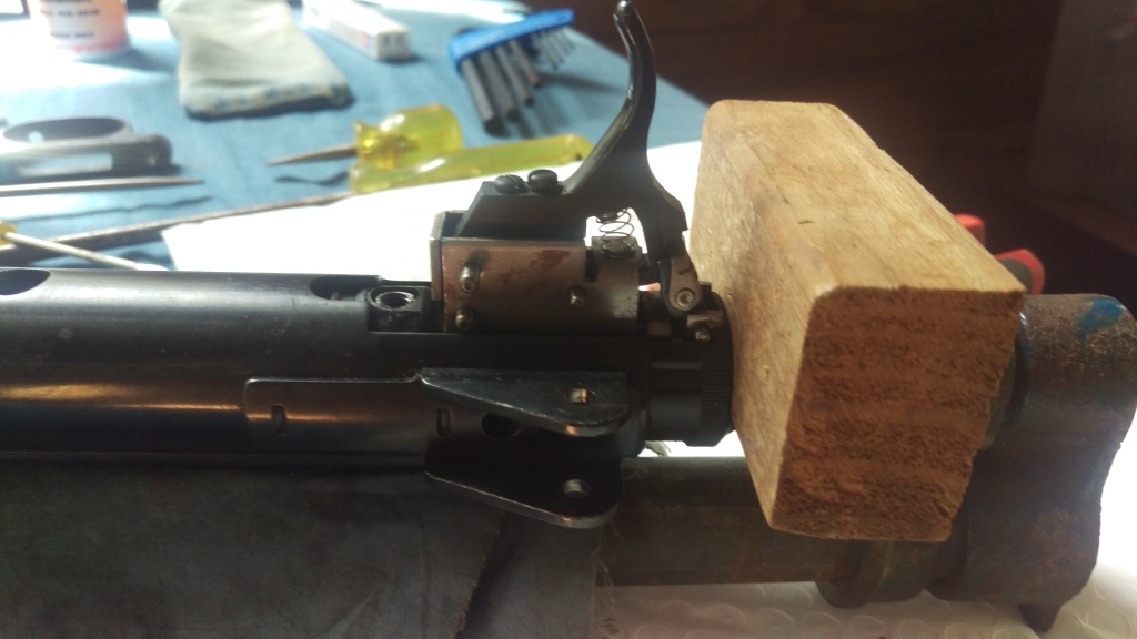

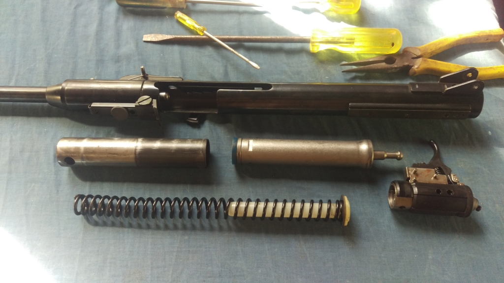

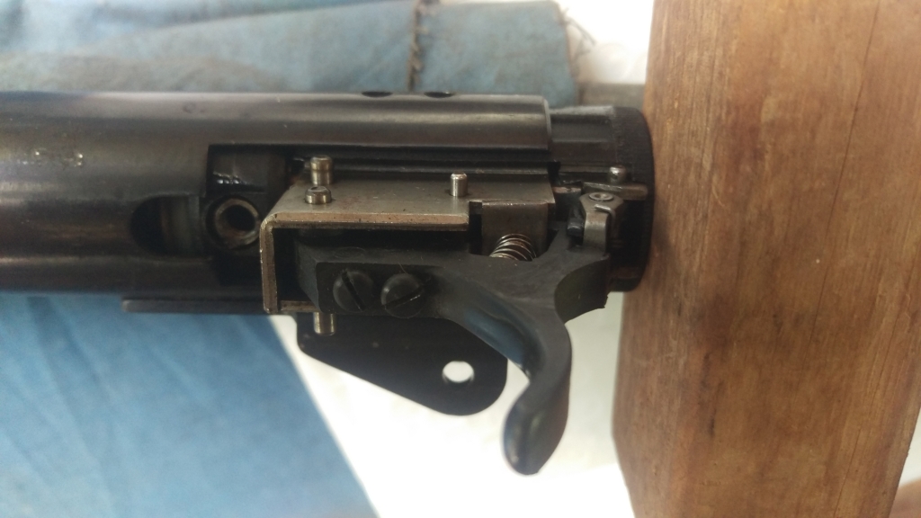

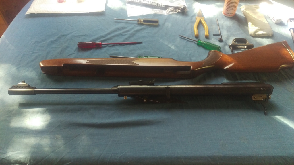

Then the disassembly views.

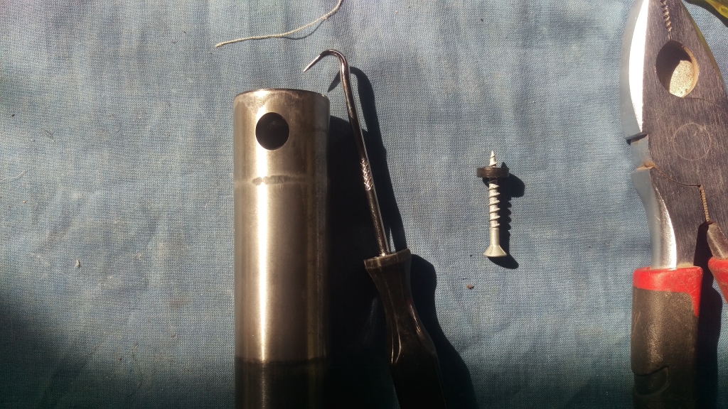

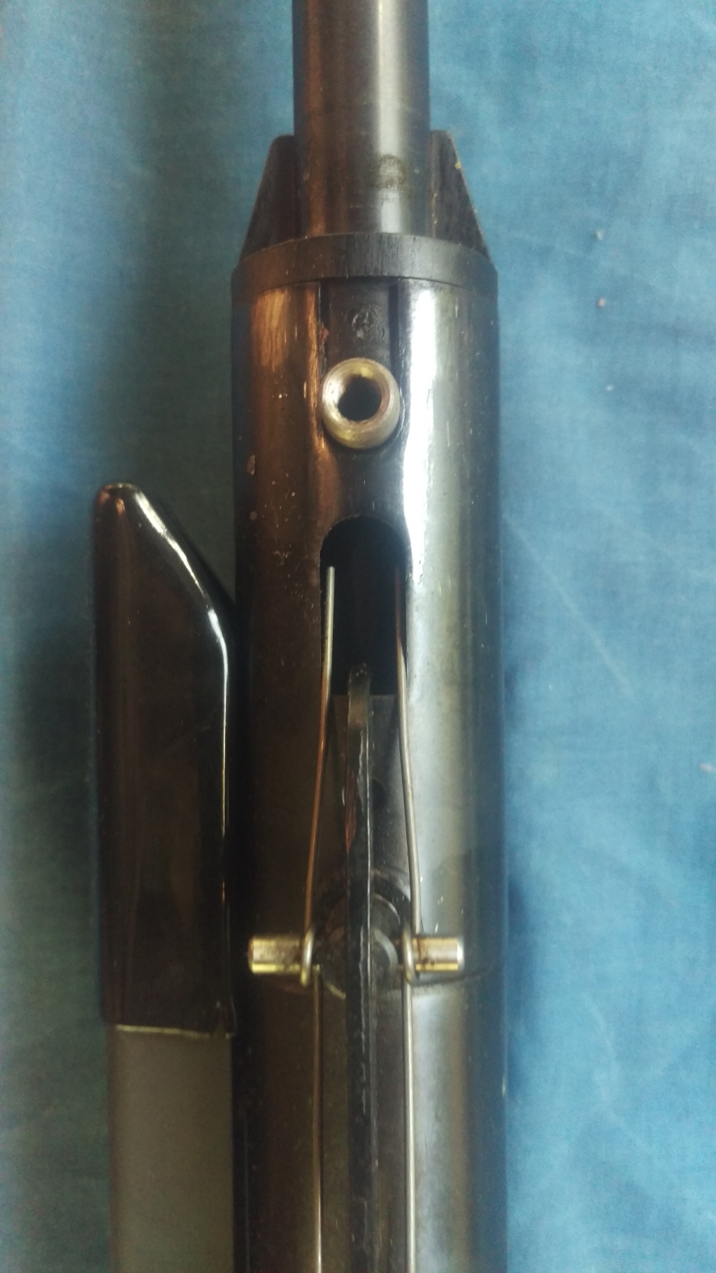

The view of the screw through the old breach seal is a trick I got from
Airgun Maintenance
https://www.youtube.com/channel/UChzNNYdBrDAjbjIHf5UouCg
It is in Arabic I think so couldn't understand the speech but a video tells more than a picture.
Any way it worked, I found the right sized wood screw.
Screwed it through the breach seal carefully then was able to pull out the seal from where it is seated. Then used a pic to get it all the way out.
Then used his technique of using the rod at the back of the piston to seat the new breach seal.

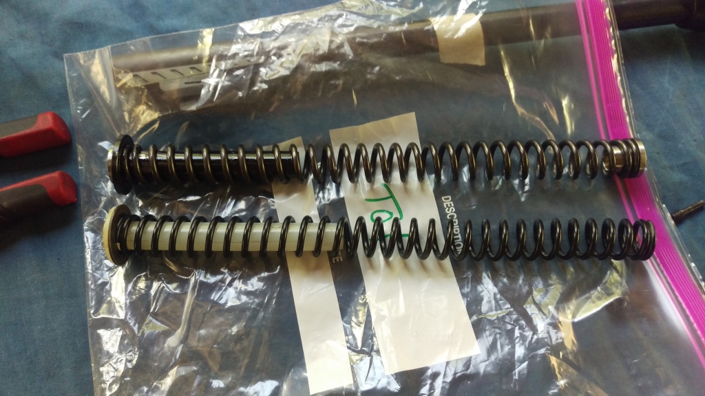

Then the old and new springs.
Then all cleaned and hand polished ready to assemble

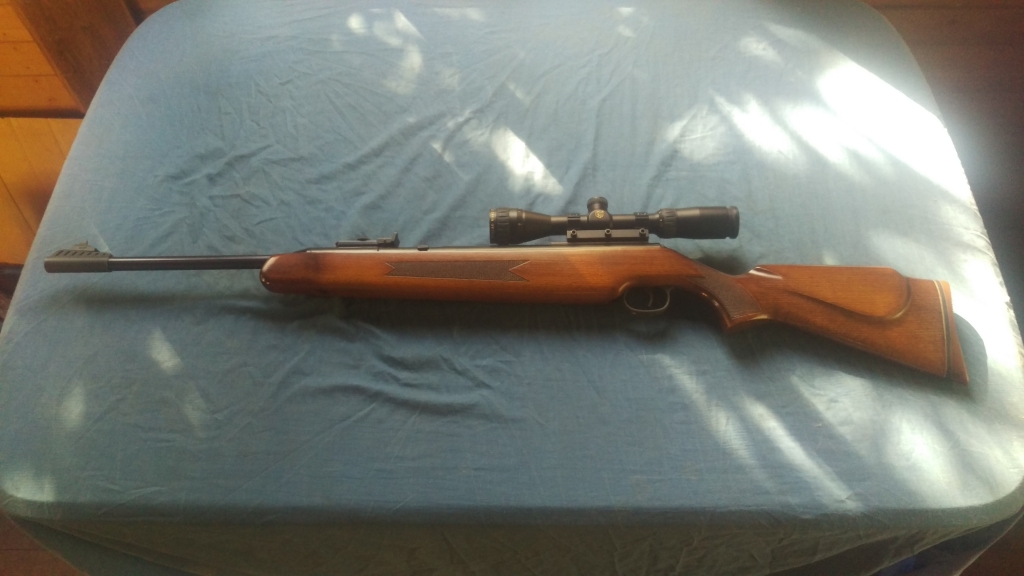

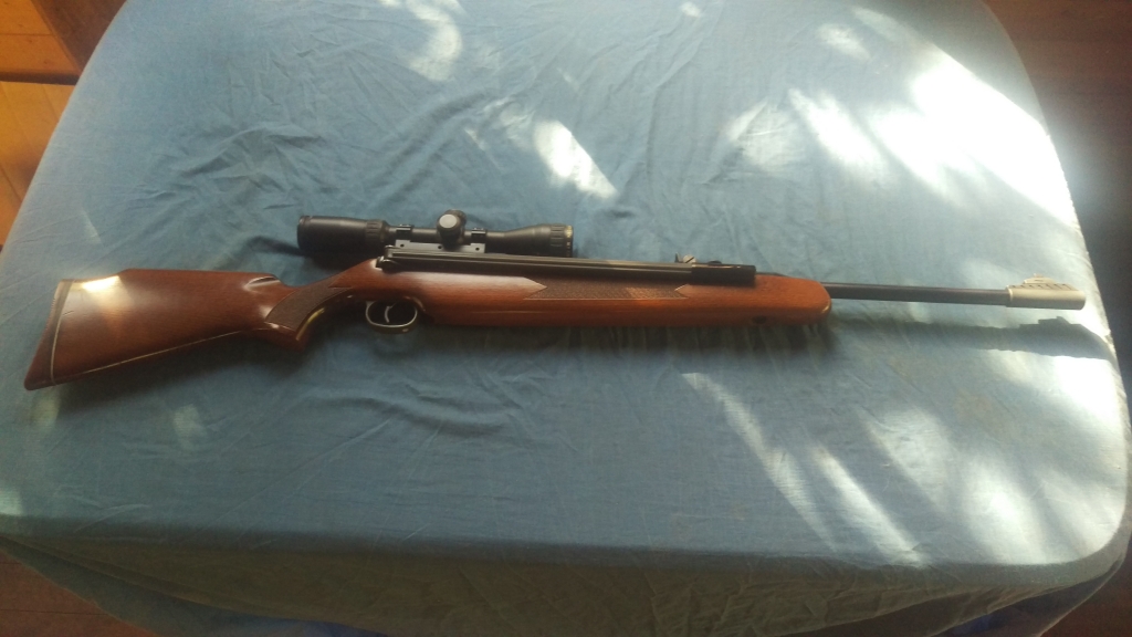

Then the finished rifle.

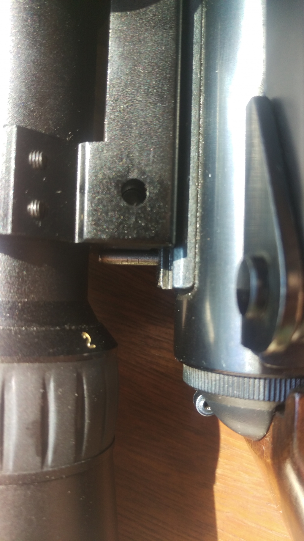

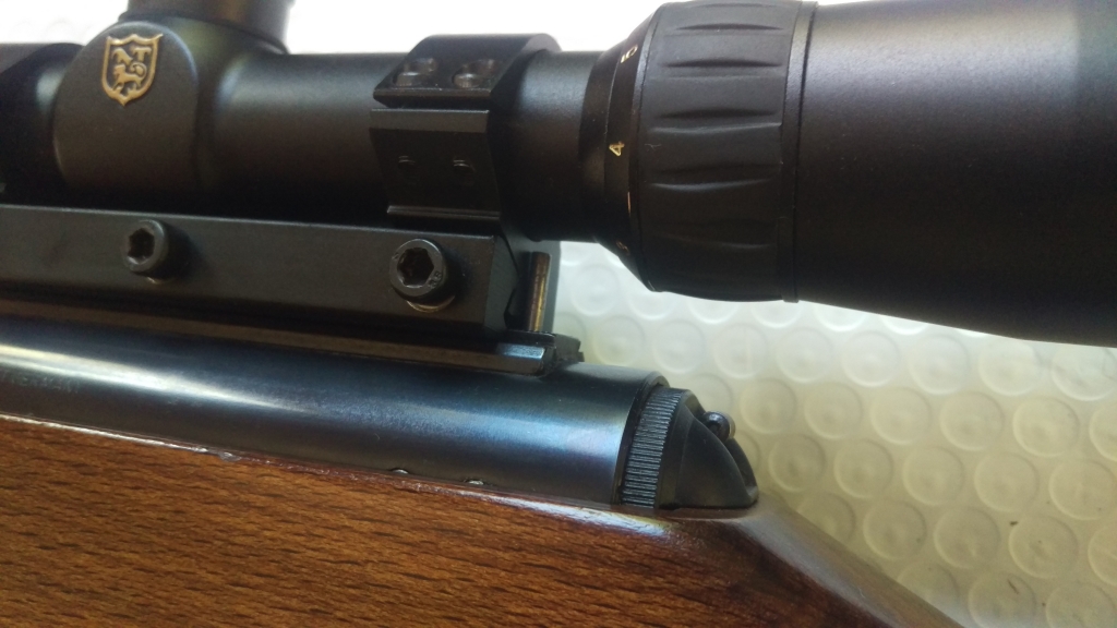

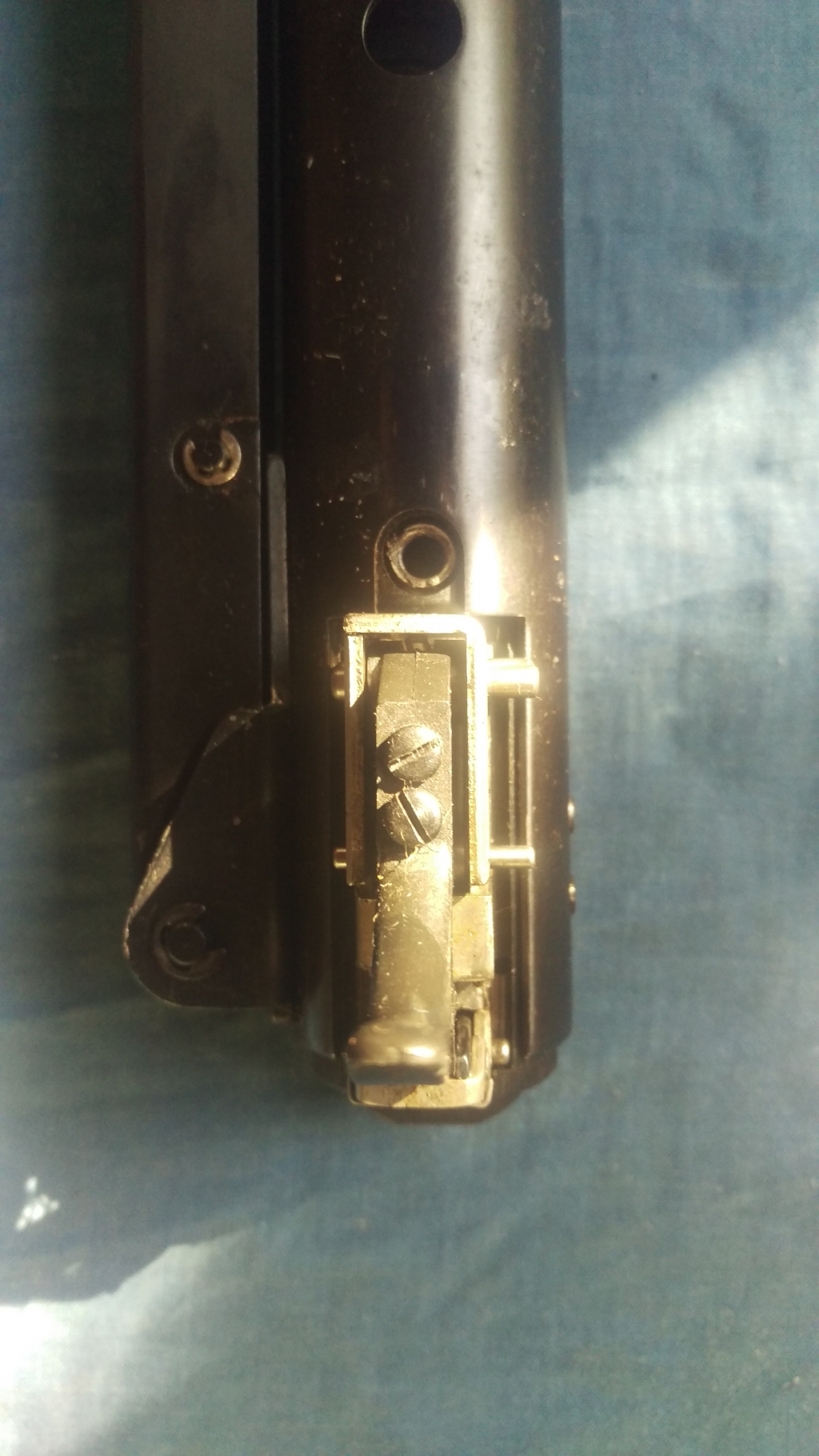

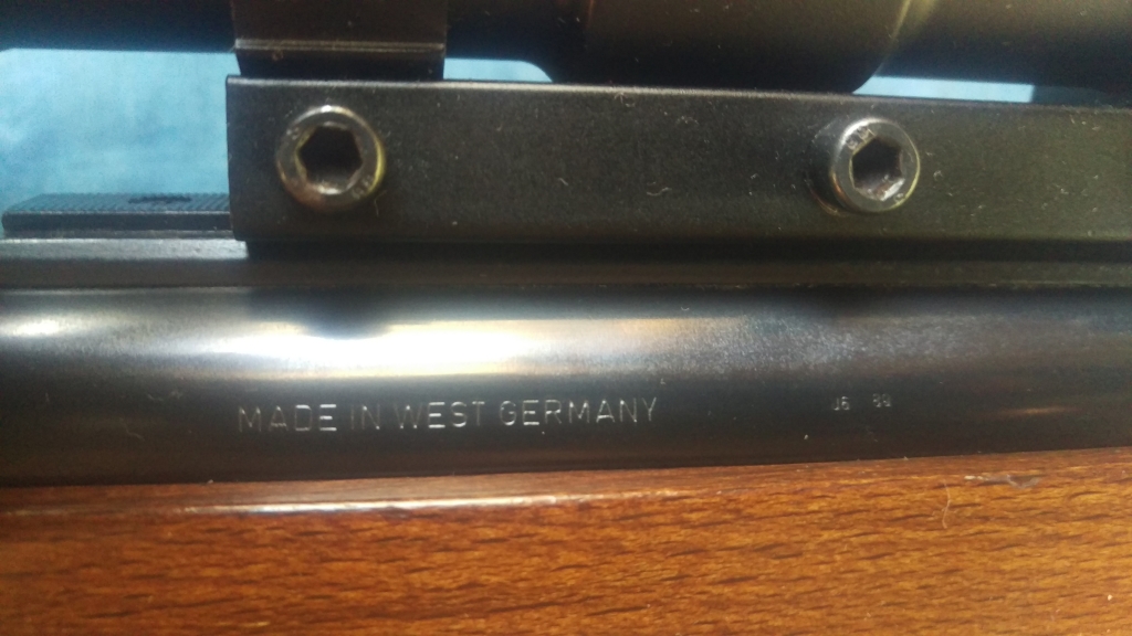

At the end you can see my solution to the scope mount moving.
There is a hole at the back of the scope rail on the rifle.
I found a drill bit that's 2.75 mm in diameter that was an interference fit in the hole.
So I cut a piece off the drill bit and tapped ( as in banged) it into the hole.
Very tight fit so will see if it lasts. If it vibrates out I will locktight it in position.
So far so good after shooting a few pellets.
Scope hasn't moved as yet.
The gun cocks smoother and seems more accurate.
Early days yet as it needs to wear in.
