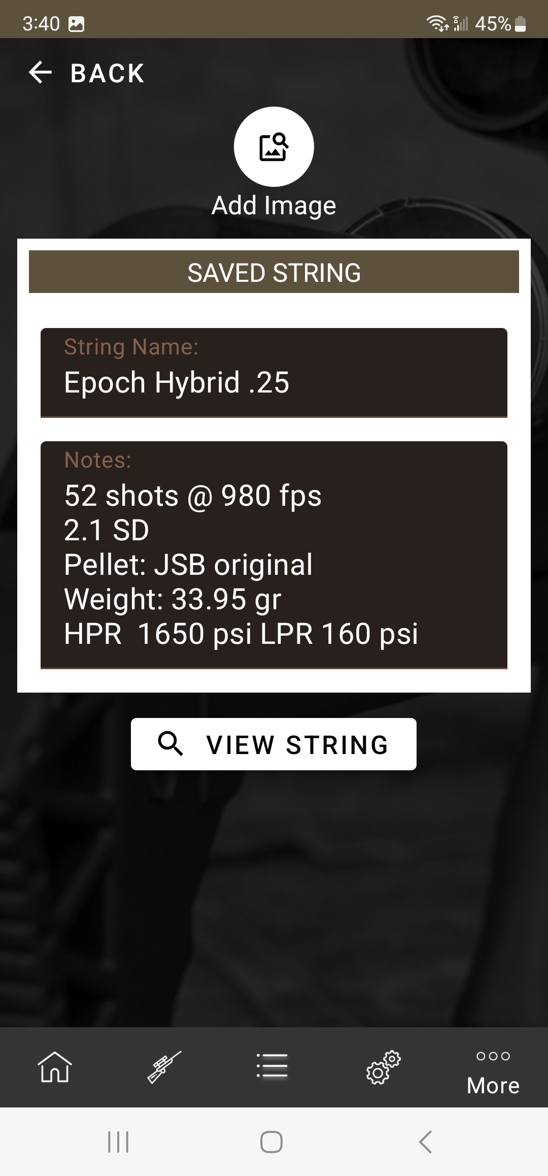

The Epoch doesn't rely on its plenum to supply its power. For example here us a typical string from my .25 prototype

The Epoch doest rely on its plenum size to generate power, rather it employs a large (HUGE by comparison) pneumatic valve to pop open and shut very quickly enabling it to be not only air efficient, but very precise.
