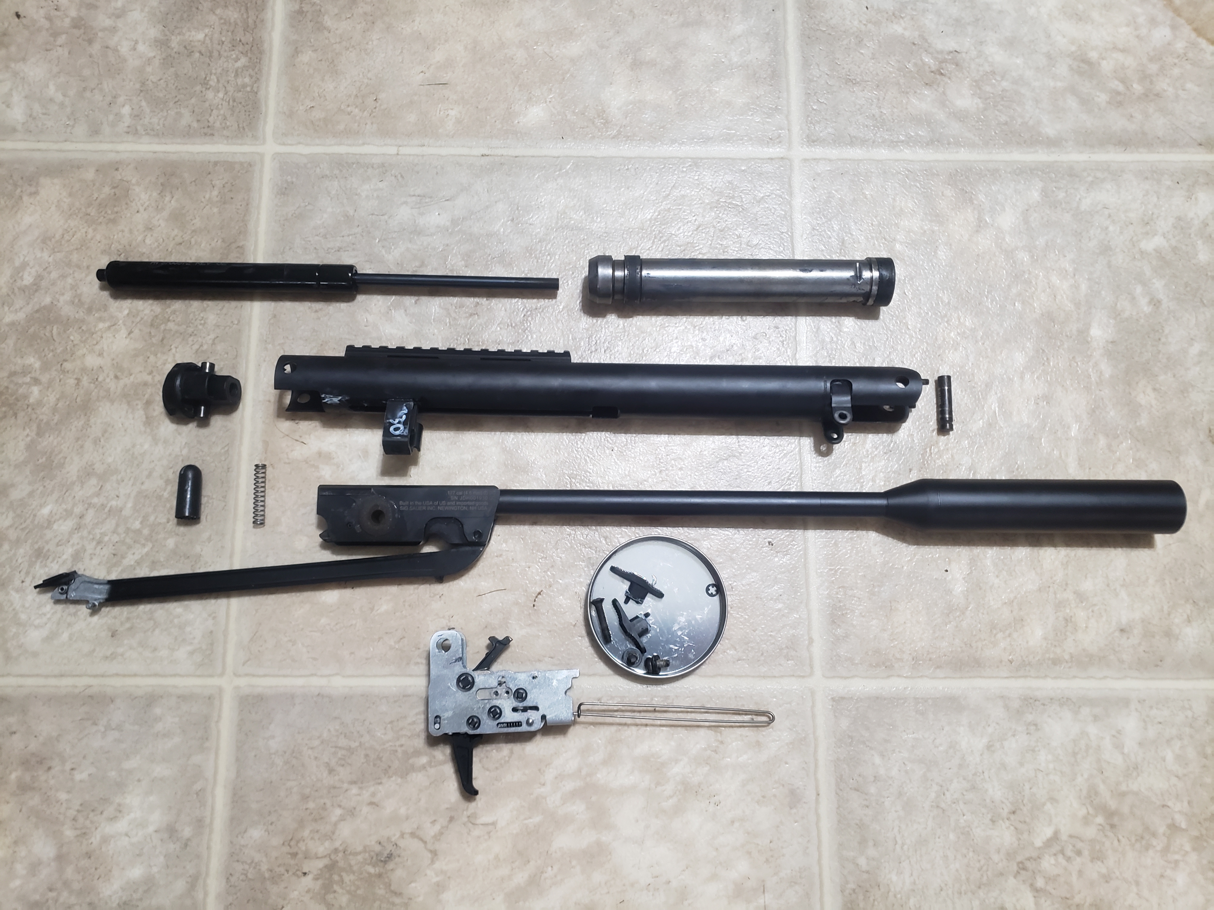

Got bored and decided to see what the inside of the ASP looked like. Its really nothing too crazy. It does have a well made, big ol 30mm, 403g piston that rides on a synthetic bearing though. The piston seal looks like it may be interchangeable with an HW80 seal which would be great news (UPDATE: It does with very slight modification. See below for details). I'll start running part numbers on the gas ram to look for appropriate replacements if and when they start to fail. Worse case scenario a simple metal adapter should do the trick.
Tear down is pretty straightforward:
1: Remove both safety buttons
2: Remove front stock screws and front trigger guard screw and then remove the stock.
3: Pull the lock washer from the front tab that the trigger disconnect attaches to and then slide the disconnect off of the cocking arm
4: Gun in a compressor and punch out the end cap through pin
5: Remove end cap (careful not shoot trigger adjustment knob and spring across room)
6: Remove gas ram
7: Remove the trigger assembly. The sear that catches the piston may snag on the main tube. Slide it forward and off or you will not be able to remove the trigger unit.

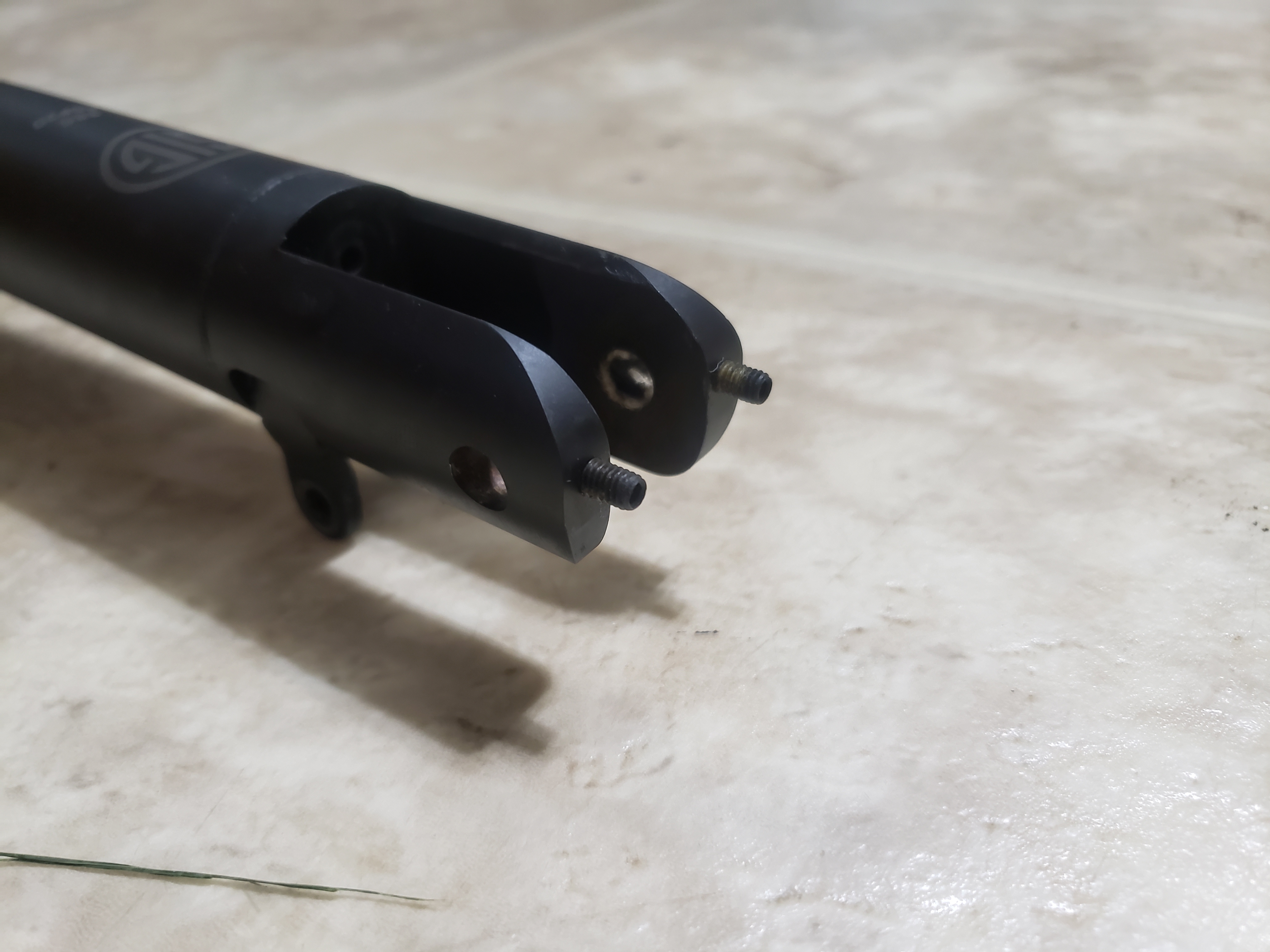

8: Back out pivot pin set screws. 1 screw in the front of each fork
9: Tap out the pivot pin. I THINK I went left to right here and I'm not really sure if that matters or not. It punched out with relative ease so if you are struggling, something isn't right. I will update this on reassembly.
10: Slide the barrel forward and lift the cocking arm and shoe through the cut out in the tube.
11: Remove the piston
As a final note a steel adapter to convert it to a coil spring would be easy enough to make if needed or wanted. I'll probably play around with this a bit soon.

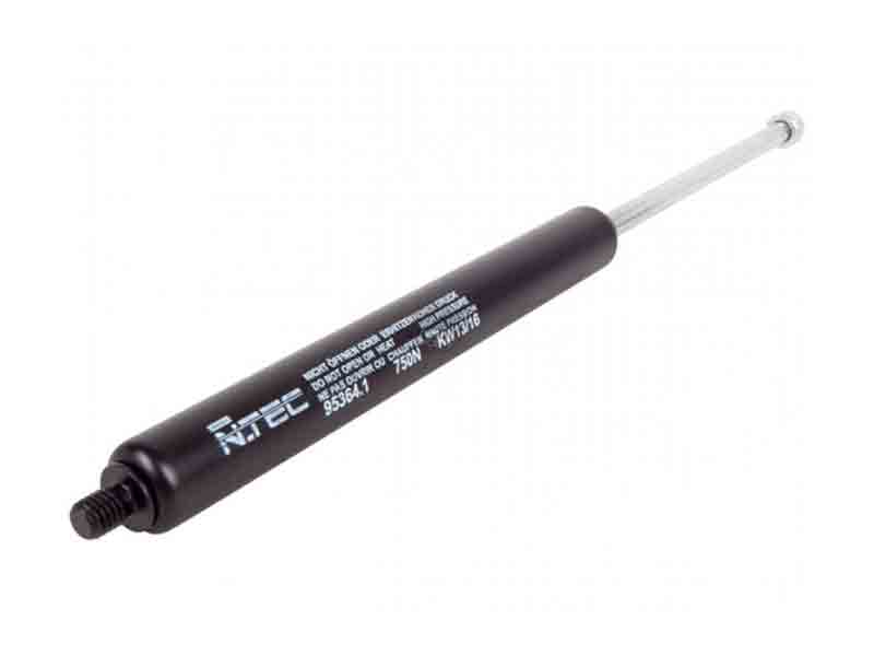

UPDATE 4/20 : I THINK I FOUND THE OE RAM. BARE WITH ME AS I FIGURE OUT THE DETAILS

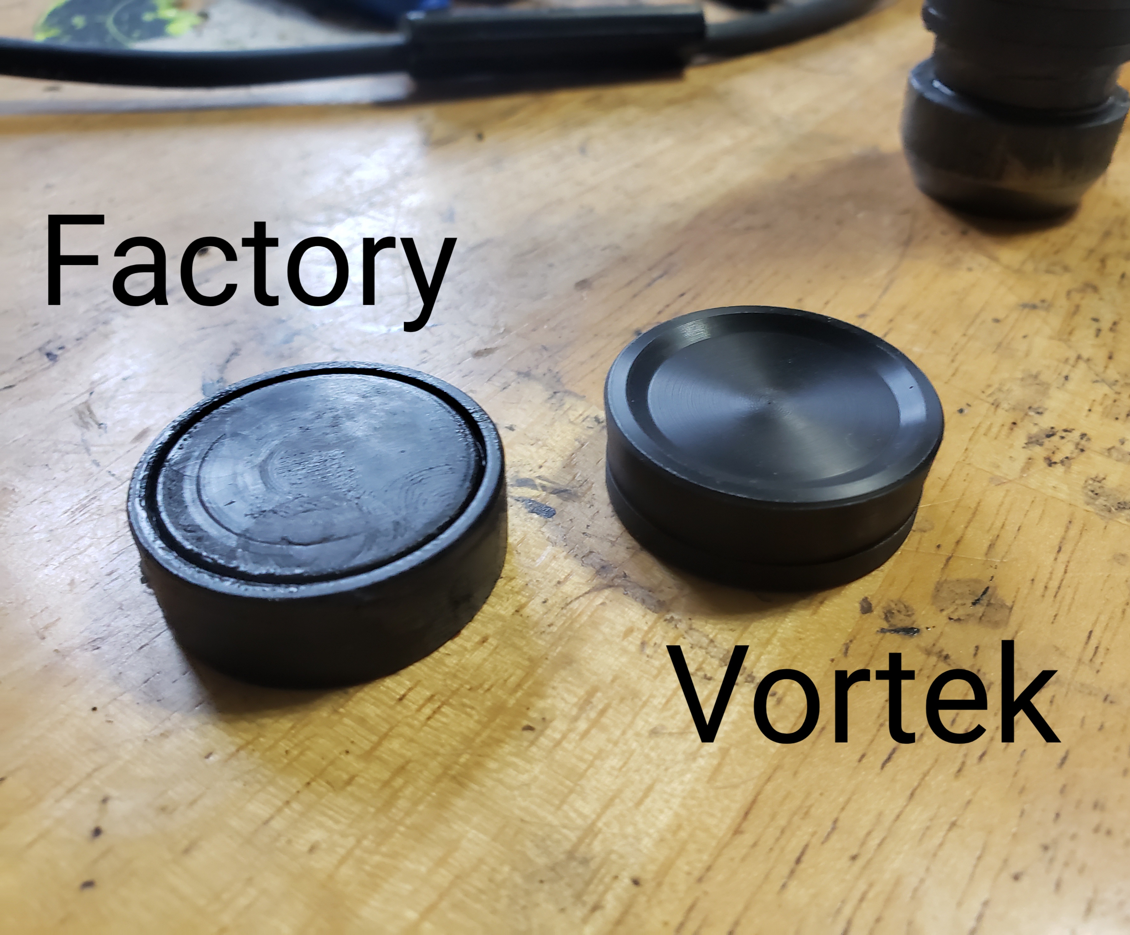

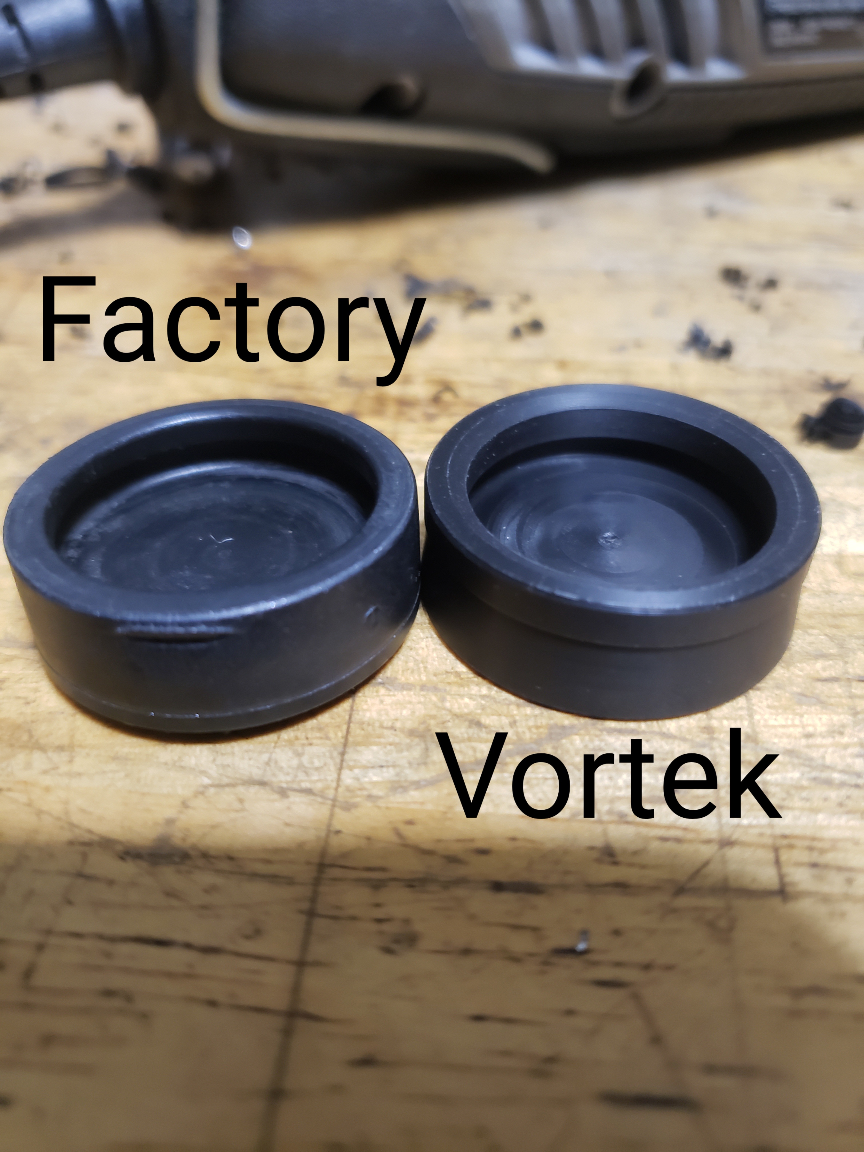

PISTON SEAL:

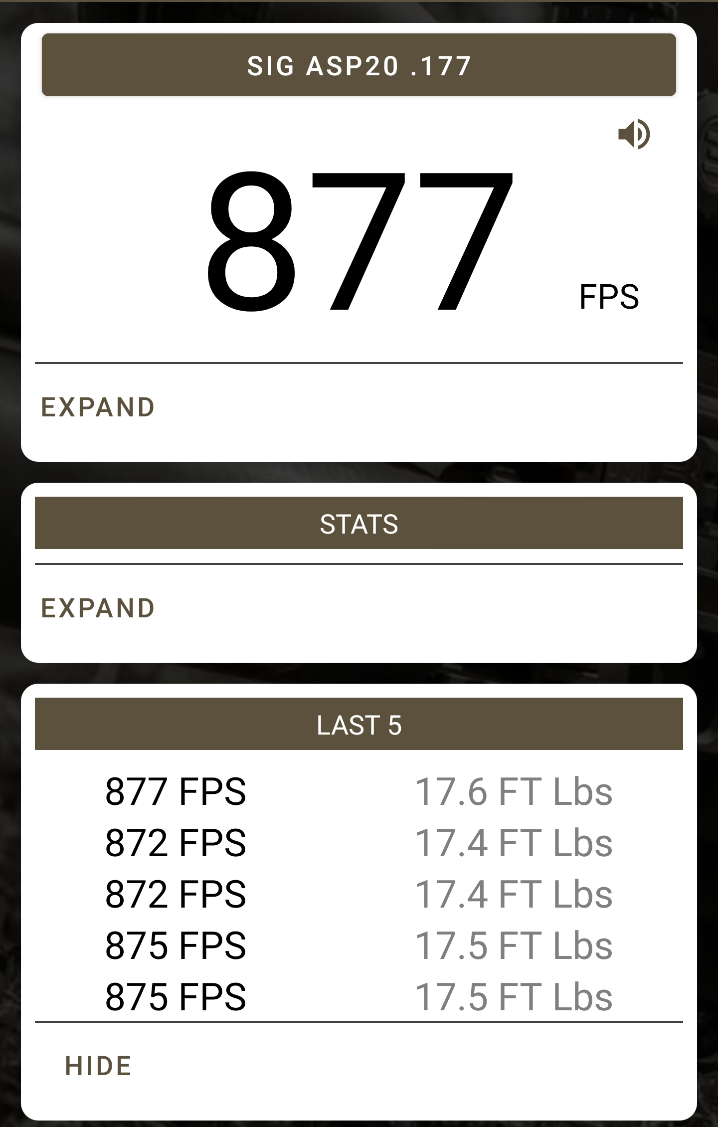

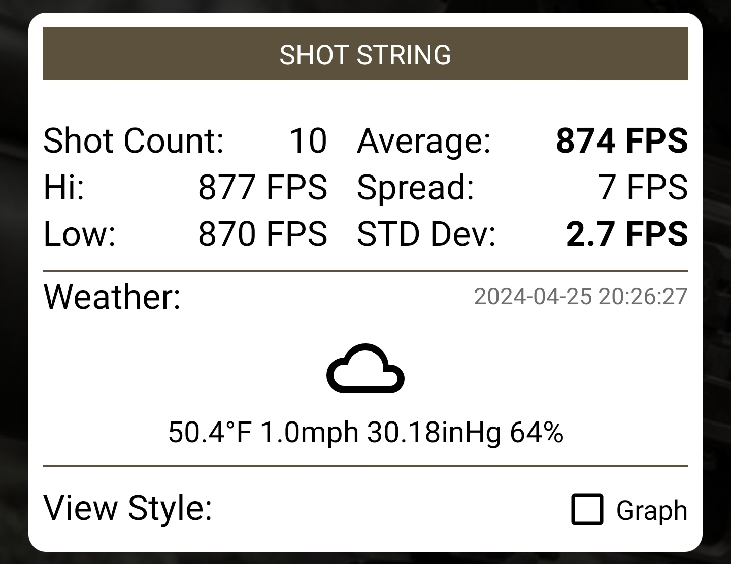

The Vortek HW80 piston seal does work like a charm but the internal dimensions are a smidge off making the base sit proud of the piston. I am fortunate enough to have a lathe handy so I just sized it down a hair. Took a minute if that. I then installed it and found it to still be a hair oversized. The factory seal measured 1.178"/29.92mm and the Vortek seal was closer to 1.188"/30.17mm. Being as its a Vortek seal I am going to just put a tin through it and see if velocity rises as it sizes itself. Currently I'm only about 25fps slower than the factory seal which is no biggie. I'm betting it rises but if not I'll just size it down a hair. I will try to update this as I go as well.
Nice! Have been super curious about what the inside of one of these babies looked like....appears pretty robust! Nit sure if I like the looks of die cast on the cocking arm, buy I'm sure something could be whipped up as a replacement if need be. Definitely would like to know when you find a suitable replacement for the gas ram, how cool would it be to have like a adjustable one in there like a theoben!
Reactions: Sqwirl57
I was honestly a little disappointed that the ram wasn't rebuildable. I wasn't really suprised though. I thought maybe with how much effort went into making the gun, Sig may have used something a little fancier there.

A pivot pin that's locked in place by twin grub screws threaded through the stock front! Since a critical feature of breakbarrel pivots is the ability to tighten the joint laterally when needed, I wonder what SIG went for here? Pivot pins as opposed to pivot bolts are old tech, but pretty much discredited, too.

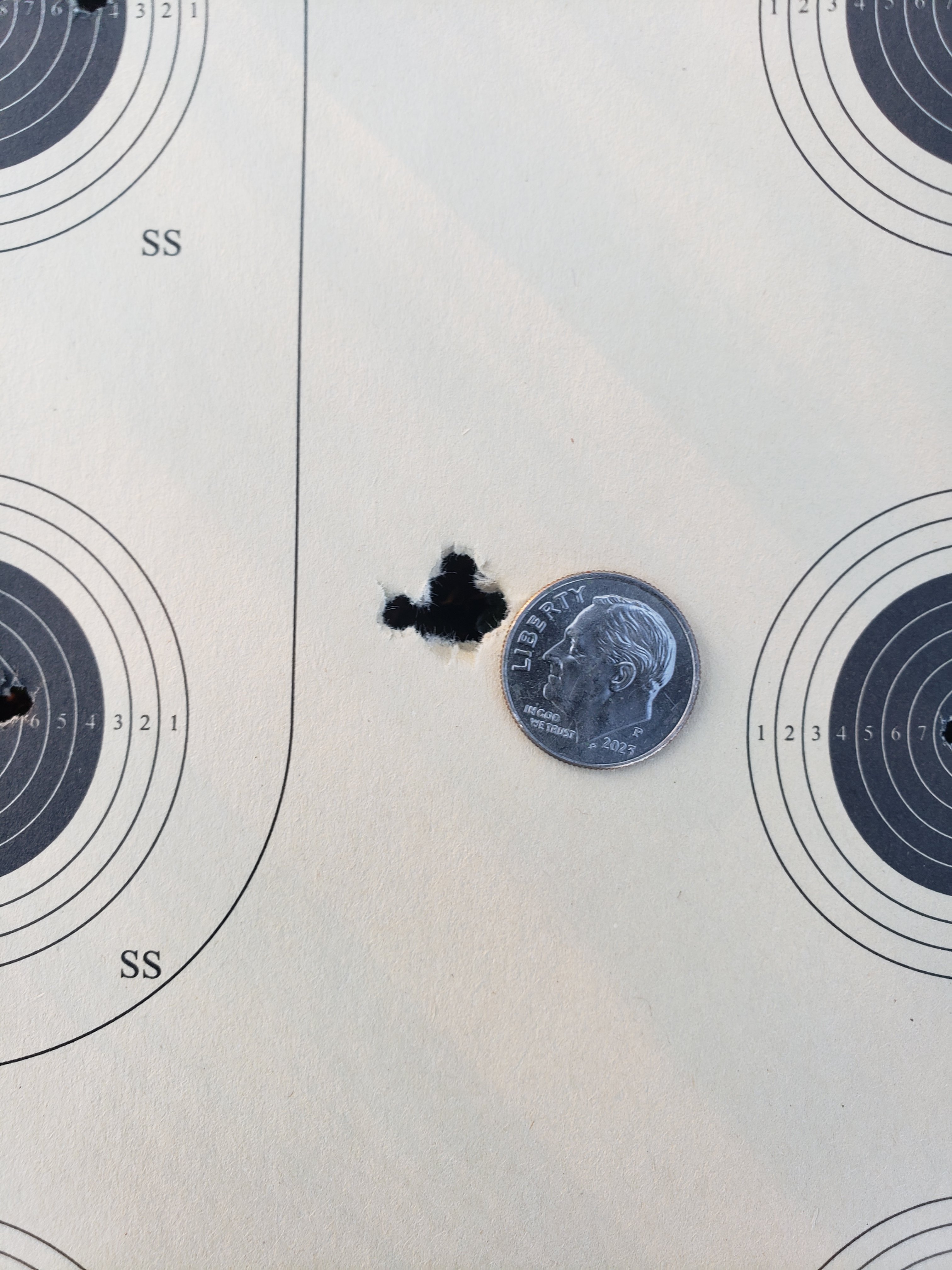

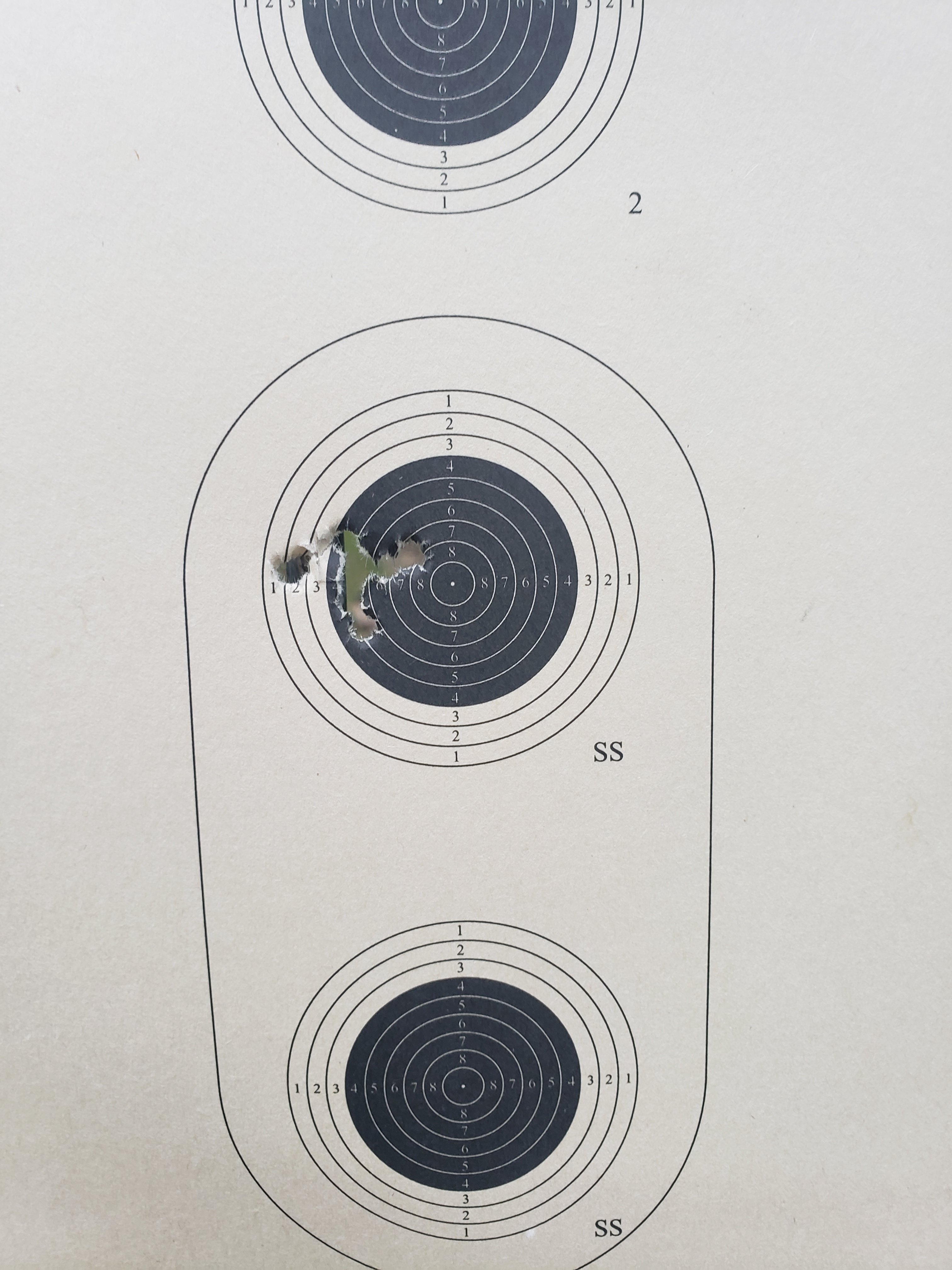

The pivot pin is key to the ASPs greatness IMO. Cocking effort is basically zilch compared to guns of similar power. Its advertised as 35 pounds of effort but in reality it feels easier than an HW95 all because there is very little side to side tension on the breech block and instead uses a Keystone wedge system to keep the barrel lockup consistent. How does that affect accuracy? Here are two 10 shot groups at 32yds:
The next one is actually only 9 shots. I threw one under that dime but all 10 shots still fit under that same dime.
