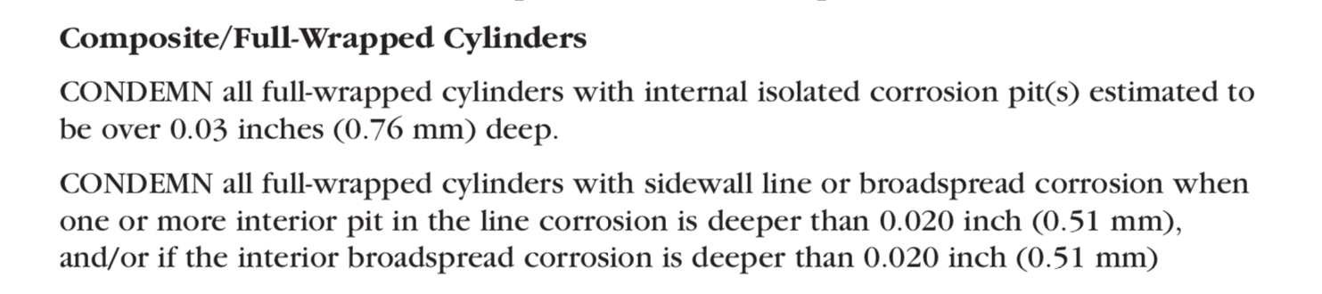

Are you sure? See photo screen shot from your link, page 21, section 6C. It says .030” for SCBA, .060 for aluminum scuba tank. I highly doubt you have any pits. But longitudinal scratches 6” long are condemning.

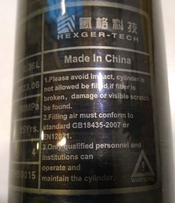

Yeah, nothing on the label compared to quality made SCBA’s (not to say yours is junk).
And not aware what Q/JB TH0015 means but a quick google search shows that it references the REE number.
See link, bottom of page on link.
