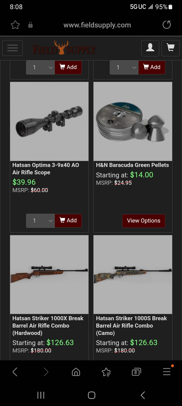

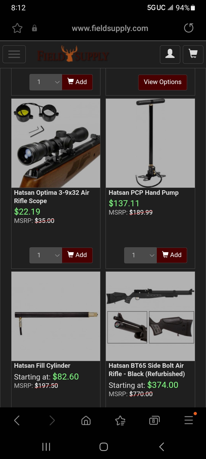

Own both almost free shipping field supply .com
Harry, The Hatsan brand are cheap and have held up on Hatsan model 95 and 125. You can adjust parrallax on the non AO models by uncrewing the ring on the bell end screwing the carrige in or out and re install the ring. Very easy. Matter of fact I have 2 Hatsan 3x9 non AO models you can have for cost of shipping and I will adjust parrallax at any distance you would like.
Reactions: sirromdj
