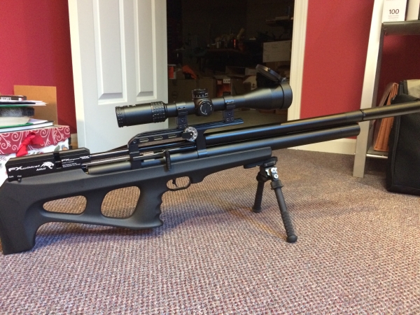

Looking for some input on the FX Wildcat Mk2 .25. Recently got my Wildcat back in December looking to tinker with it. Have any of you Wildcat .25 owners tuned your rigs for shooting slugs?
Thanks Bob O / I have been shooting over my chrono getting some erratic velocities Low of 810 high 871 with a 230 bar fill over a 16 shot string. Using the 25.39 I have not had it apart yet. Ordered a Huma Reg awaiting for that to arrive. I will see if that makes a difference after that's installed. I put a Donny FL Koi on the end took all that bark away nice quiet now. Maybe I will contact FX to see if they have any liners coming soon to shoot slugs for the Wildcat.
Well HUMA Reg took care of my problem mostly still have a POI shift but only about a 1/4 of inch on first shot after sitting all night. My consistency from shot to shot through Chrono is only 12 fps so happy with the change out.. Have HUMA set at 125 bar loves the .25 JSB HADES one ragged hole at 50 yards. Other added item was a superior slug liner barrel in 600mm can shoot slugs and also 25.39 JSB with very little change in scope setting.
