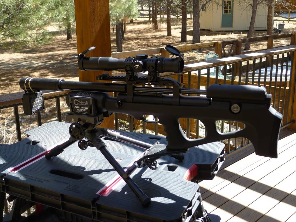

Initial Wildcat 3 Compact BT .22 Observations
Configuration - As delivered with addition of carbon fiber barrel sleeve, DonnyFL Sumo, and Optisan CP 3-12x32p scope. Cleaned barrel and started shooting.
Good balance, accurate with JSB 18.13 gr Jumbo Heavy pellets at hammer settings of 1, 2, and 3. Hammer at 2 was most accurate. Looks like factory setup is for JSB 18.13 gr pellets
Initial magazine insertion was tight and felt like pellet probe was dragging when cocking. This was so concerning that I bought a second magazine to see if it was a magazine problem. The new mag exhibited the same issue. Both mags smoothed out after about 100 pellets through each mag.

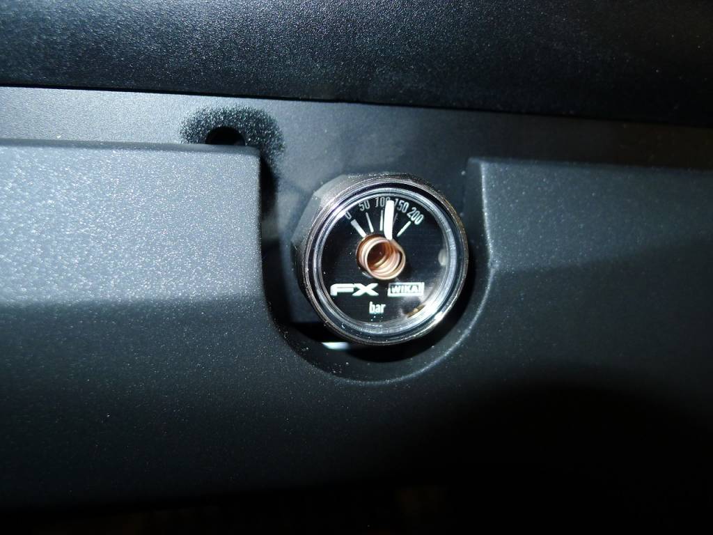

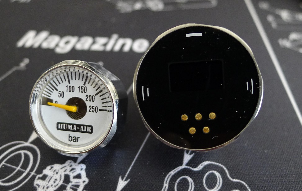

The regulator gauge is small and hard to read accurately. Fat needle with a compressed scale. It is a wika/fx branded gauge so I believe it is accurate but very hard to read (at least for my old eyes). Ordered a 23mm Huma gauge with slightly larger scale and thinner needle to see if it would help me accurately read the gauge. No issues with bottle pressure gauge.
Overall an excellent handling and accurate bullpup right out of the box!
Next step is to experiment with slugs. Then see if there is a setup that will allow me to shoot slugs at a high hammer wheel setting and a good pellet setting at a lower hammer wheel setting without having to change regulator settings. Maybe wishful thinking but worth a try.

The bottle reg can't be seen unless the plenum reg is wide open. The plenum regulator is currently somewhere between 110 and 120 bar as best I can tell. The gauge that shows the regulator pressures is very hard to read accurately. This is why I have ordered a new Huma regulator to replace the FX regulator. I have attached a picture of the regulator pressure gauge. Unfortunately I had to take the picture at an angle because the flash washed it out if I was directly pointing at the gauge.
put a 25 mm sehkment gauge on it i bet be very nice
Wow, so that's the kind of gauge I get when I shell out one and a half large ones...?
Extra fat needle
AND
Extra compressed scale
So, then I go online shopping to replace my brand new big-brand gauge on a big-brand gun — with another big-brand gauge...?
Forgive my gawking in utter disbelief. I was born that way.
