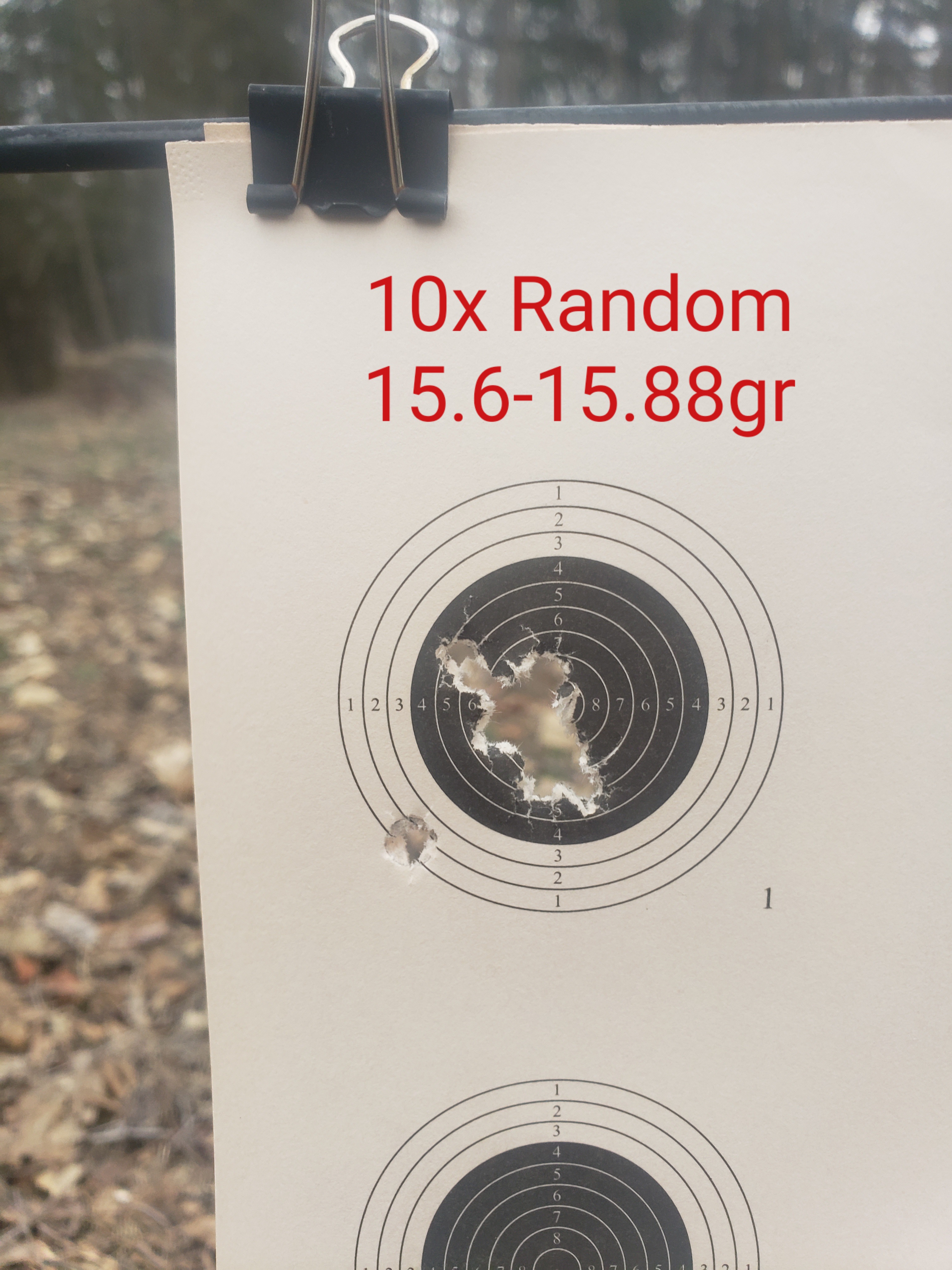

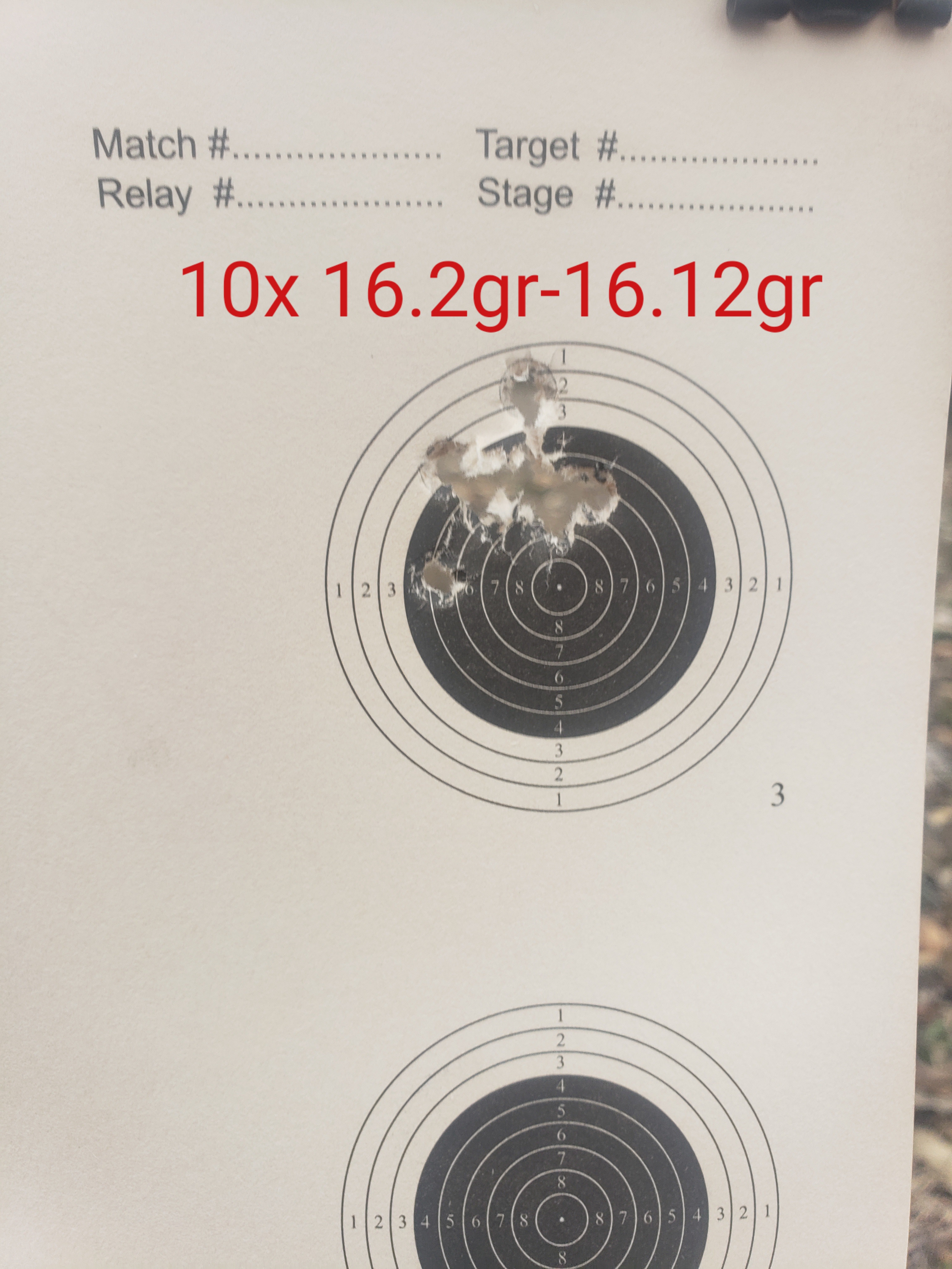

Shot 3x 10 shot groups today with my .22 Walther LGV to get a rough idea of what I could expect. Winds were blowing at 7-10mph and I was not as patient as I probably should have been while shooting these groups. I did notice an interesting pattern though. As the pellets got heavier, the POI climbed a bit. It seemed to be about 1/4" for every 0.1gr of increased weight at 30m. SHOT A COUPLE MORE GROUPS AND THE LIGHT AND HEAVY PELLETS HAD A VERY SIMILAR POI. EITHER IT WAS TENPERTURE RELATED OR IT WAS BECAUSE I WENT FROM 10X TO 16X BETWEEN GROUPS BEFORE. YOU'D THINK AN $800 SCOPE WOULDN'T HAVE THAT MUCH SHIFT AT 30M BUT I MAY BE WRONG. OOPS!
This group was basically my "throw away" pellets. While the weight range seems excessive, 90% of this tin were 15.82gr to 15.88gr. In hindsight, I should have just tossed the extreme differences, which would explain that bottom left shot. The other 9 were all pretty neat.

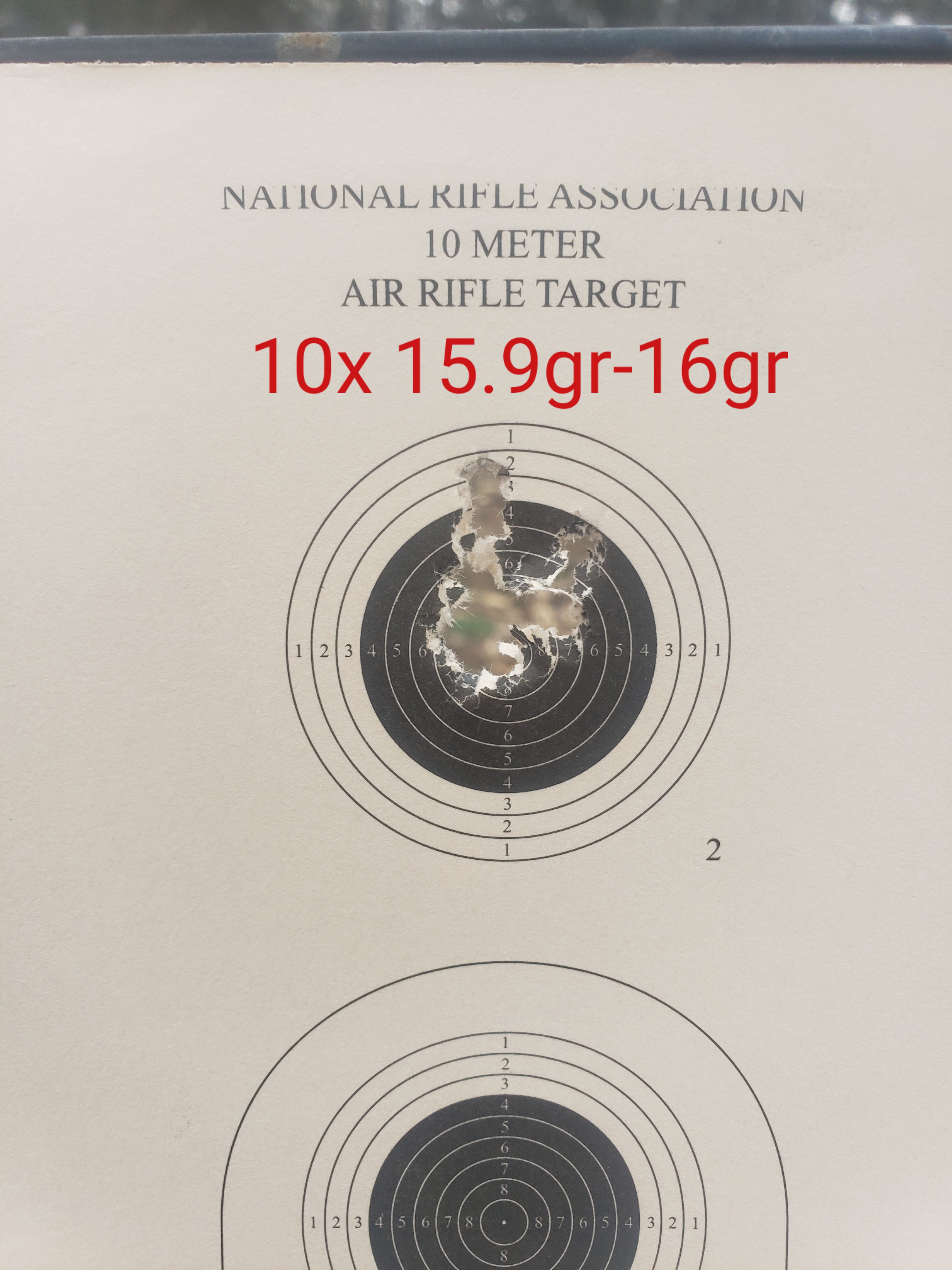

As you can see, when the average weight climbed .1gr, my group stayed decent but rose about 1/4" on the target.
This weight range (16.2gr to 16.12gr) seems to have the most potential. Aside from 2 outliers, most of them basically hit on the same vertical plane. Given the wind conditions, I'm definitely not upset here.

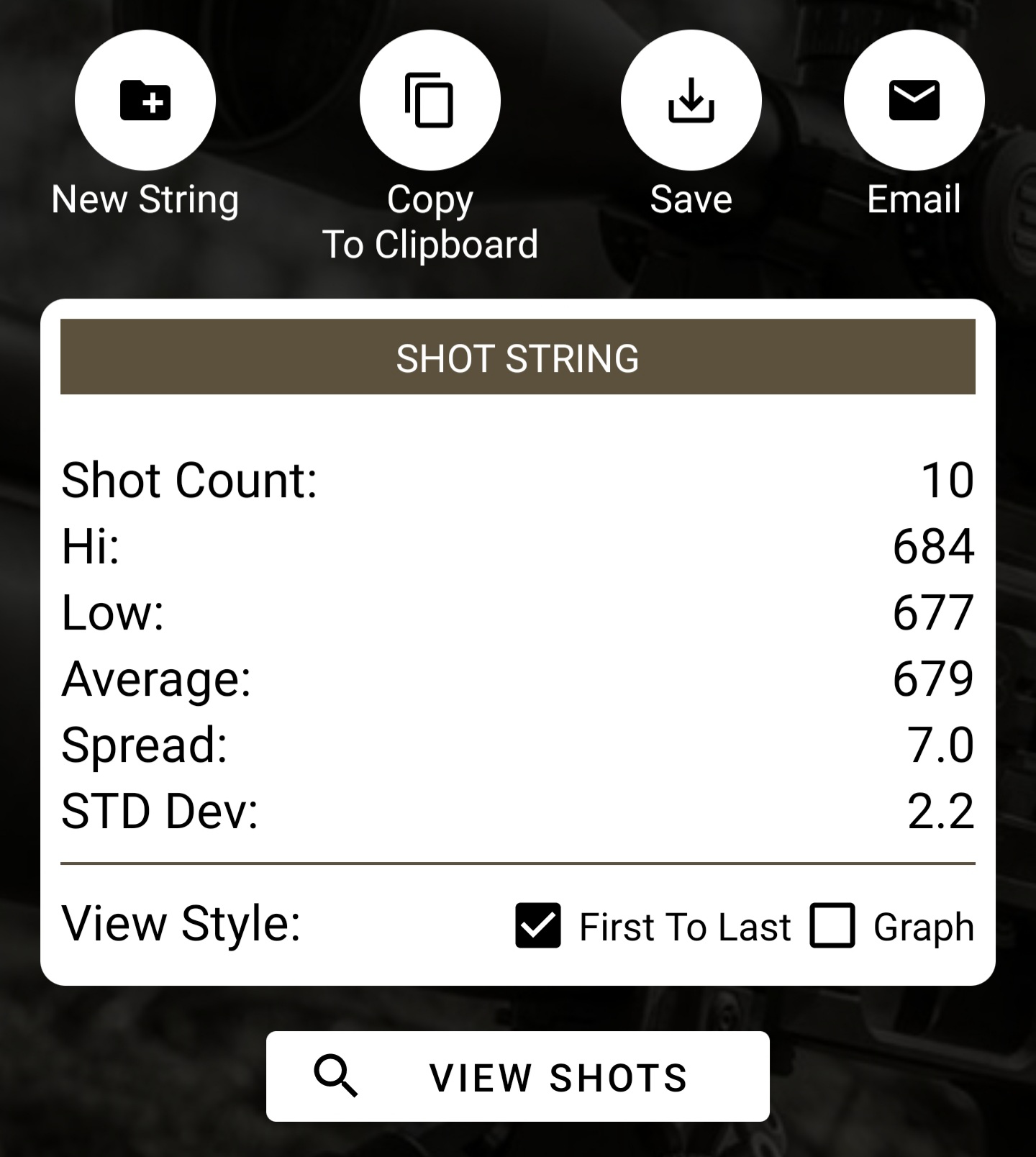

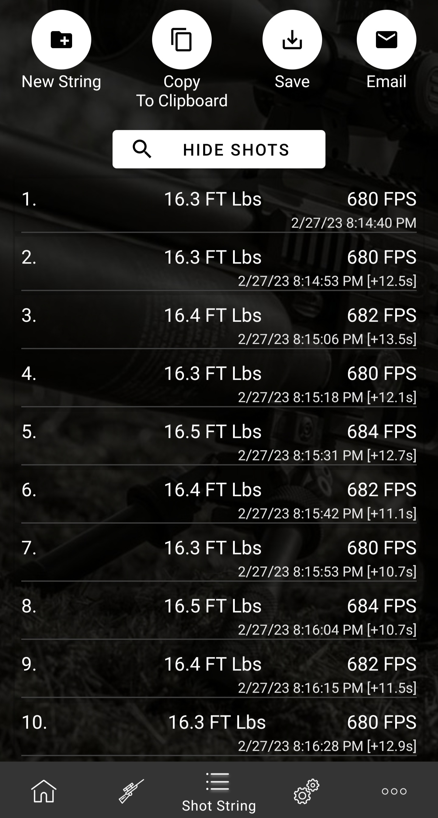

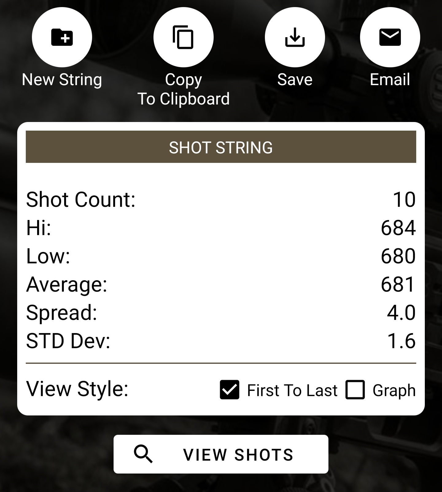

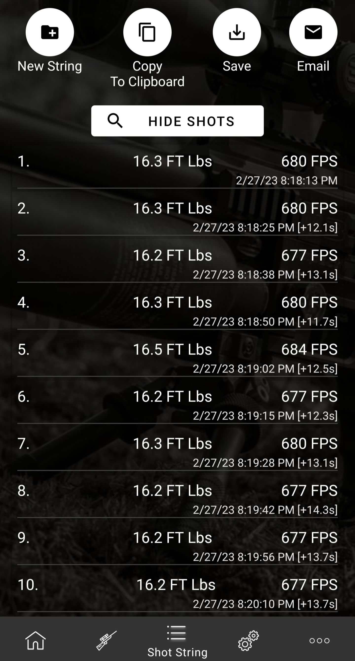

You make some excellent points. Just ran 10 of each weight group to compare.
15.90-16.00gr
16.02-16.12gr
Reactions: dgeesaman
Doesn't seem to make a lot of difference, both ESs are very good. But the 16 and under ES is just over half of the ES for the 16+ grain. The groups also look similar but you liked the one with the slightly heavier pellets a bit more. Might be something to continue to evaluate. Maybe the correlation of ES to group size doesn't discriminate when both alternatives have good ESs.
