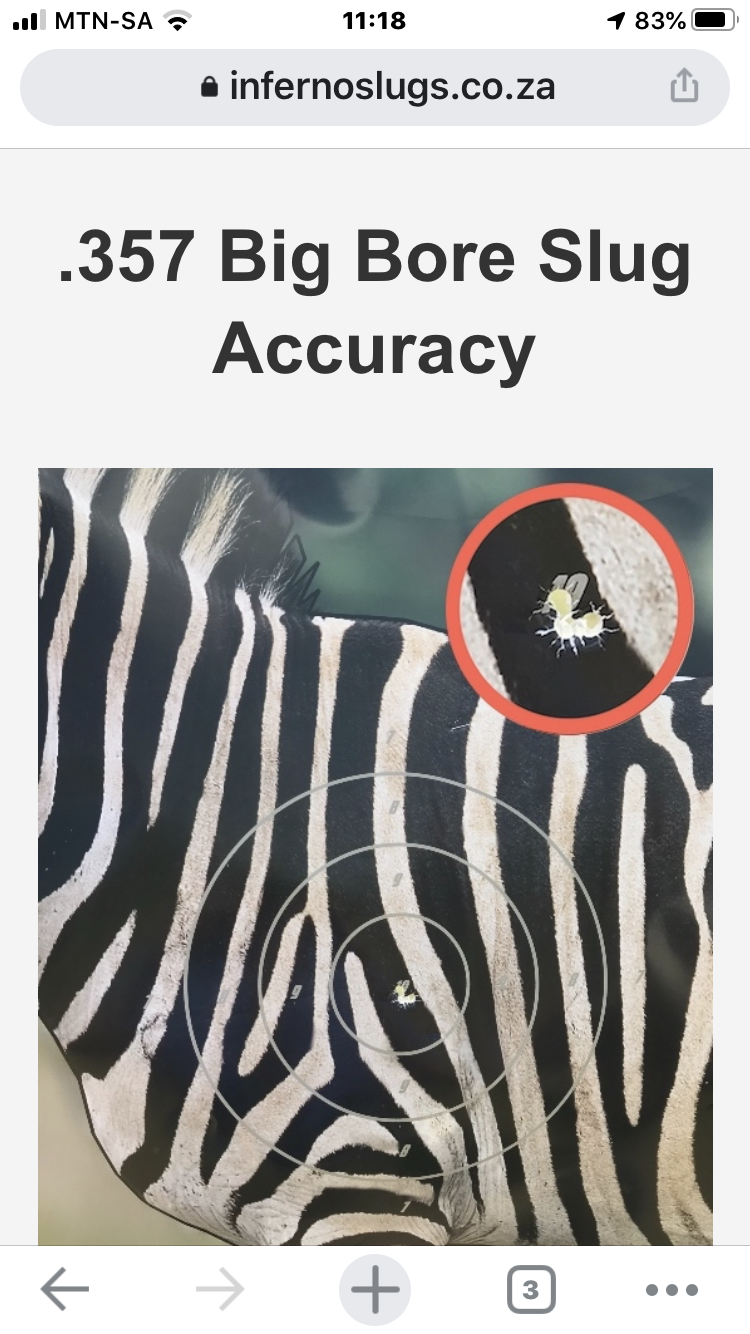

A few years ago, I was shooting my newly acquired .35 cal Jkhan N400 at 50 m with JSB 81 gr pellets with reasonable accuracy. I was approached and asked what am I shooting, after explaining what I am shooting and that the 50 m accuracy is ok but at 100 m I can’t get acceptable accuracy. He said why don’t you try some of my Inferno .357 cal 130 gr HP/ RBT slugs and proceeded to show me a photo of a grouping he shot in a big bore rifle competition with his air rifle.
He said he came third and I knew I am going to like this guys because that is something I like doing, shooting an air rifle against a rifle.

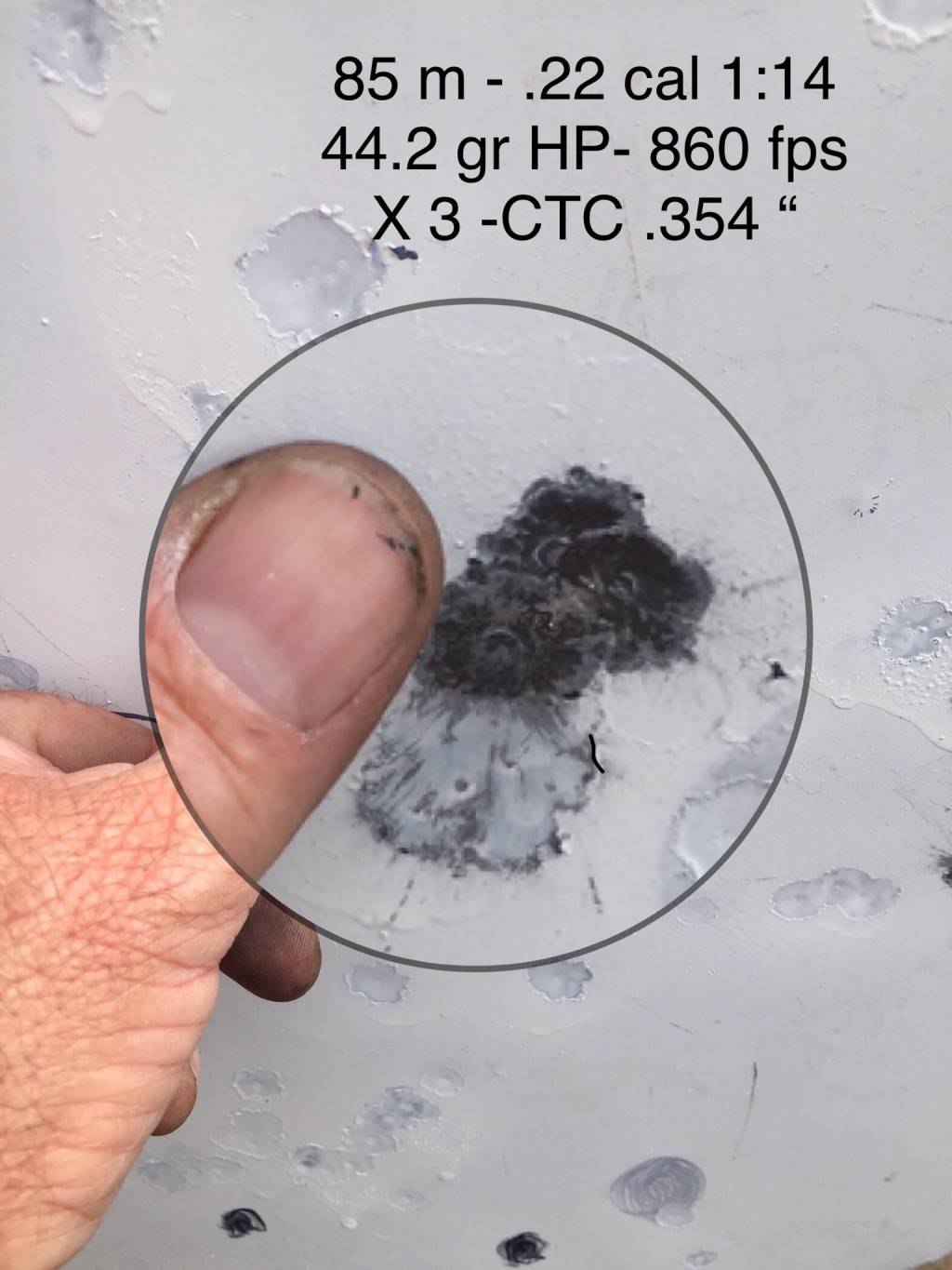

I purchased a 700 mm Slug A .22 cal liner and proceed to test JSB and H&N slugs, sorry they just don’t match up to the pure awesomeness of 44.2 gr at 860 fps.

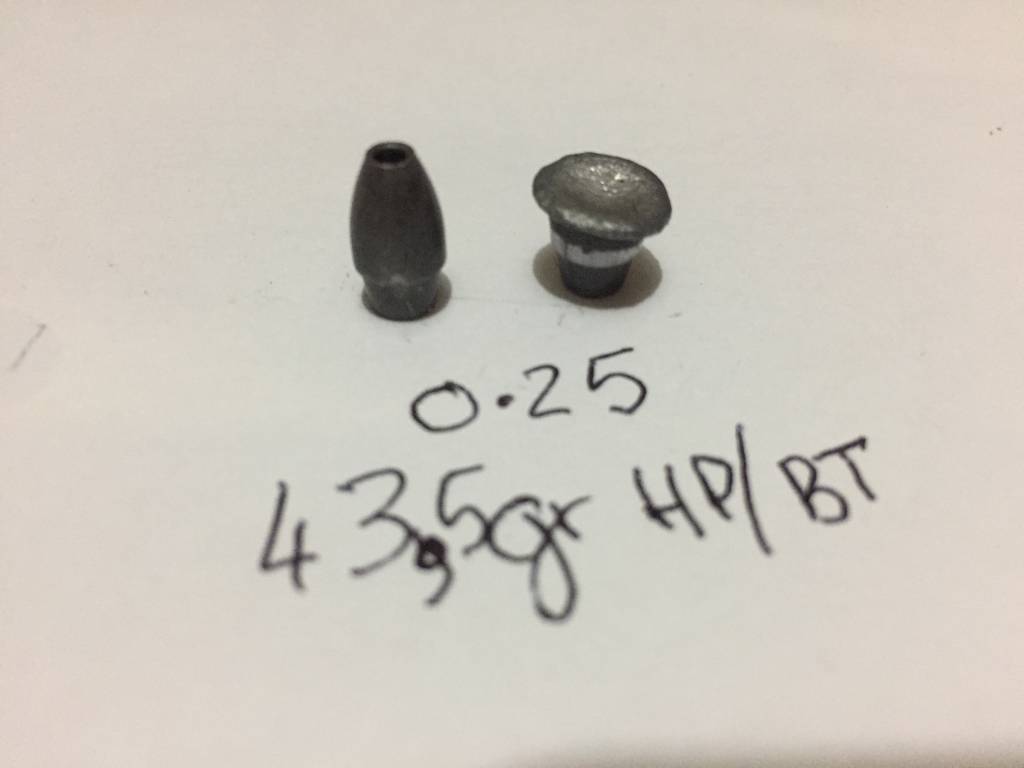

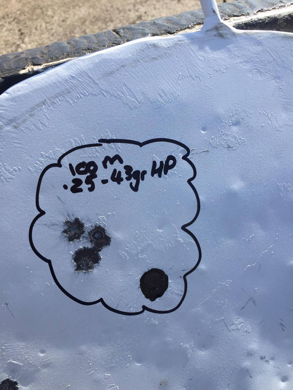

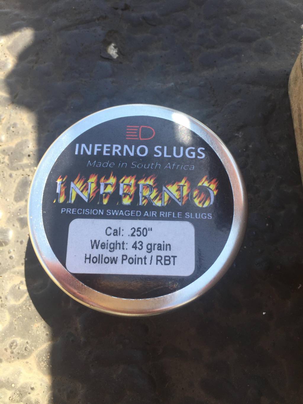

I purchase a tin of Inferno .25 cal 43 gr HP/RBT slugs, after a few test shots I found the sweet spot .
This slug really cut through the wind and was matching fpe, accuracy ( 3 shot grouping 1/2 MOA) and DRT factor. The real test came when I tested them on one of my favorite and hardest pigeon shoot because of far distance and strong winds.

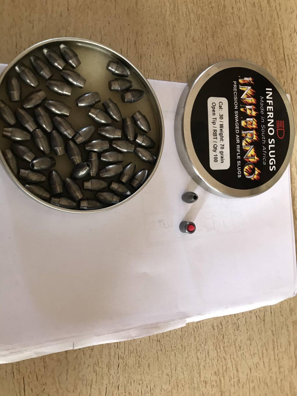

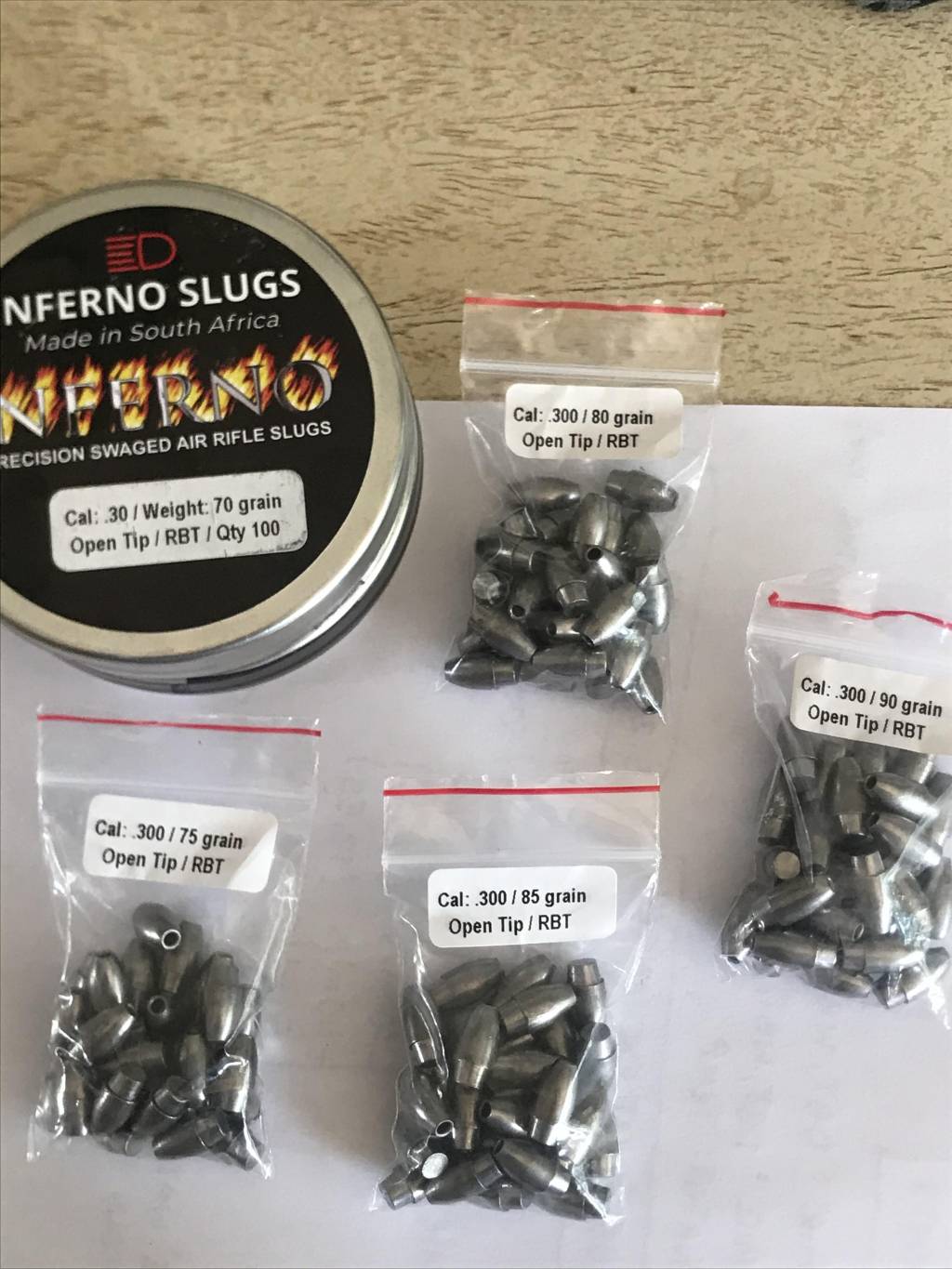

I contacted Inferno to see if they have 30 cal RBT slugs, I was told they have ordered dies from Corbine but are waiting for delivery. Six months later I receive a call from Inferno to say they have received their dies from Corbine.

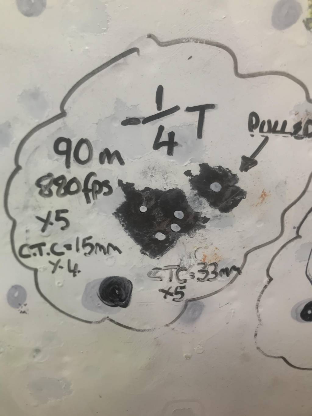

Straight away I order a tin of their 30 cal 70 gr HP/RBT.

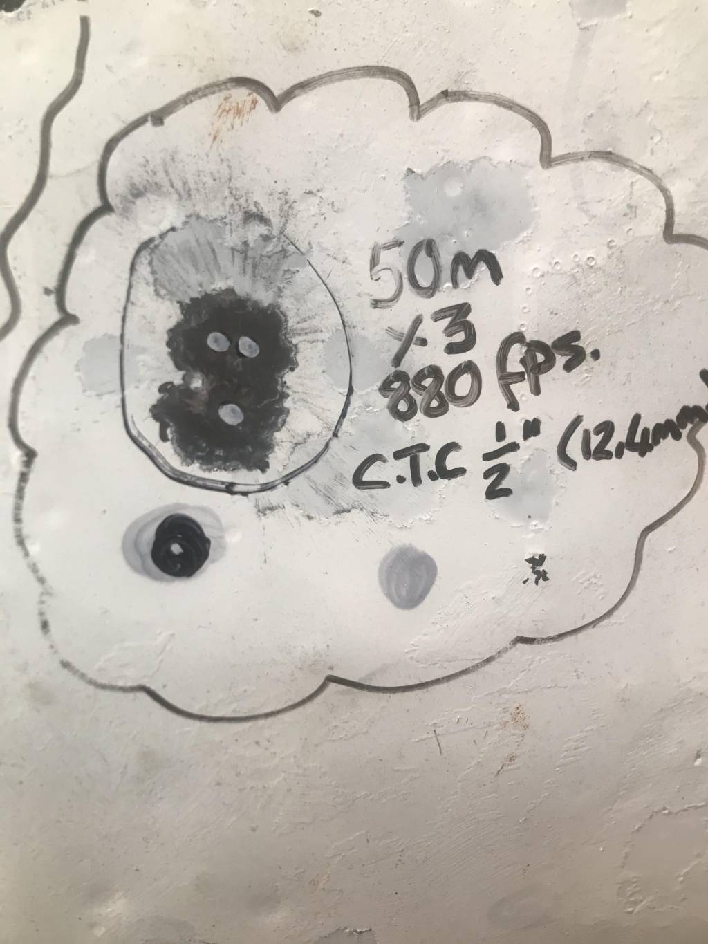

First few shots at 890 fps produced a respectable grouping, I increased the velocity to 920 fps and the grouping started to open up. I dropped the velocity to 880 fps and the grouping tightened up.
Man these RBT slugs just don’t disappoint, the litmus test will be a pigeon shoot .

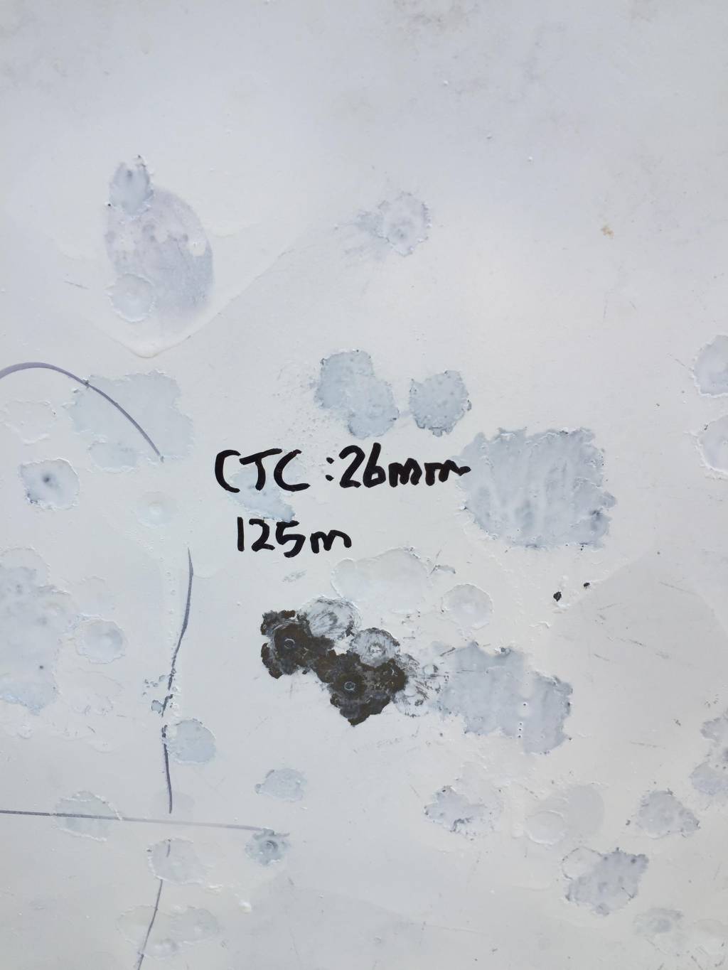

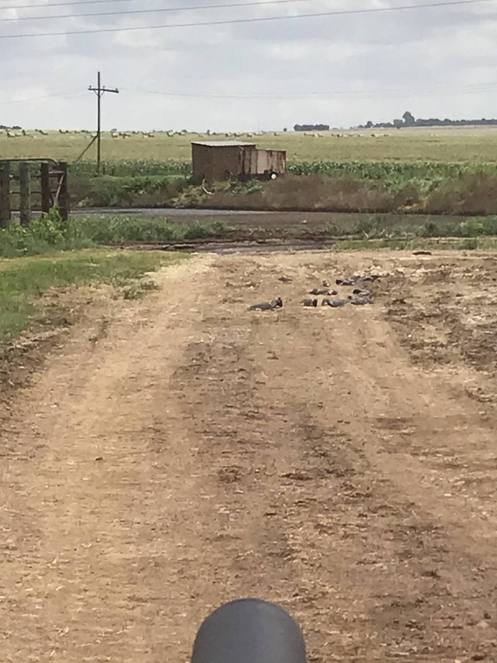

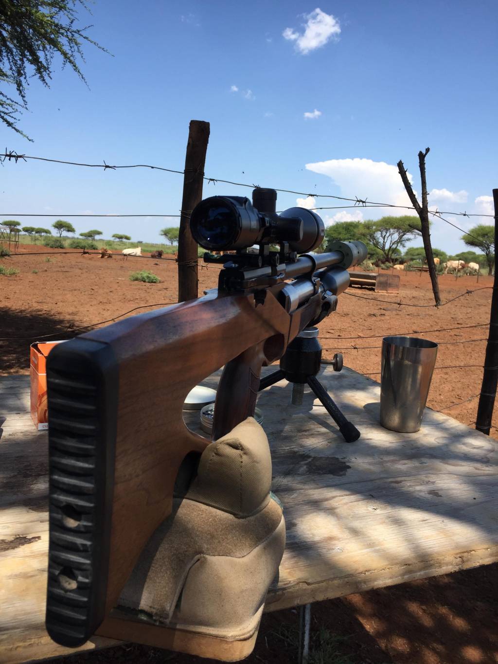

Being on Christmas leave, I had sometime to go on a morning Rock Pigeon shoot at a feedlot.
I shot pigeons from 50 - 152 m with great ease, but did notice passed 120 m reading the wind becomes a challenge.
I also noticed on this shoot that the slugs have a slight twitch in flight, I will drop the velocity down some more. I see Hunter One shoots his 457 cal with RBT slugs at 855 fps.
I made school boy errors trying to reading the wind, I didn’t even notice when the wind dropped, hence the not so great shooting grouping.

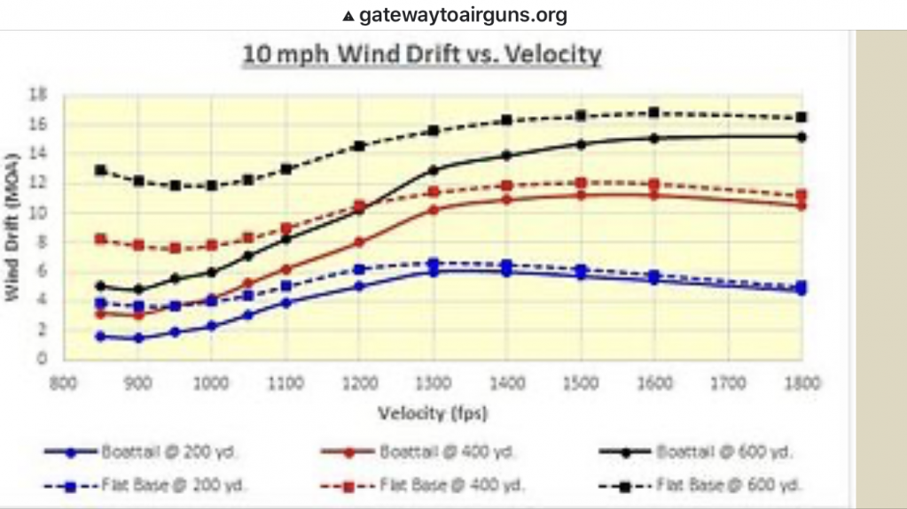

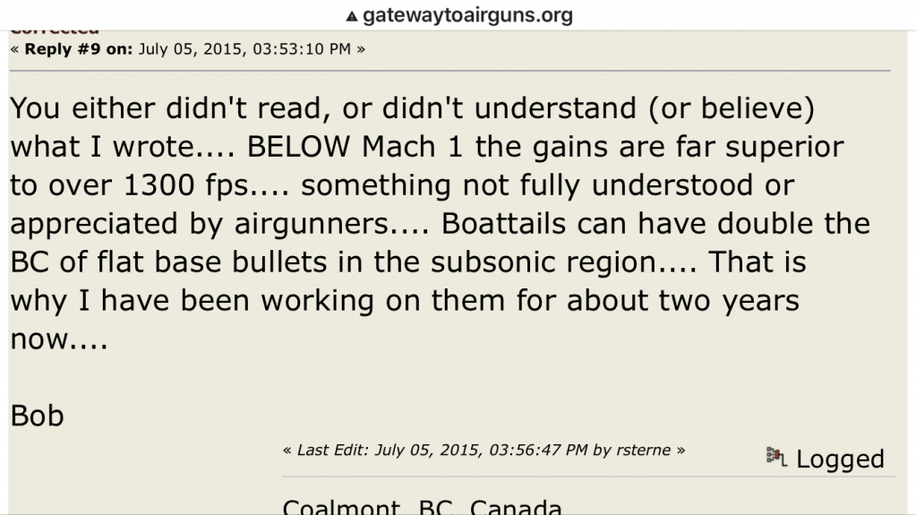

I was reading an old article written by Bob Sterne, thought I will share.
I apologize that this has been cut and paste from another forum.
Great article that Bob sterne is a book of knowledge..you want to know what is funny..n I envy the space you have to shoot.. because I live in the city between my shop, the rent property's..2 private schools to pay I have no time to go to my friend land to really enjoy those rifles .. aside been able to test shoot in my shop space..the .223 or the 2 texan have not seen day lite..in a year that I have them and the 257 talon door has been only shoot 2 times in my friend land in 2 1/2 years..😒..the first time I shoot that .257 it was at 170y and it made it look like child play..n I knew I have to find a way to make the .223 because there were a lot of similar bullet molds between the two..long range shootin it's what I really enjoy about this sport..way to much to learn..

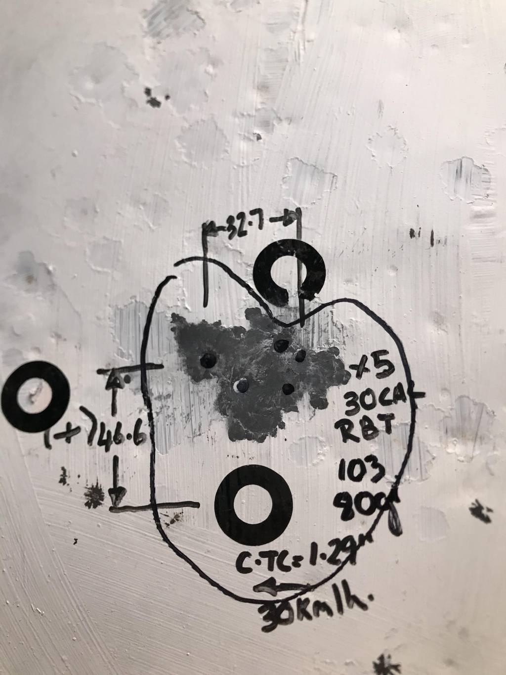

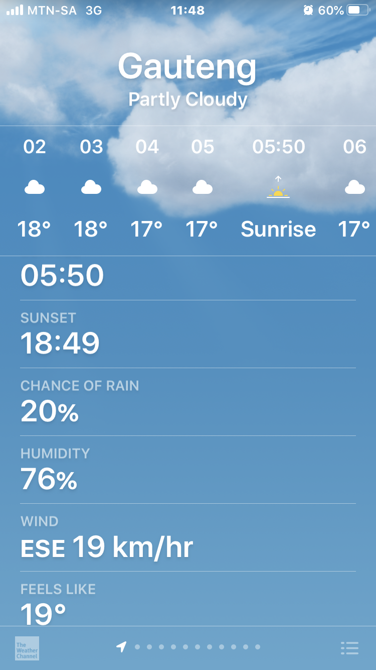

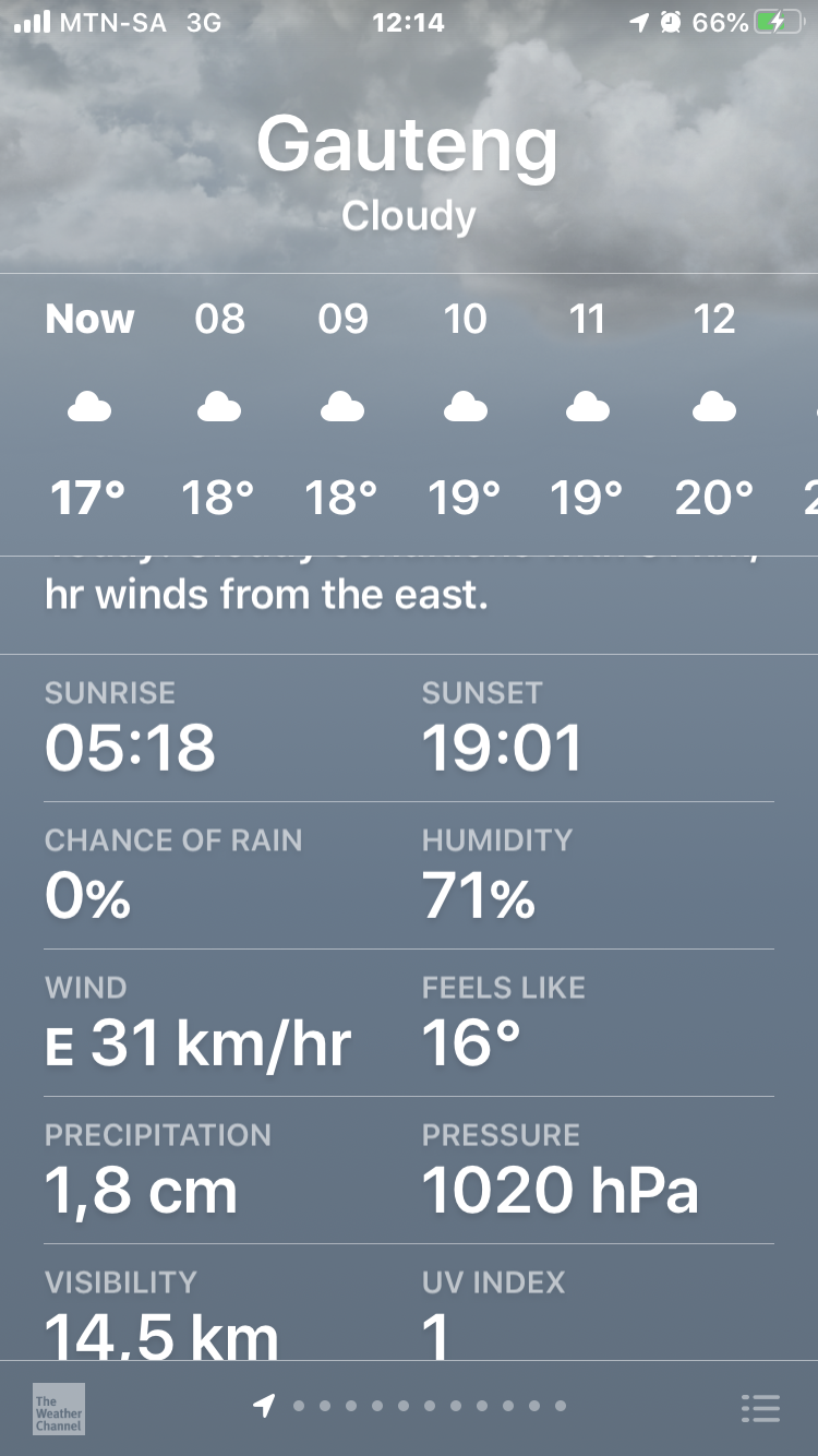

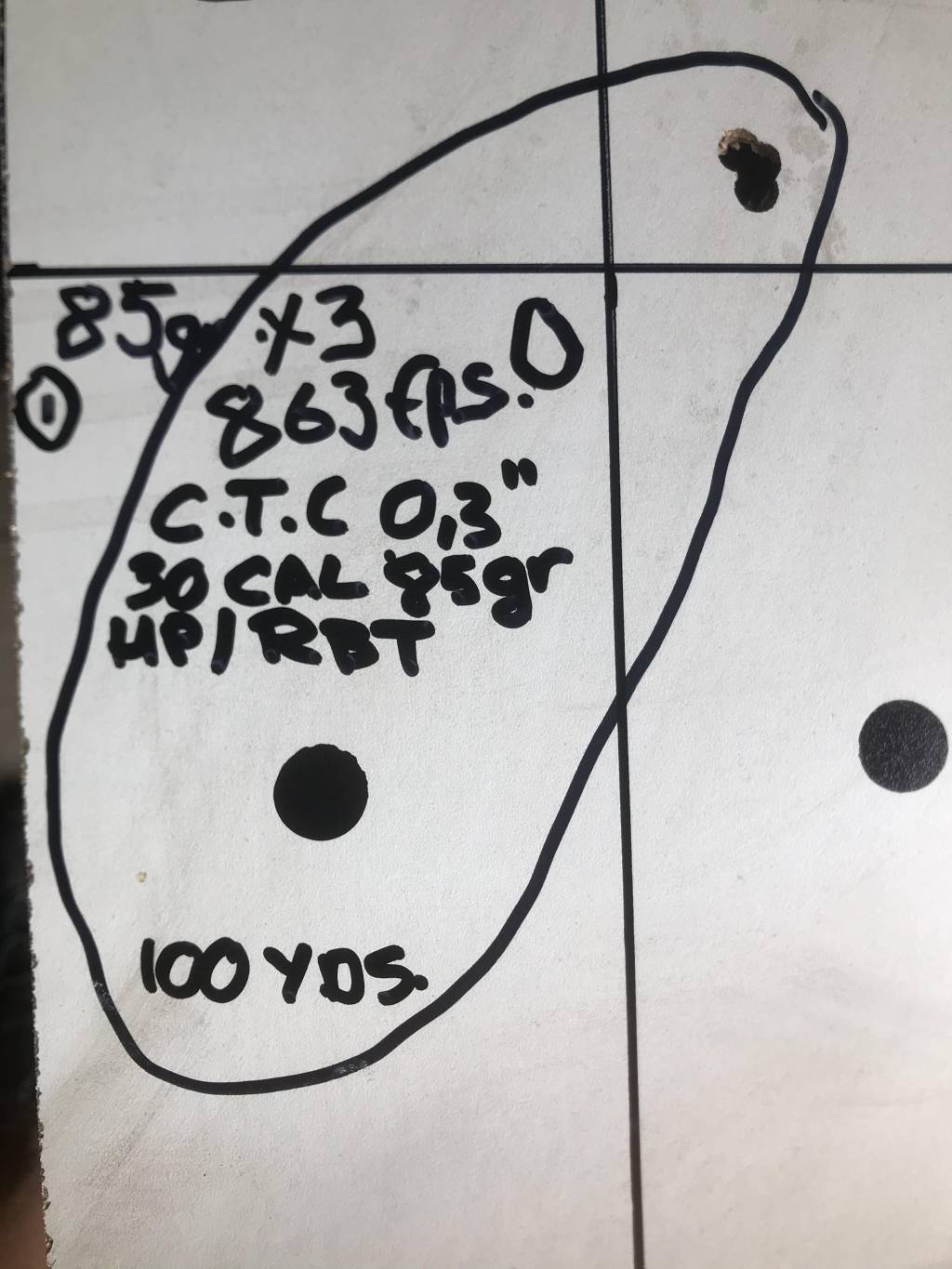

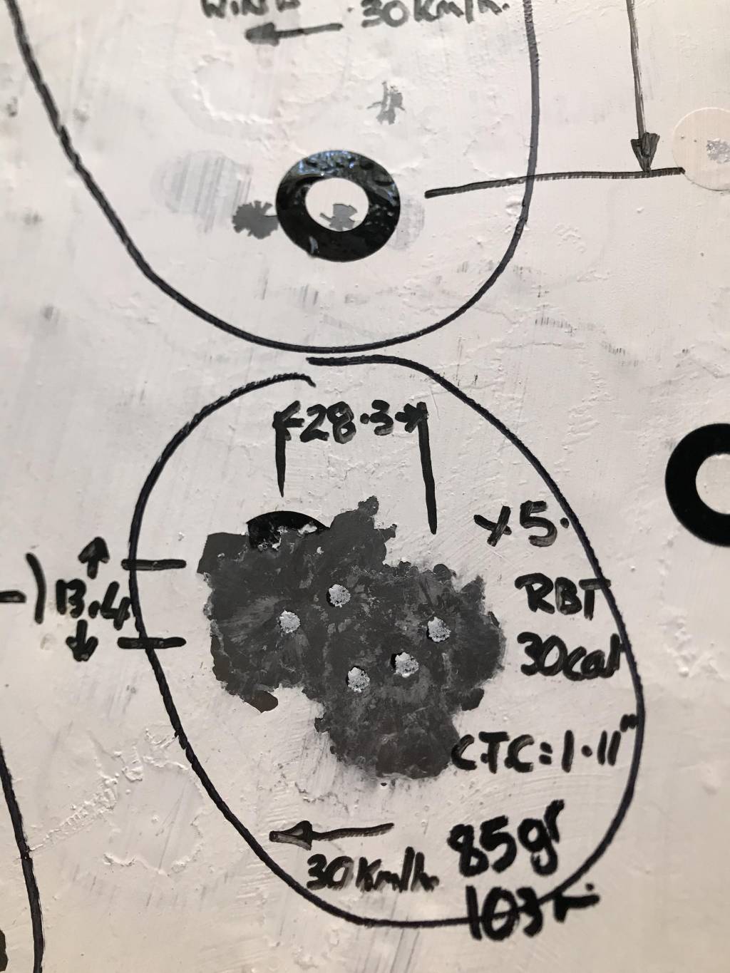

Last weeks slug accuracy testing conditions where less than idea. The 85 gr RBT was handling the 30 km/h well, I thought how well would it shoot in no wind.

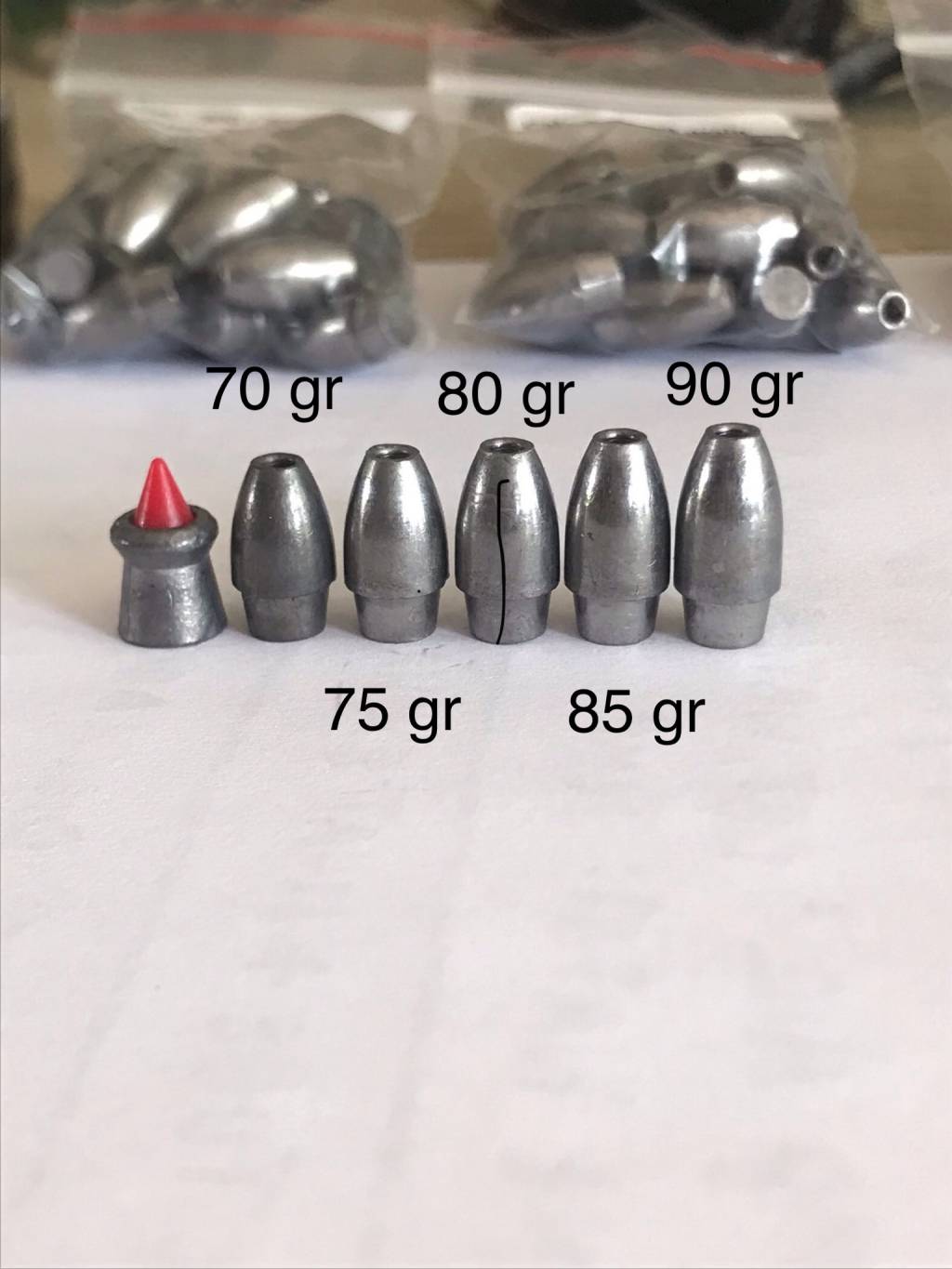

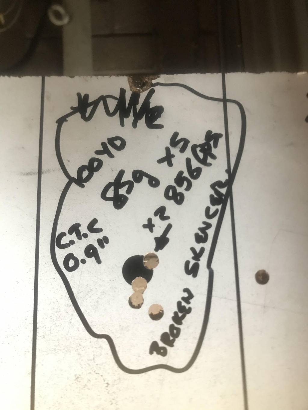

Yesterday afternoon I managed to get some range time in perfect conditions, I started with 70 gr, 75 gr 80 gr , I had picked up 25 off 82.5 gr and then I shot my best air rifle grouping at 100 yards with 85 gr HP/RBT.

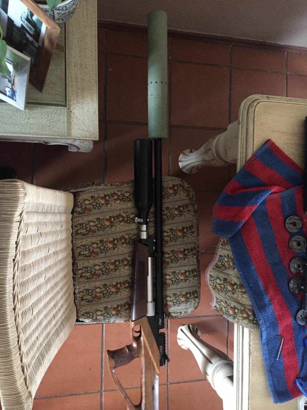

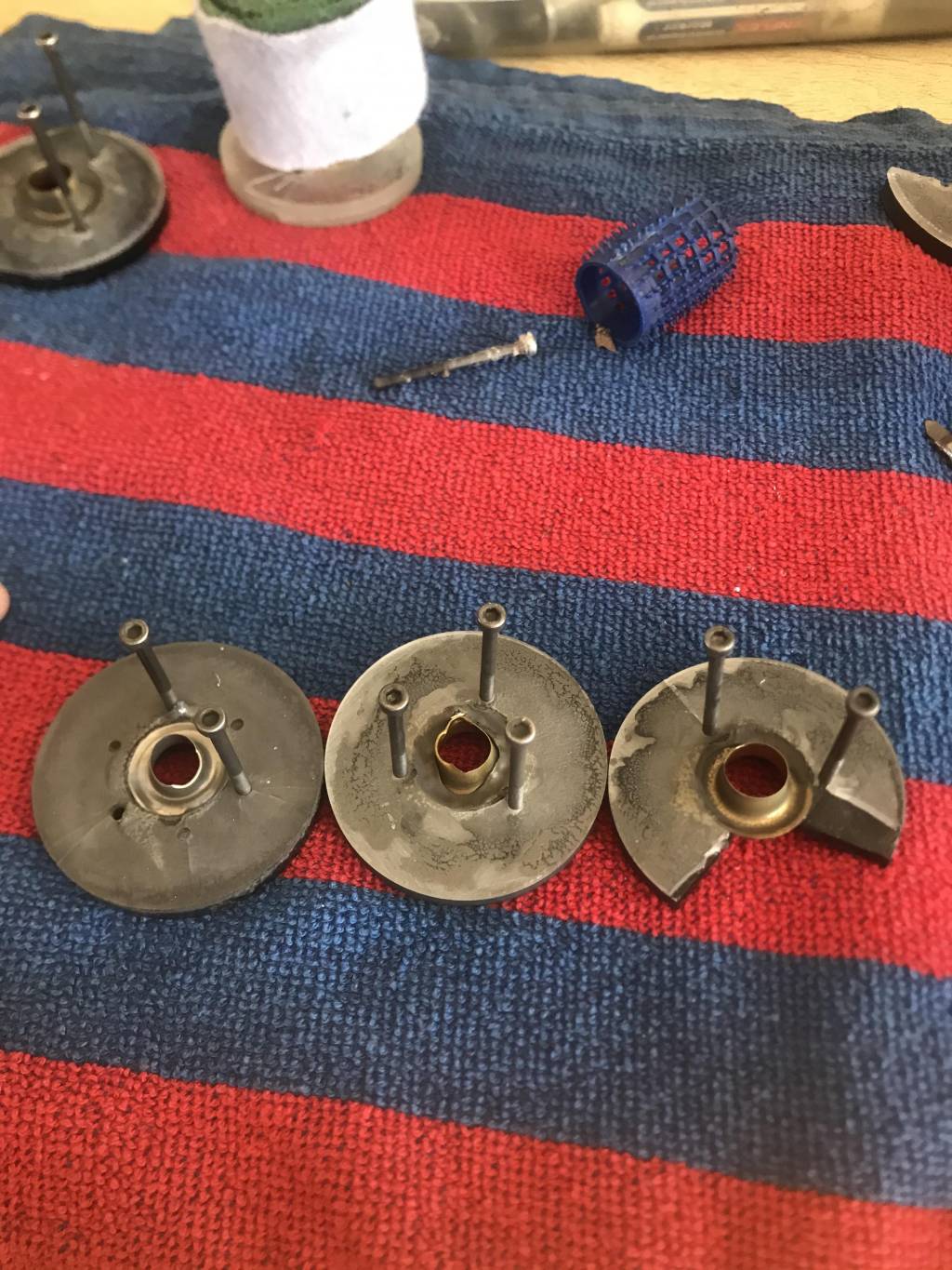

After shooting this grouping, I adjusted the hammer spring to carry on testing the other weight slugs at different velocities. Unknown to me at the time, I had loosened my home made silencer and destroyed 3 of the 5 baffles.
Even with a very damaged silencer the 85 gr RBT still produced acceptable groupings.
I have managed to repair my broken silencer and have been waiting 4 weeks for the rain to stop.

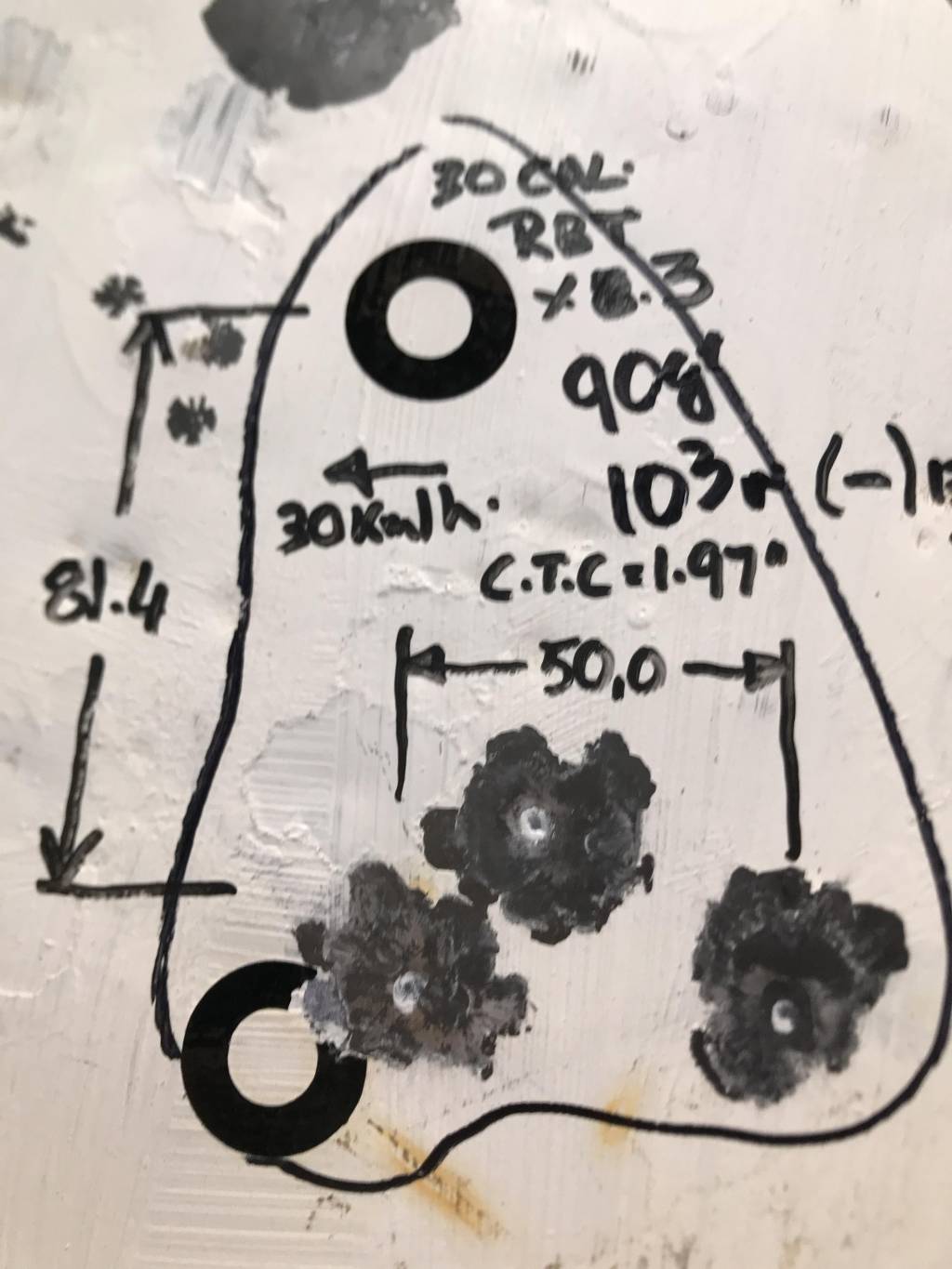

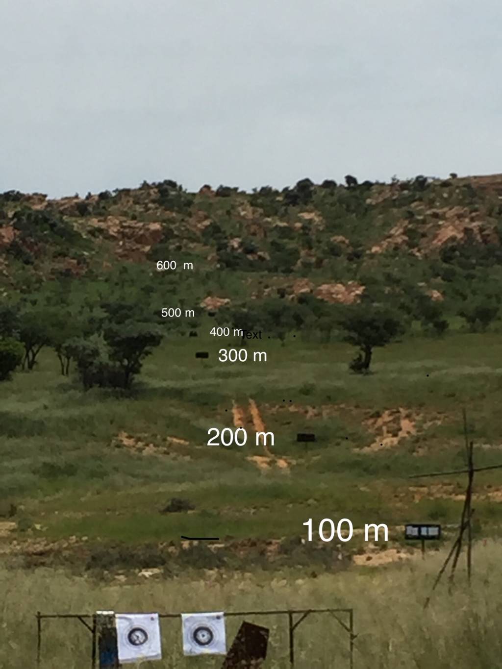

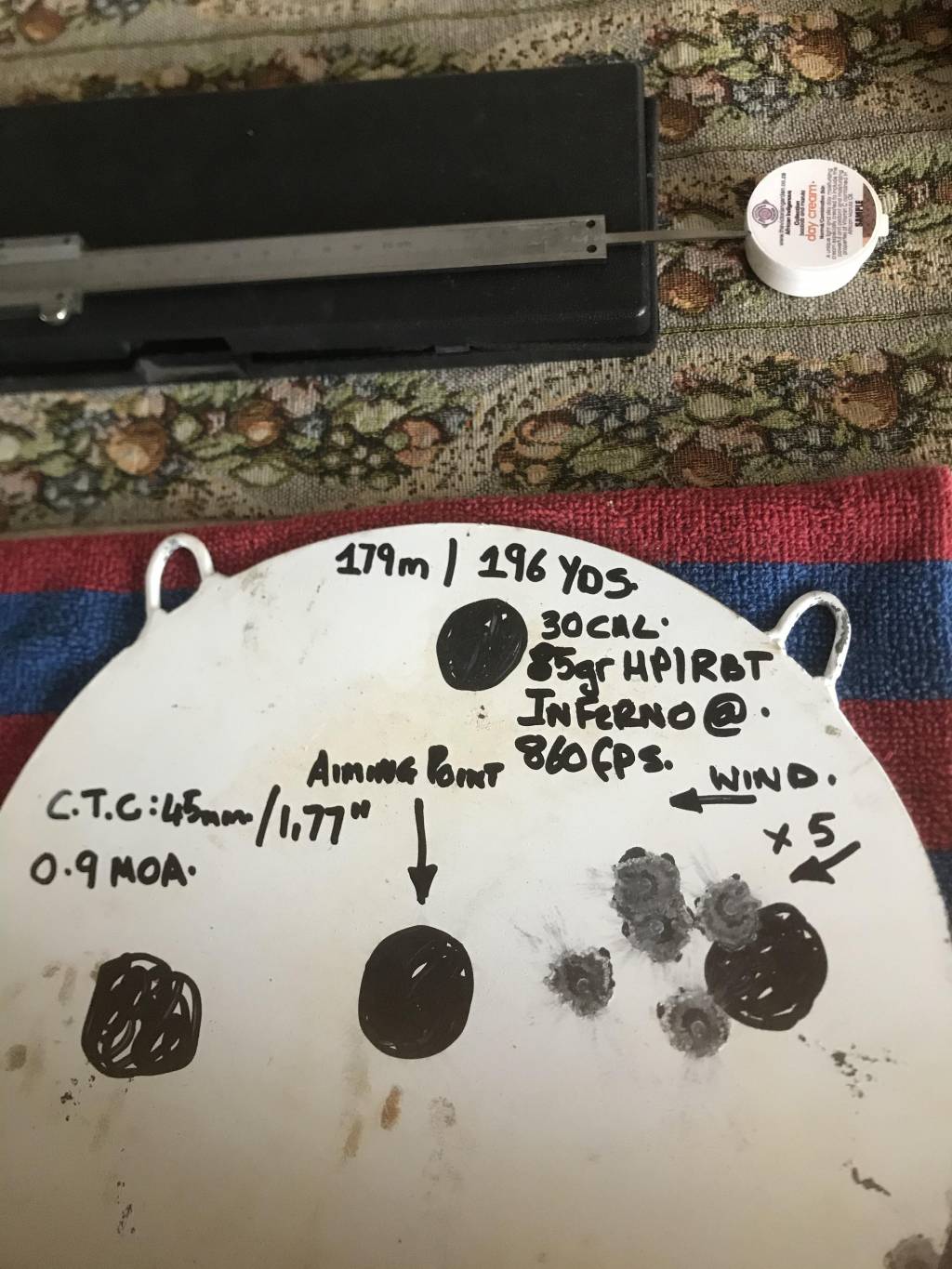

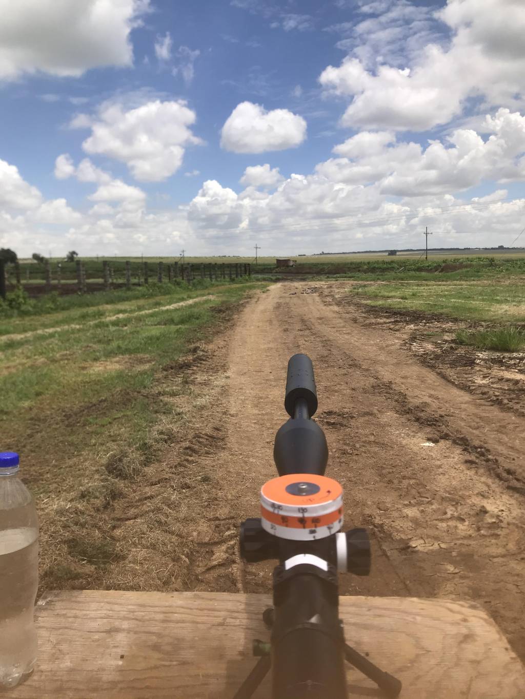

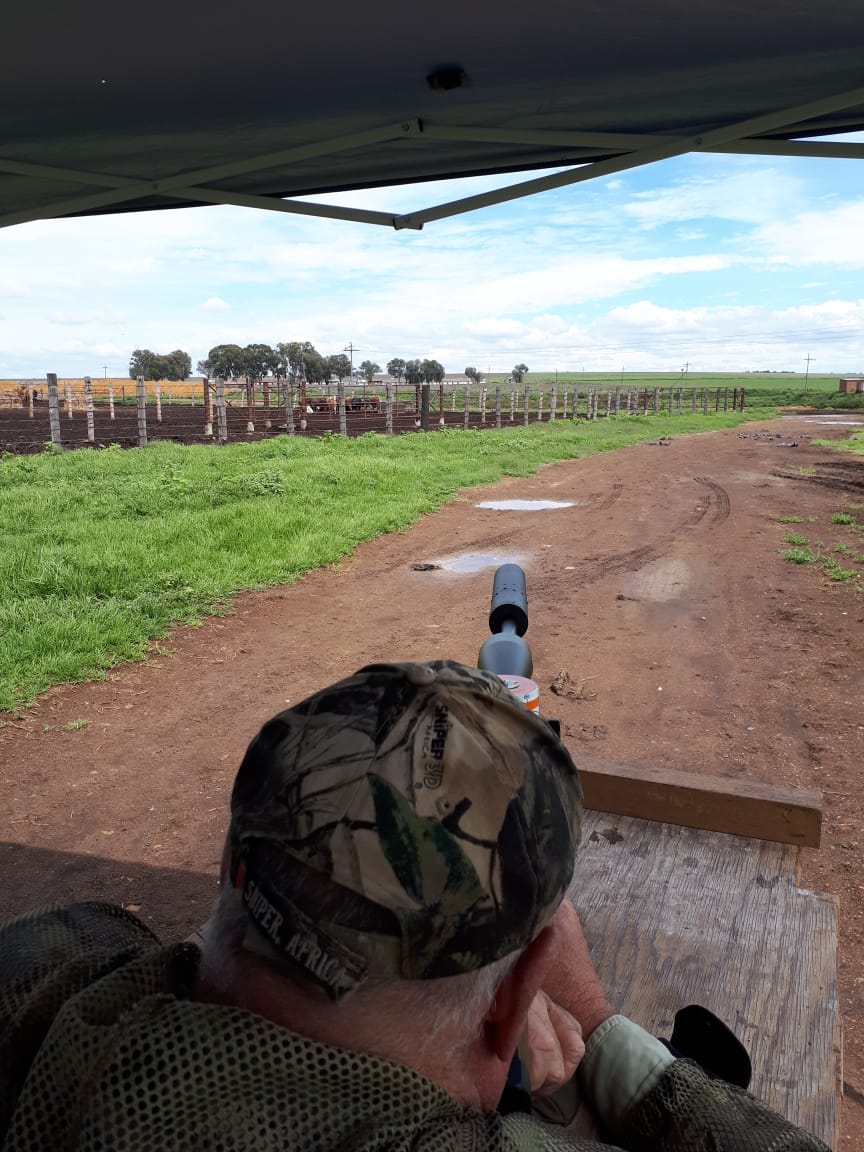

Went pigeon shooting at the feedlot and when the pigeons stopped coming in, I placed my gong out at 179 m.
Before I show you the grouping, the wind always blows at this feedlot.
I am a person who fiddles and tries to make things better, the combination I have of a 30 cal TJ liner and Inferno HP/RBT slugs is great. In closing, when I shot this combination, I feel like a shoot pro.
